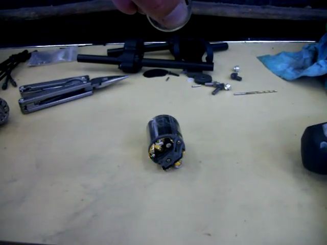

As said above, this car is horrible to drive right now. One of, if not the biggest problem is the motors. I need to send them in to EddieO to see if I messed something up while turning the can down, I think there is something wrong with them as there is a serious lack of power. Even if I put them together wrong, I am regretting lathing the cans for this car. Drag brake went down as expected and I cannot control the car as startup on the motors is fast and strong. I tried to adjust my ESC throttle curve but then that just messed me up in a whole different direction.
EddieO to the rescue! He sent me some new crazy proto magnets that should really help with torque and drag brake. He also sent me a bunch of arms to test to see if I can get these motors back on track. Thanks Brood!
Eddie told me these magnets were strong. Usually when people start ranting about how strong or cool their products are I just turn my hearing on to Charlie Brown mode.... "wah, wah wah, wah wah wah wah..." Eddie was not joking about these magnets! I tried to put one of the arms in and I could not get the shims to stay on the pinion side! The magnets would just keep pulling it off and if I did not line the arm up just right, it was hard to pull it back up and get it aligned. At first I tried to pull the end bell off and I thought I was going to break it. I had to pull the end bell off and then grab the timing ring. The timing ring was pulled against the magnets so hard that I thought the end bell was stuck on!
I dont know if you can tell how far away the motors are in this vid but they are a decent distance. Crazy! I cant wait to test these!

It does not roll down the fridge but it slides. I think my fridge has too much coating on it. If I stick it to my toaster oven I can stick it sideways no problem.
Maybe this counts too?
Oh, they will pass every other test pretty much too.....well except the lightweight test. Startup isn't as good as other motors though its still pretty good, but drag brake, torque, and stall ability is nuts.....by 2.2p with Tekin FXRs can sit basically straight down on a rock and will not roll.....it will slide down the hill before it rolls. It's a pig too, at nearly 6 lbs.
