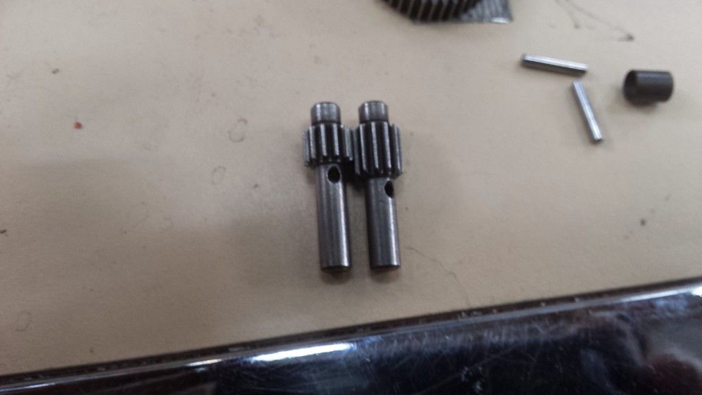

Yeah, the MT 3rd is a good bit longer than the Berg 3rd. It also has longer teeth as the MT gears are 6mm wide vs Berg at 3mm wide. Thats my biggest issue is that if you want to run a Berg small 3rd, you have to run a Berg 4th and locker. At that point, you probably need new shafts now too. Domino effect.
Picture of the MT small 3rd. The correct one is on the left. Factory mistake on the right.

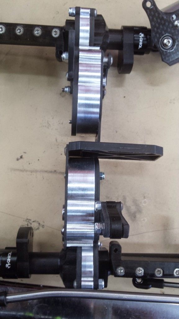

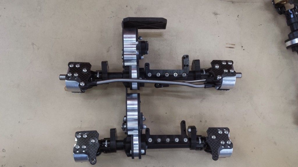

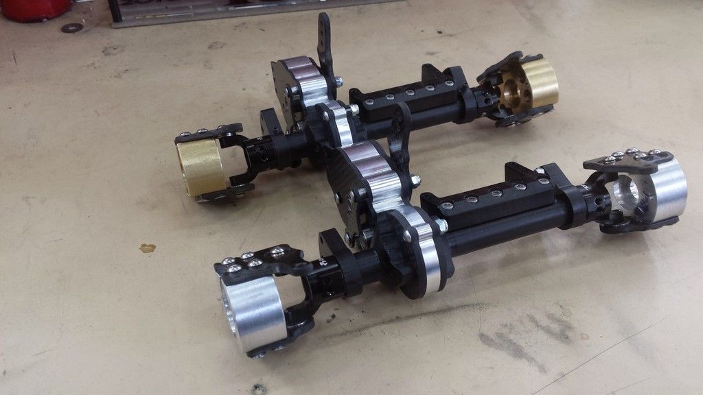

The front of a Super Lite axle runs narrower than a standard Berg does. The secret is in the tubes and in the locker. The locker is narrowed and then the actual axle tube houses the bearing so there is minimal width wasted. Compare the below locker to a stock locker and you will know what I mean. I gained about 1/4" overall width from this.
Its not terribly narrower than its "big brother" but, I reduced the tubes approx 3/4" overall. I hope to reduce the width even more via the hubs/knuckles as I would really like to be as close to 0 offset, 0 scrub as possible. Clearances will ultimately put me where I have to be. Just from hubs, I could be approx another 3/4" narrower than the 2.2 for a total of 1.5" narrower. I dont know if that will happen though.
A keen eye will see that I made the cases narrower than my standard Super Lites. For the thicker section, it is 3mm narrower and the front is approx 1mm narrower. This gained me quite a bit of room on the non motor side to get the link and shock around it.

Oh dear... those axles... so awesome! :)
Could it be worth trying to make the link mounts go over the chub a bit to be able to narrowing the axles a little bit extra? Or make some new chubs with built in link mounts? You should be able to save 3 mm or so per side I think.
