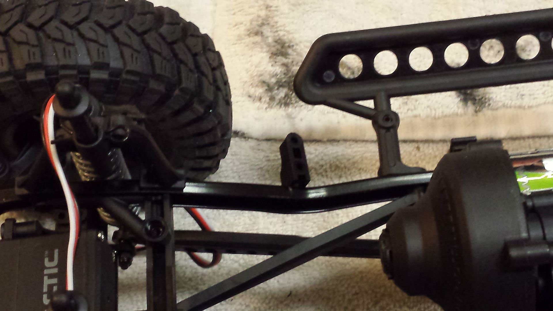

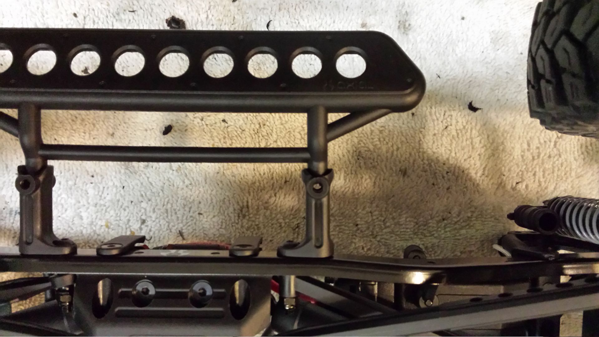

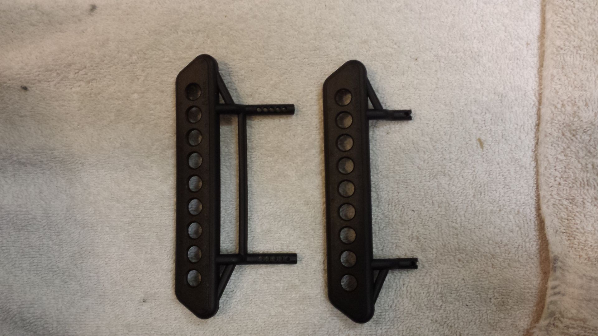

Didn't get out to run Dudley this weekend with all the Axialfest preparations. I did however find a little time to trim up some of the stock parts. Nothing new to many of you but here is the work on the rock sliders
Pic of the stock slider next to the trimmed one
Here you can see how much they have been pulled in, along with the small notches I put in the mounts to pull the sliders in just a bit more.
If you want those sliders in even more you can cut them like this. ;-)
Just grab a drill bit that slides through the hole in the mounts. Press the slider in as far as you can get it and drill right through the nubbin!
Here they are on my son's SCX10 with AX-10 Deadbolt body. The body tucks nicely into the inside edge of the outside tube. On my truck (80 Chevy) they're completely inside of the body and hidden.

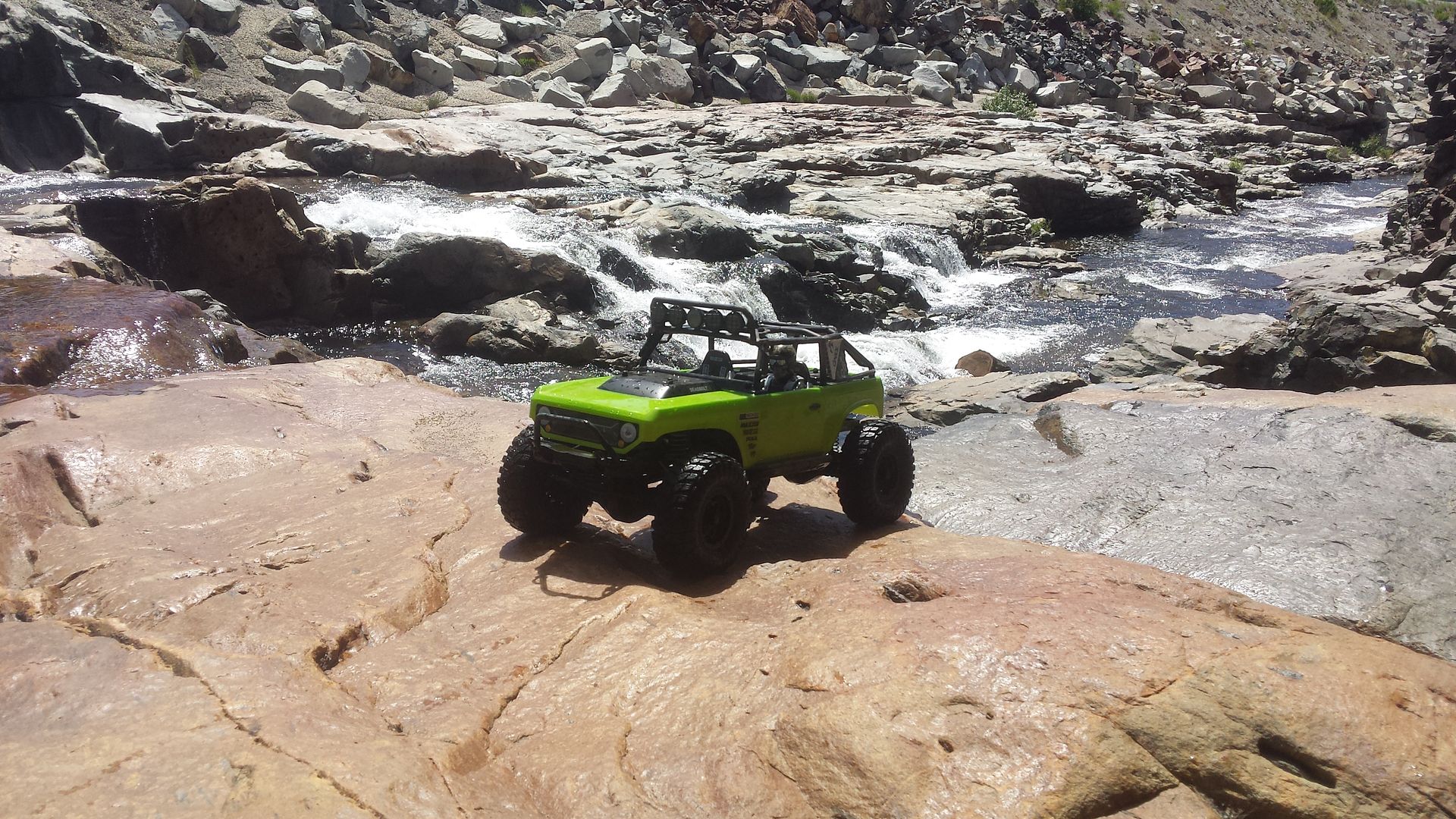

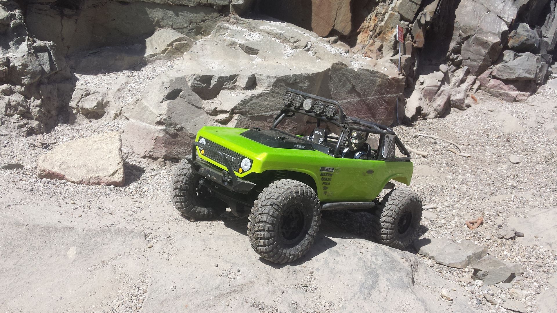

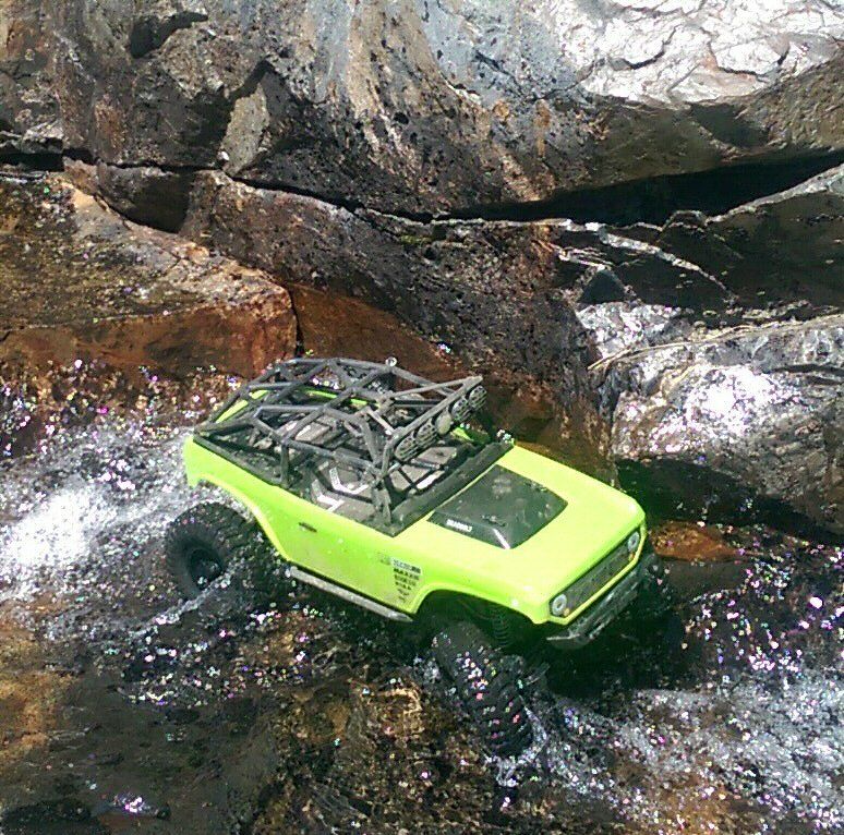

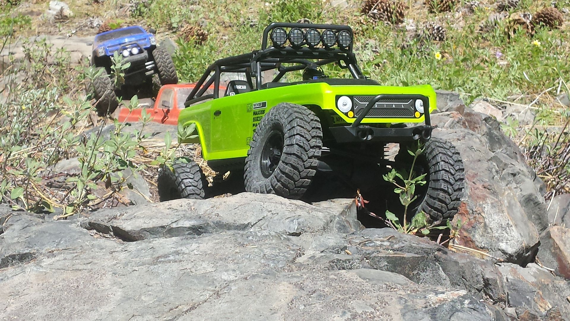

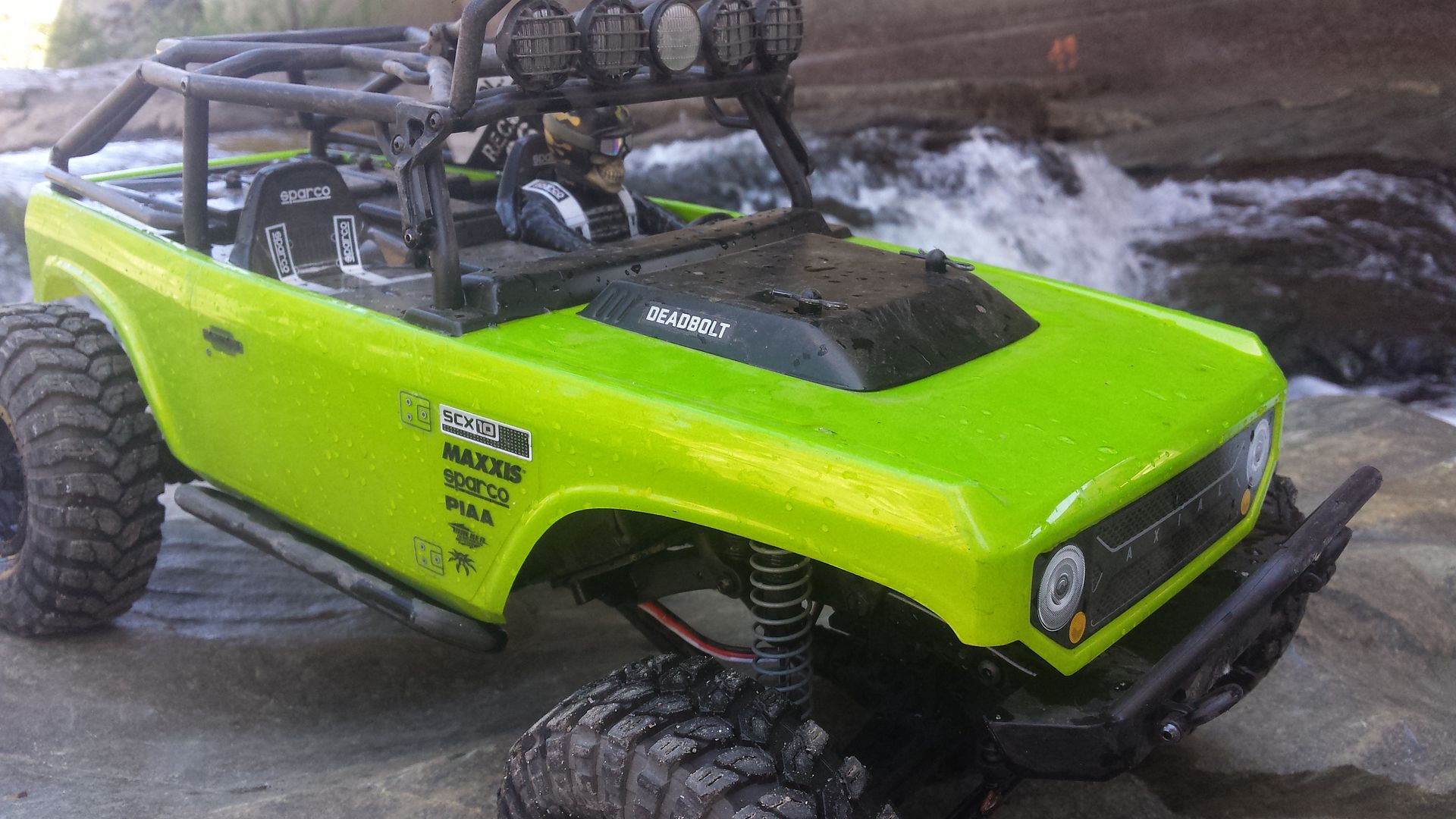

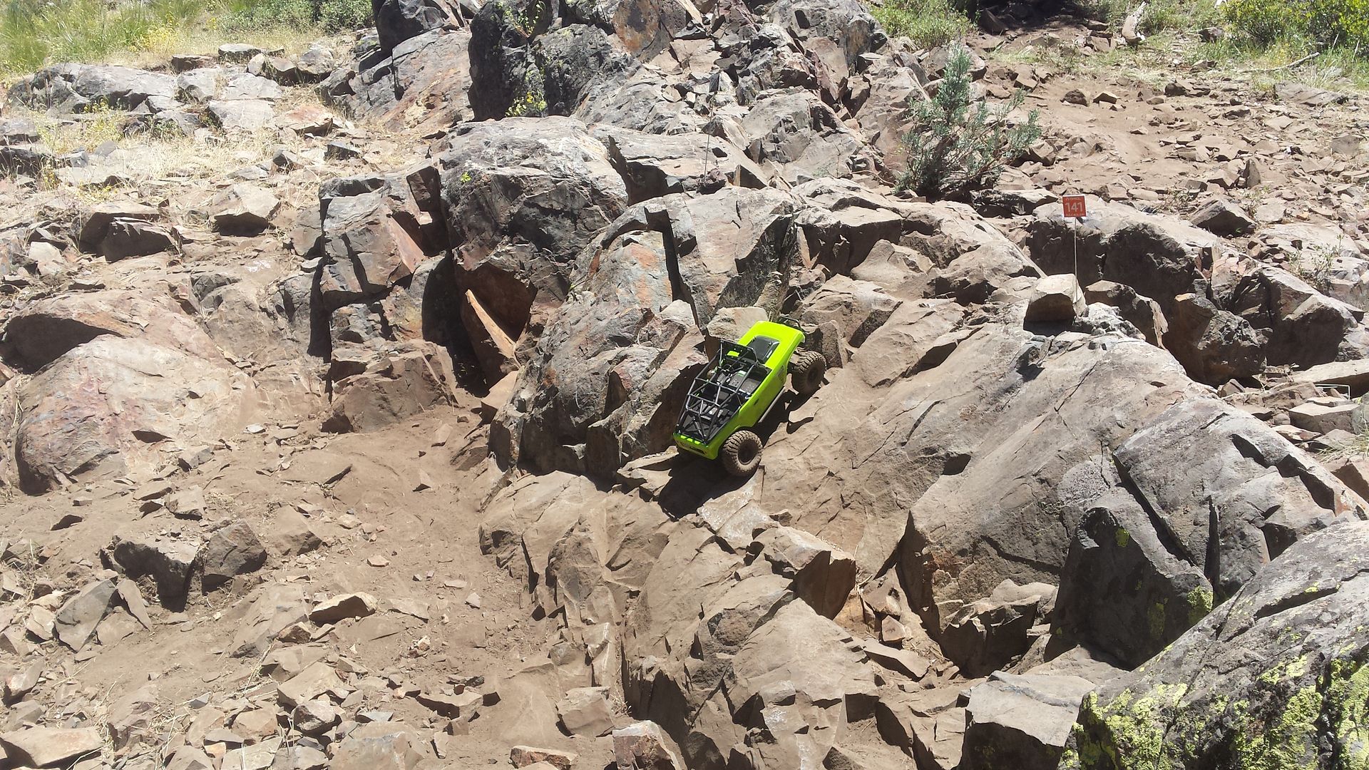

A couple pics from Dudleys maiden run
(some pics are from a distance to give you an idea of the terrain)

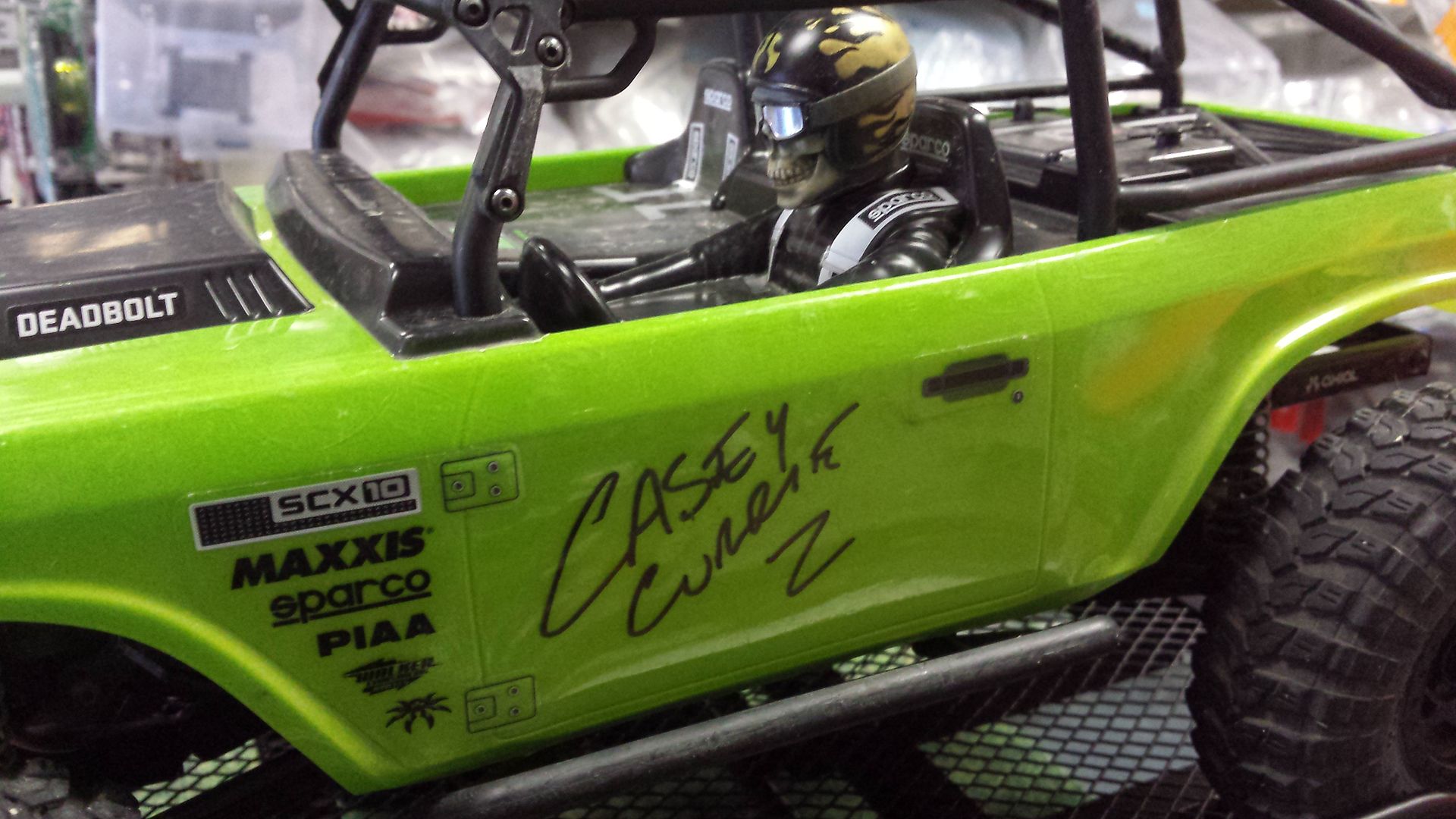

You might have noticed in some of the pics that I switched out the stock "Race" helmet for the open face Skull helmet. I wanted to go above what you typically would see, witch is usually just left white with a decal thrown on. So I hit up Dirty Mike to get a little more realistic and detailed paint job on Dudley. The Skull head has some real good detail so Mike was able to pull off a real nice paint job. So far this is way above any Deadbolt helmet I've seen.

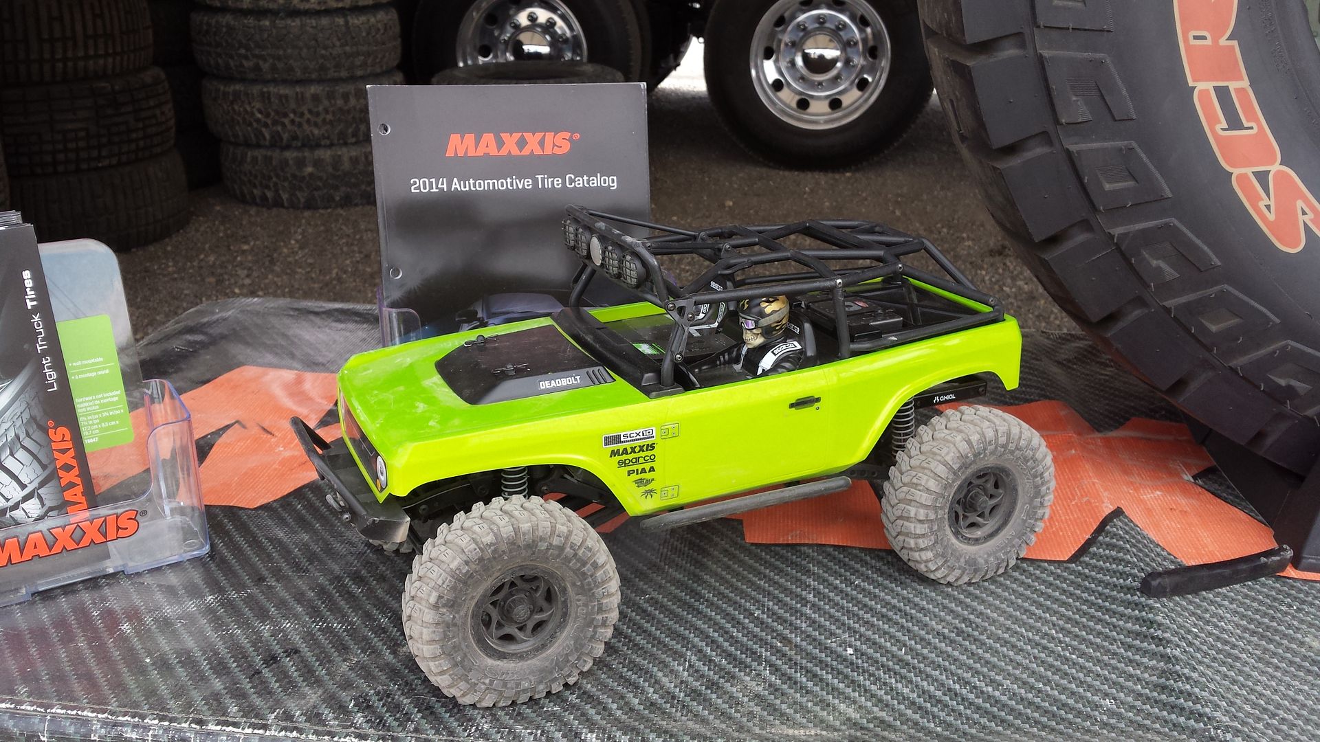

The Lucas Oil Short Course races were in town over the weekend 8)
I took Dudley out with me to cruse around in the pits to help promote the hobby shop and Axial along with playing around on the man made rock crawling course. Dudley logged just over 3 miles of distance. Most of which was very easy mileage on asphalt or gravel, but mileage none the less.
While there, Dudley spent time in the Maxxis booth promoting Maxxis tires and Axial Racing "thumbsup". People were really surprised that you could buy Maxxis tires for the R/C's.
Also while running through the pits Axial sponsored driver Casey Currie spotted us and called us over to hit pit. He was excited to see the new Deadbolt G6 and very eager to show us his official CRC Jeep that Axial and Vanquish had put together for him.
We finished out the day by hitting the Rock Crawling area to play on the man made course that Miller Motorsports Park has.
Pics from the day

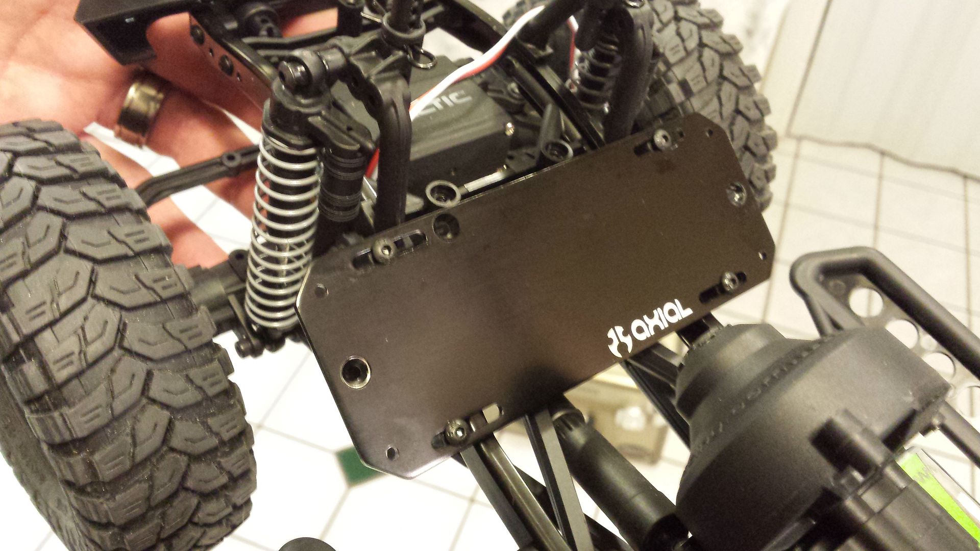

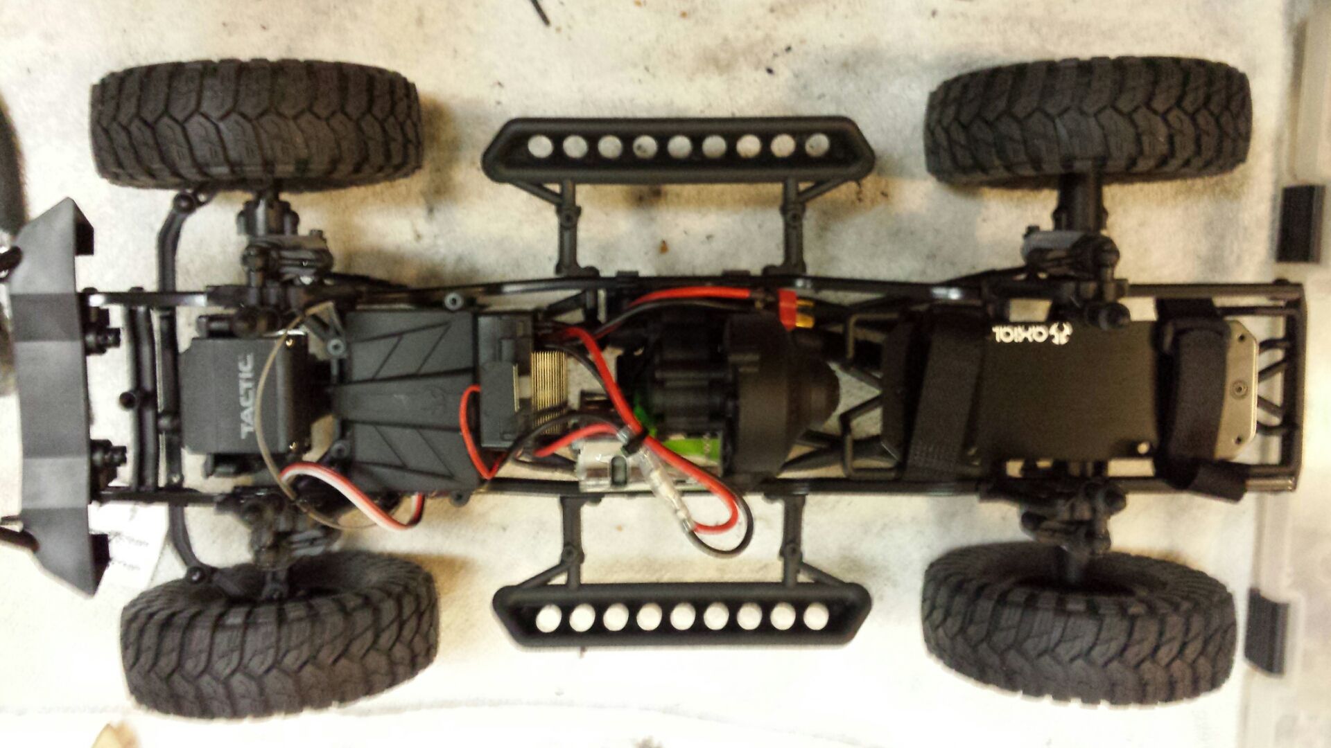

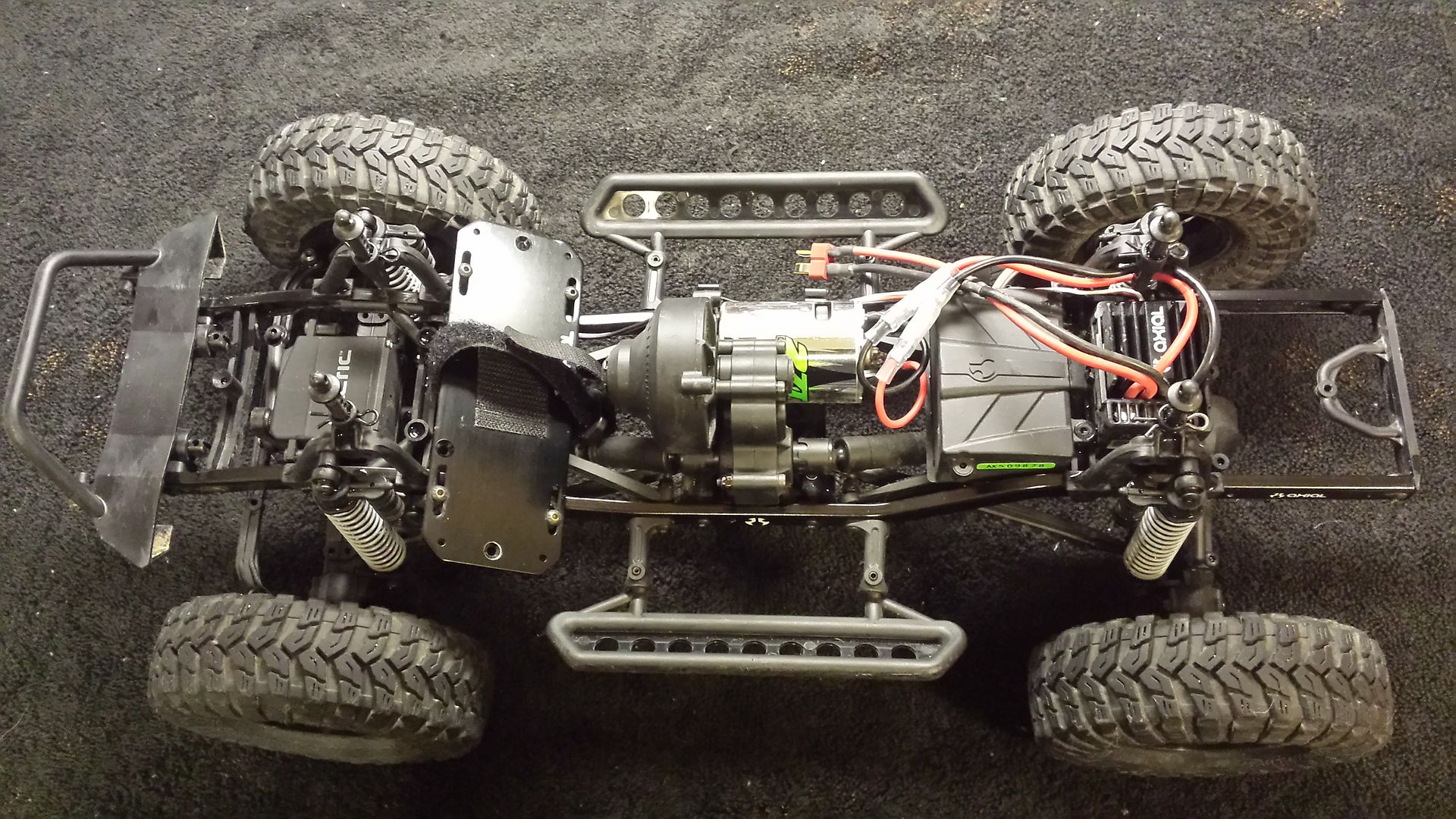

Okay time to squeeze a little performance out of Dudley before the next outing. An easy way to get a little more performance is to relocate the electronics. Lets get to it!!
first up, I prefer the motor to be mounted on the passenger side of the rig to help compensate for a little bit of the torque twist. This will also give us more room for the electronics relocation. I just unbolted the skid plate flipped it around and re-installed. Pretty simple. (you'll need to swap the + and - on the motor so it runs the right direction)
The battery is the heaviest single component in the vehicle so moving it to the front helps keep the front end down on some of the bigger climbs. On one of Rocksurfer's rigs I saw a pretty trick way to get the battery up front, using a few parts that come in the extra parts bag included with the rig.

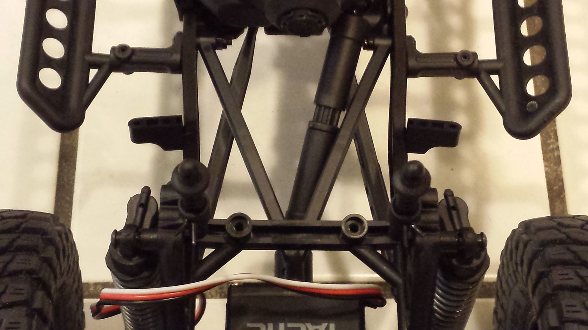

First I had to move the RX box and the ESC to the rear of the vehicle to make room for the battery. There is already mounting holes for the RX box on the rear chassis brace. So a simple bolt in relocation for the box.
The ESC was just as easy. A glob of silicon glue on the bottom and I stuck it right on the rear chassis brace, right behind the newly relocated RX box.

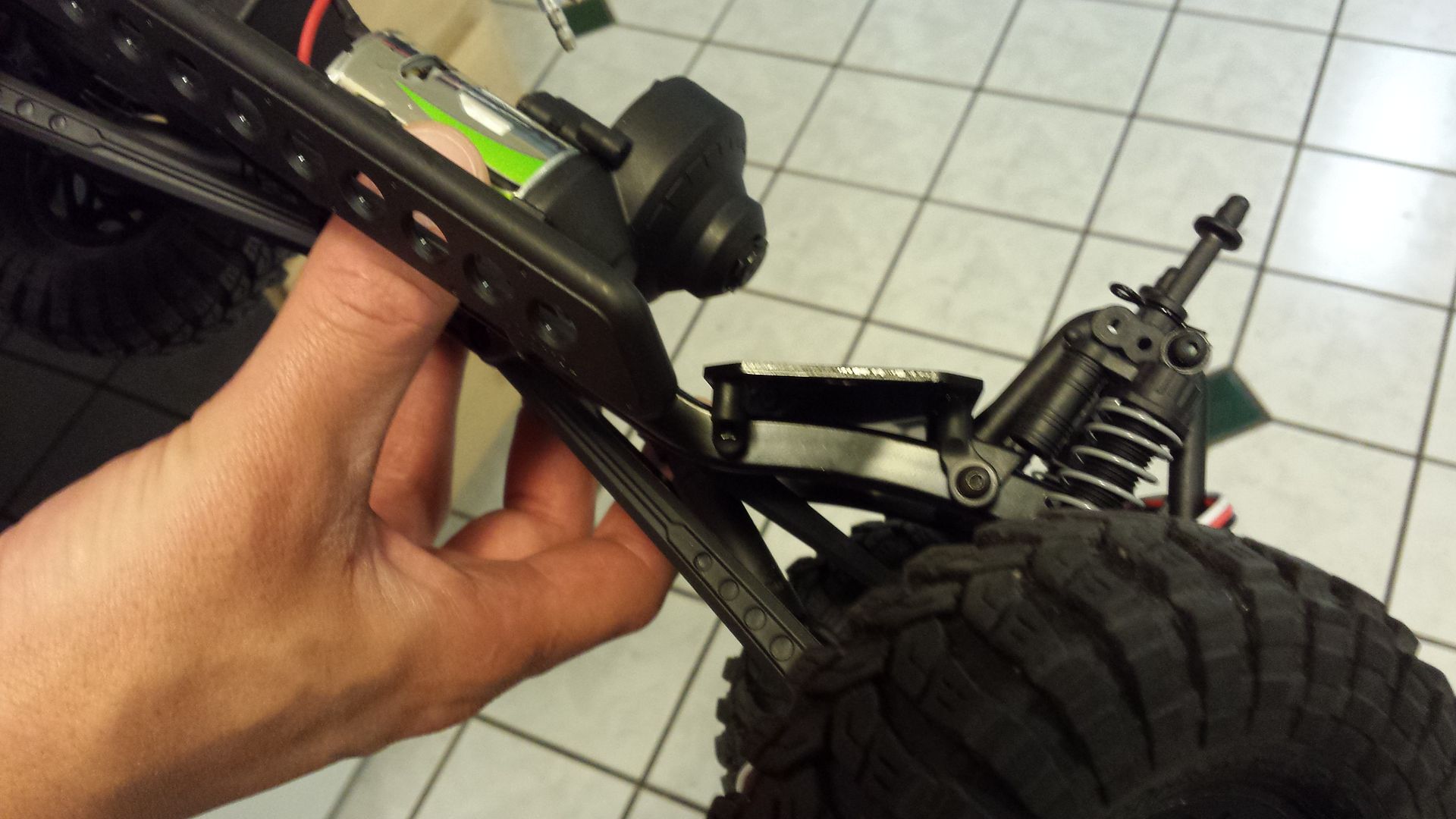

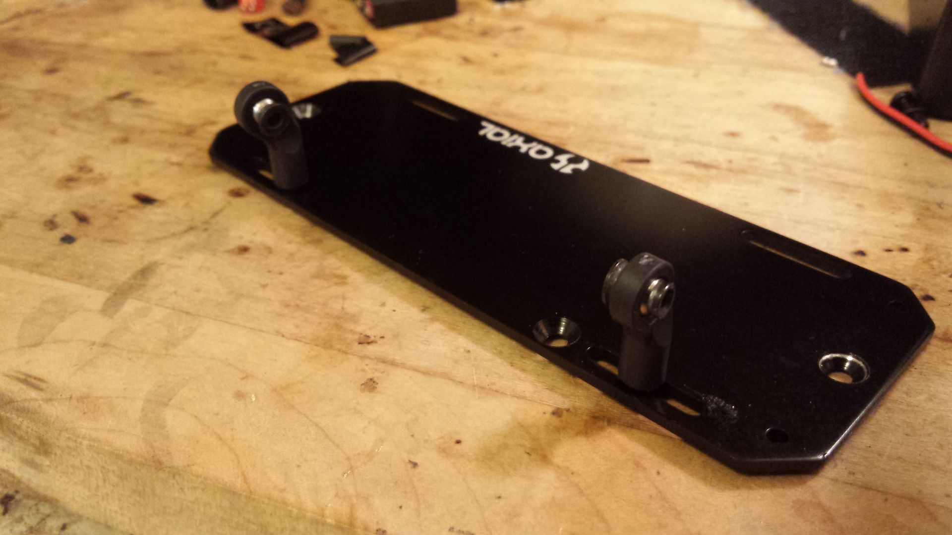

Now that the ESC and RX are out of the way, I had the room to mount the battery where I wanted. First I found the extra servo mounts in the spare parts bag and bolted them up to the chassis where the support legs for the RX box used to go. Next I bolted a couple of the P-shaped rodends onto the battery plate in the slots where the velcro straps used to go. Then place the battery plate across the chassis and line up the holes on the new mounts. The P-shaped rod ends line up with the rear screw on the shock hoops. So with nothing more than a couple screws the electronics relocation is complete.
Before the mods
After the mods
Installed the extra servo mounts on the chassis
Bolting up the P-shaped rod ends onto the battery plate
And a couple completed pics to show you the mounting.
Do you plan on keeping that body now that Casey signed it? I would be worried about rubbing the signature off if it bounced it against a rock.
