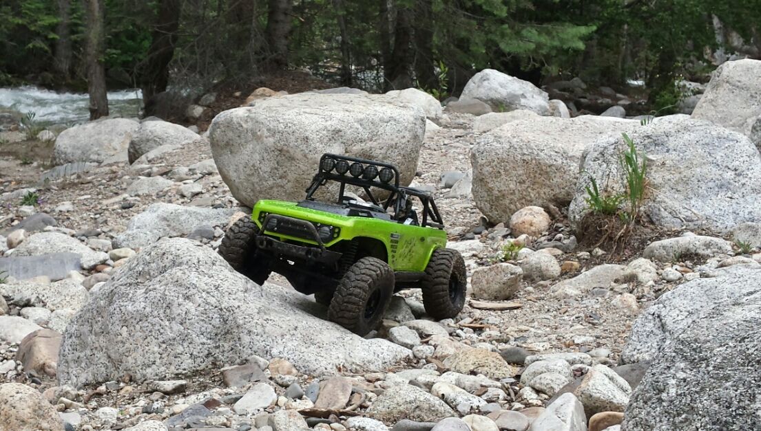

Dudley made it out for another "Trail" run, this time with some friends.
The trail, "Little Cottonwood Trail" Its a nice trail that is very well traveled. This trail has many small trails that loop off of it or branch off to the river that runs next to it. These loops and off shoots is where you'll find the best terrain to play on for your R/C's.
On this outing Dudley covered 1.2 miles round trip (.6 up and another .6 on the return). He ran pretty good, but on one or two of the hard lines the lower links were flexing pretty good again, making it hard to get the right tire placement needed. Just as we turned around a screw backed out of the steering, a quick fix with nothing more than a 2mm allen wrench. Also on the way back down the 3-link popped off again. I popped it back on and continued on. Both the 3-link and flexy lowers will be addressed with some alum links in the near future. For now we're going to milk them for all their worth.

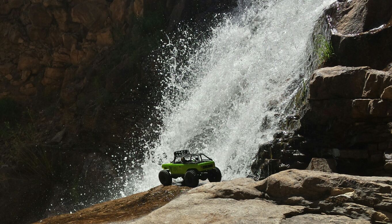

And some by the waterfall (there are some great lines right next to the waterfall)

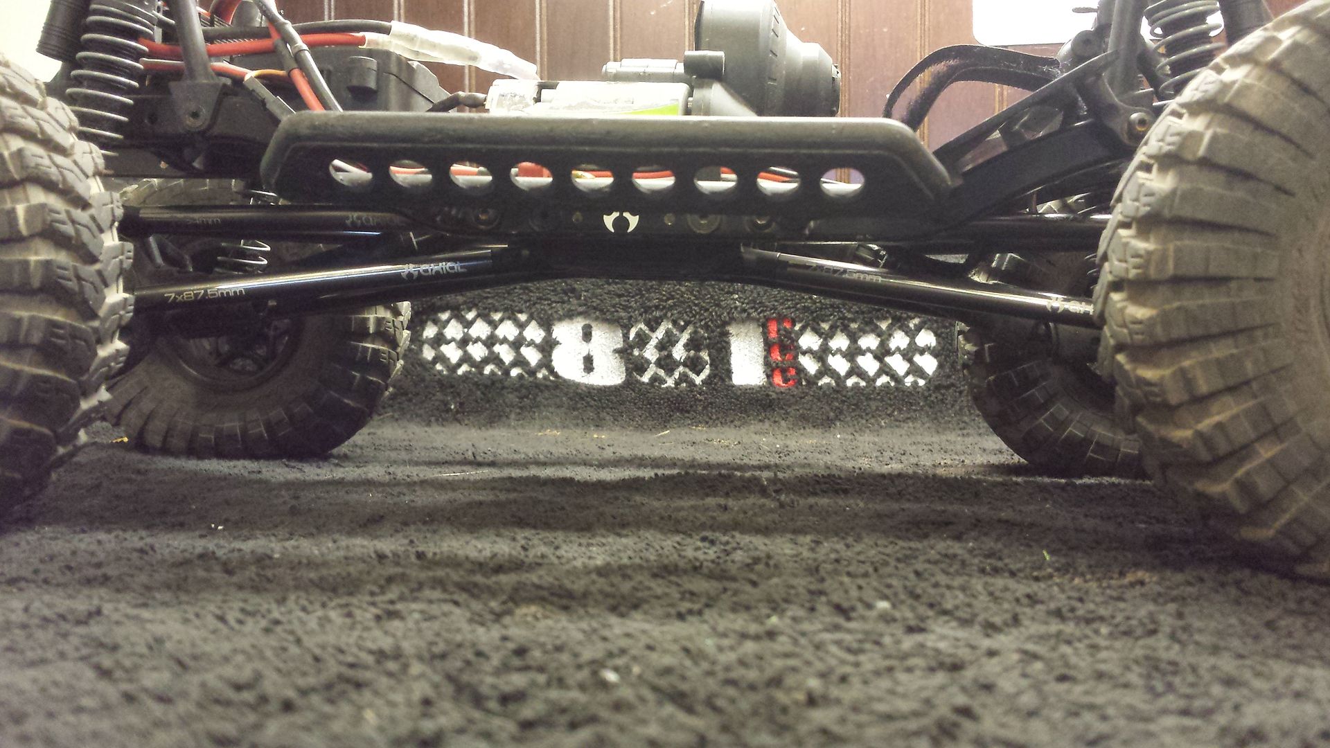

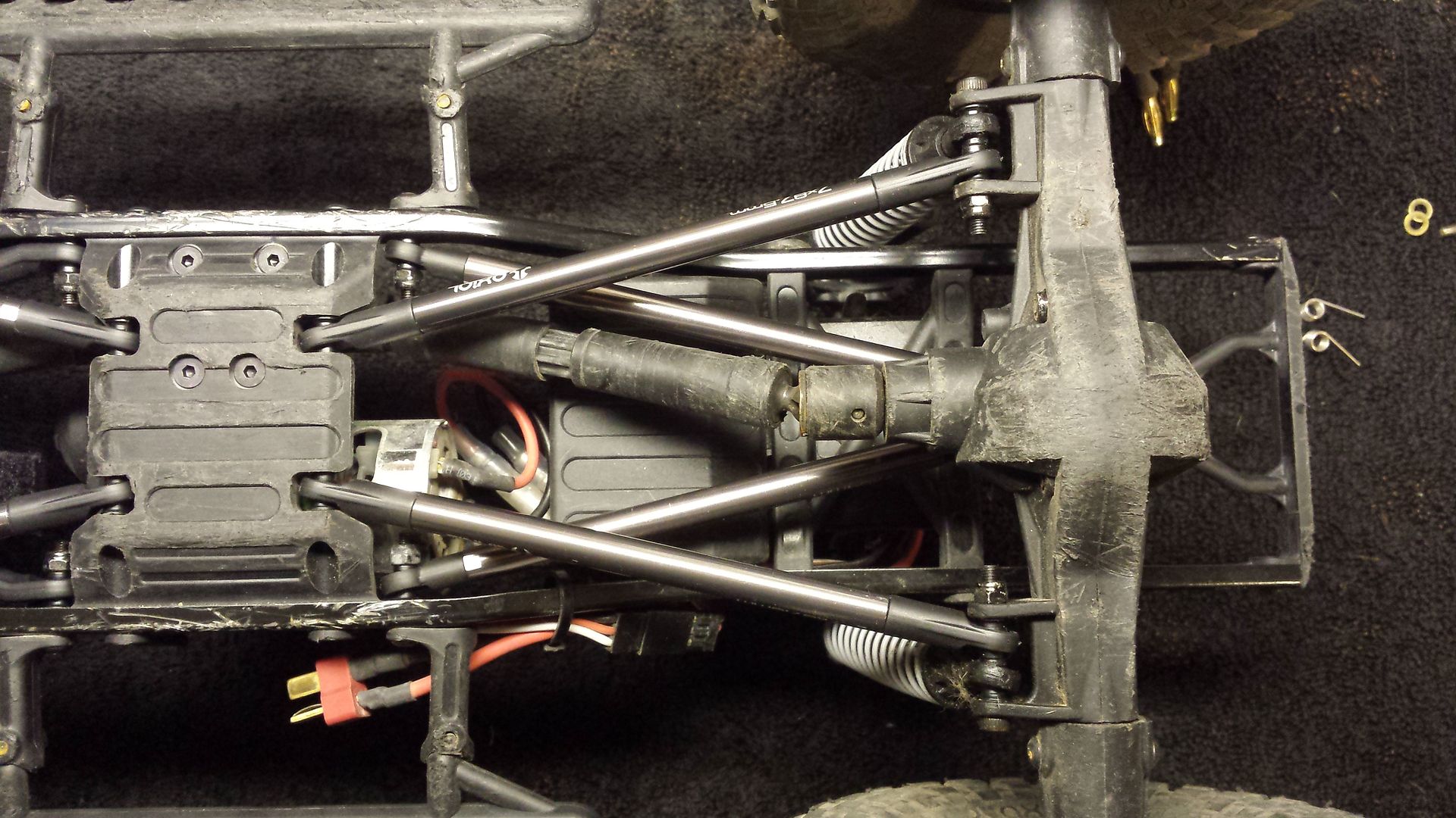

As I stated in my last post Dudley is in need of his some repair. The stock lower links are very flexy and the 3 link on the front is popping off regularly. Alum links here we come!!
This will only be the second "Wrench Session" Dudley has seen (first was the electronics relocation) The simple fix is to grab the alum link kit that Axial offers (ax31142). It covers every link on the rig including the steering. This is what I would recommend to anyone looking to upgrade.
I however have owned many Axial rigs over the years and have a bunch of aluminum links kicking around. I dug through all my links and played around with different rod ends and after a bit I had a full link kit. I ended up using some 87.5 links with the larger Axial rodends (ax80057) for the lowers, and 94mm links with the short rodends (ax80005) for the uppers. Looks to be about 1mm longer than the stocks links but they bolted up great.
Once again unless you have a ton of links just laying around I'd recommend the Axial kit (ax31142)
A few pics of the links.

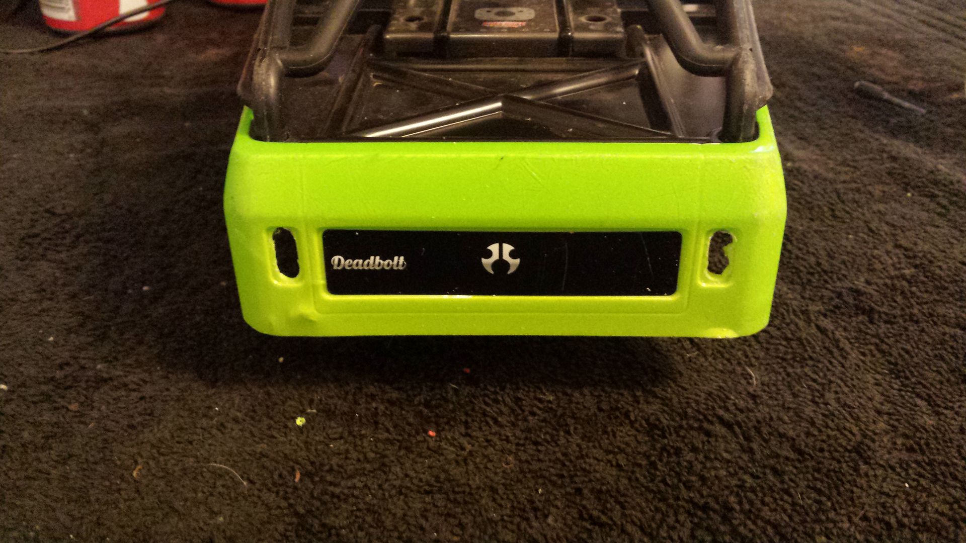

The front bumper already has spots for lights along with the light bar on top. The new grill I picked up from PinchFlat has light buckets too. For now I was able to get some rear light buckets installed into the body. I plan to add more this weekend 8)
Rear light bucket were pretty easy. Axial's has some small oval light buckets in there light bucket kit (ax80045) that are prefect size for the Deadbolt body. I just cut out the area where the rear light stickers are test fitting along the way. Once the holes were finished I just bolted in the Axial buckets.
Turned out pretty good IMO. Next I need to decide if I want to use the stock light bar on top or find something lower profile, and of course install the LED's.
