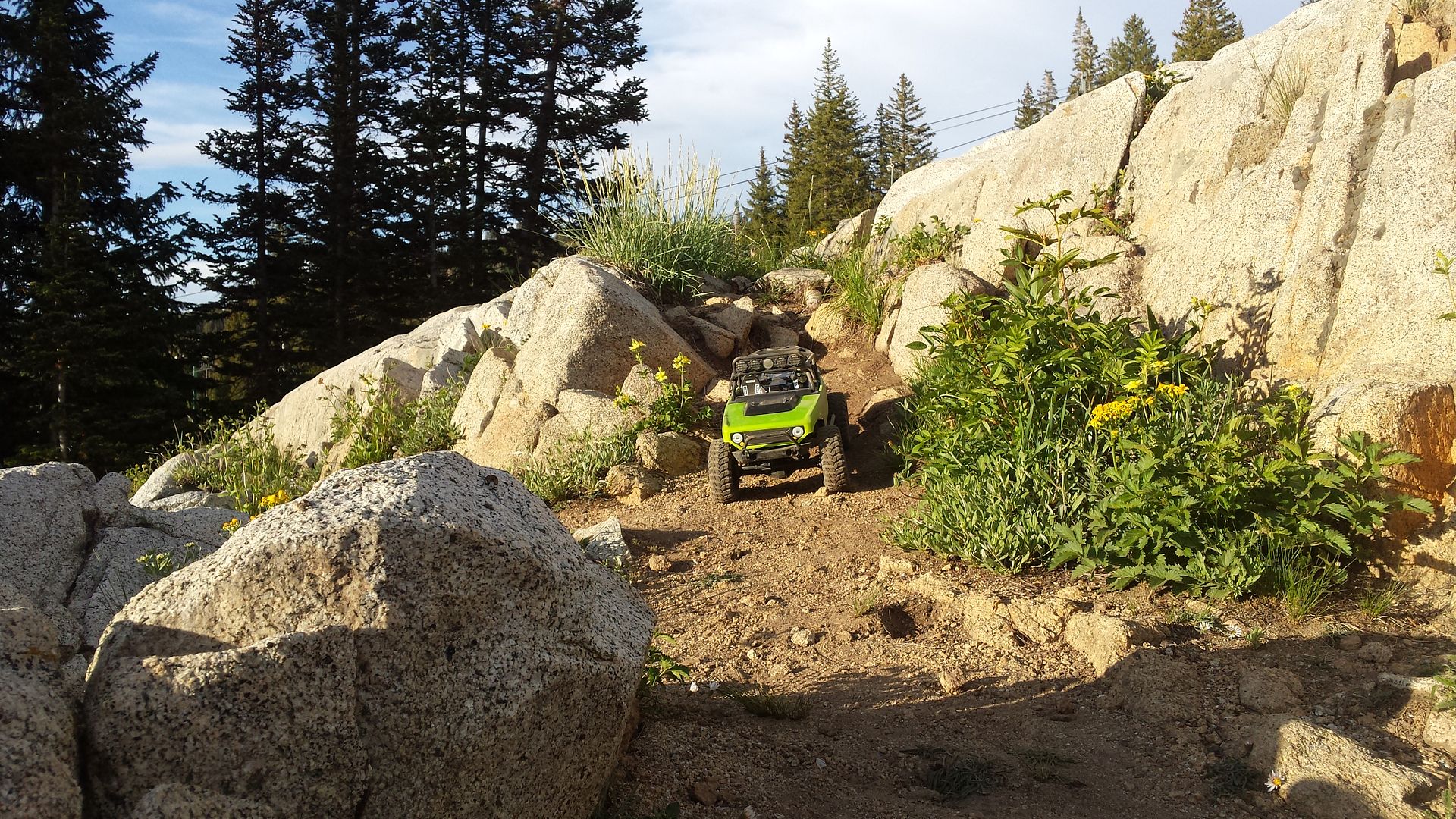

Finally got Dudley out on an actual trail this week "thumbsup"
Lake Marry is a small lake at the top of one of the local canyons here on the Wasatch front (Salt Lake City)
The trail is 1 mile in, so 2 miles round trip.
The trail goes on to a couple other lakes a few more miles in. But do to this being an evening run we didn't have time to run up to the other lakes (maybe in the near future, on a day trip).
The trail starts out pretty mild other than the gradual up hill. About half way up is when the fun starts and the trail gets better and better as you get closer to the lake. Once near the lake you could fun crawl almost endlessly. If it wasn't for the hike this would actually be a great place to hold an Event or kill a full day fun crawling. Once at lake Marry it's nice to stop for a break and soak in some Mother Nature. "thumbsup"
A couple pics from the outing

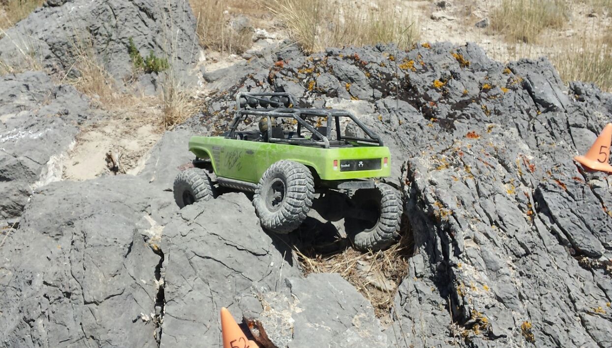

Took Dudley out to the 801rcc event over the weekend. The course was just shy of a mile long but with some playing around Dudley easily cracked the 1 mile mark.
The course was very difficult and Dudley probably saw more abuse in the 1 mile run on course than in all previous runs combined. I am happy to report that Dudley made all but 2 of the lines on course, with no actual breakage. Very impressive considering the course was designed to challenge even the most competitive Wraiths and Ultra4 cars.
This was however the first time the Dudley showed signs of fatigue. During the run the front 3-link popped off. Not a big deal I just simply popped it back on without further incident. It is however very sloppy now and will likely start popping off more and more with each run. The lower links are showing stress too, and becoming very flimsy. On a few of the tough lines the lower links would flex pretty bad making it very hard to pick the right line. The steering link is also starting to flex pretty bad, but it wasn't as irritating as the lower links.
So it may be time to pick up some alum links for Dudley. I just need to decide if I want to piece together a kit (I have some stuff from previous rigs) or just buy the kit Axial offers. I'll keep you guys informed on what I decide to go with.
Anyway here are a couple pics of Dudley making his way through the challenging course.

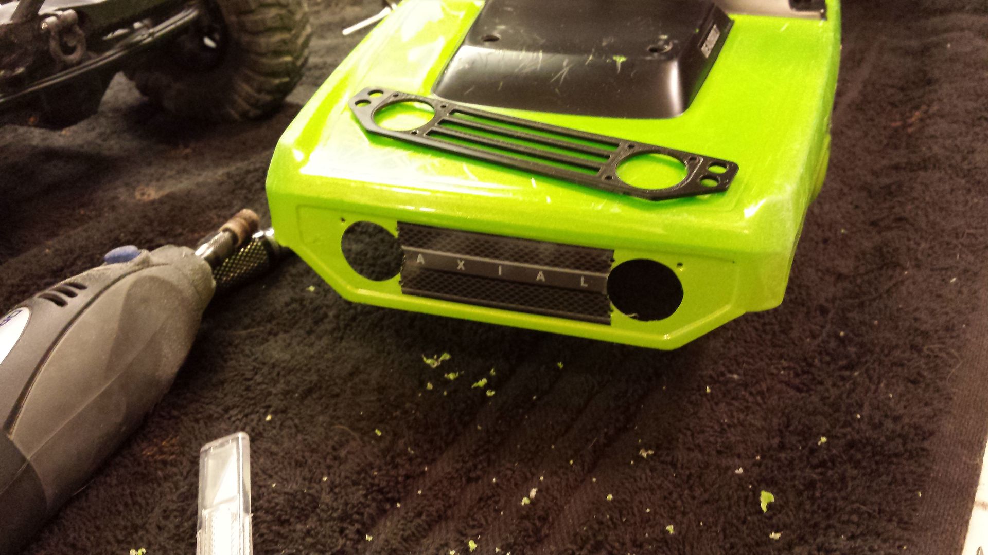

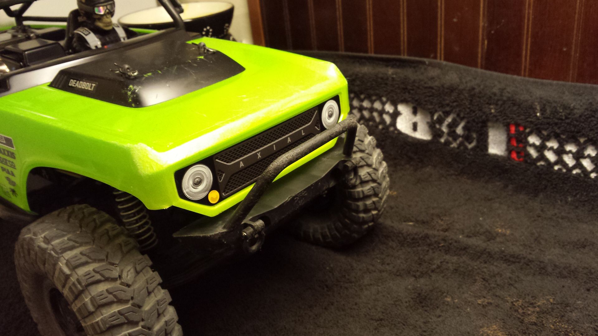

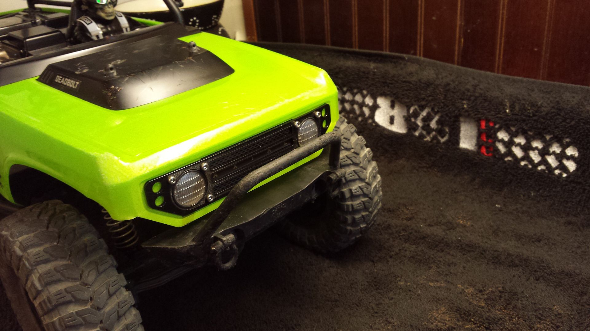

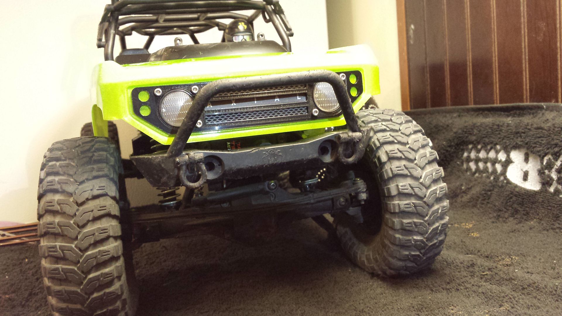

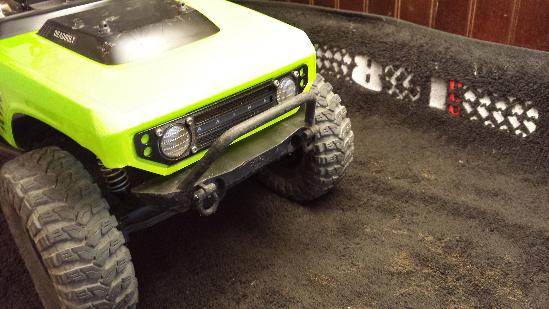

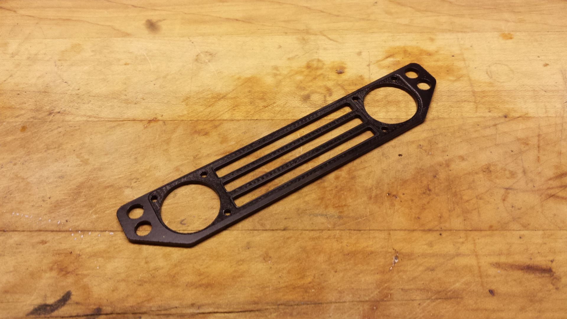

Dudley has been a great rig so far, and I have yet to spend any $$ at all on him. I figured it was time to get him a treat. I notched in PinchFlats thread, he had made a very sweet looking grill for his Deadbolt. After a quick phone call, he agreed to make a stop by my work on his lunch the next day. This grill would be perfect for adding a little detail to Dudley and set him apart from the other RTR deadbolts out there.
The Grill is incredibly cool, with a small etching around the lights and slots in the center to break up the grill and is a very nice detail. The grill has another trick, you can just snap the Axial light buckets right into it.:shock: Then the Axial lens fits into the bucket to finish off the look for the headlight.
The install was easy. I just lined up the grill with the mold in the body and taped it in place. A poke in each of the mounting hols with a punch made a small hole so I could run the screws right into the body. I traced the holes for the light buckets and removed the grill. Dremel in hand and some test fitting along the way, but a short time later the holes were cut out. Remount the grill , snap in the buckets, press in the lenses and we are finished. I Still need to install the two small amber lights next to the headlights but here is how Dudley looks now.
A quick shot of the front sticker for comparison.
