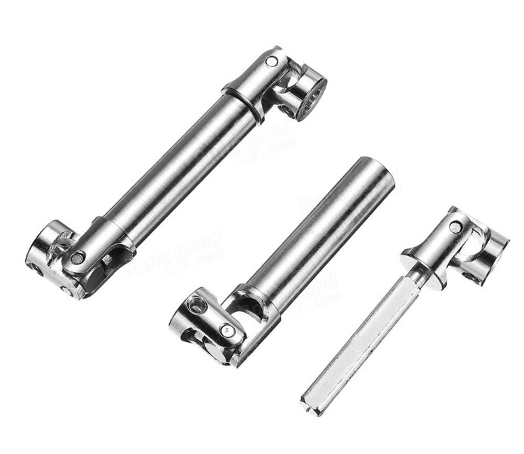

WPL aluminum driveshafts fit it nicely, I just added those to my 1/24 Fat Girl Sand Racer. I originally intended to use them on the WPL C14 but after getting them I realized they are an exact replica of Sumo crawler driveshafts which means they work with most 1/24 micros. They are also super cheap so win win. I just posted a video of the sand racer today on my youtube account if you want to see them at work ;).
Do you mean those of the 1/16 WPL truck?

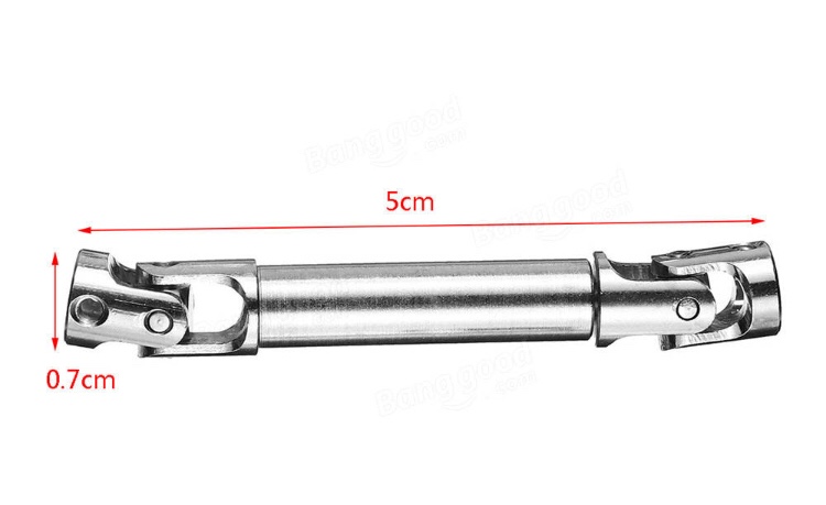

Yep. They seem a little long after measuring what I’ve got but I have 2 sets on the slow boat. Hopefully the female side is slotted all the way.
Thanks for the info.
Looking at the photos, the bore exits into the spider holder, therefore these should be straight forward to shorten manually.

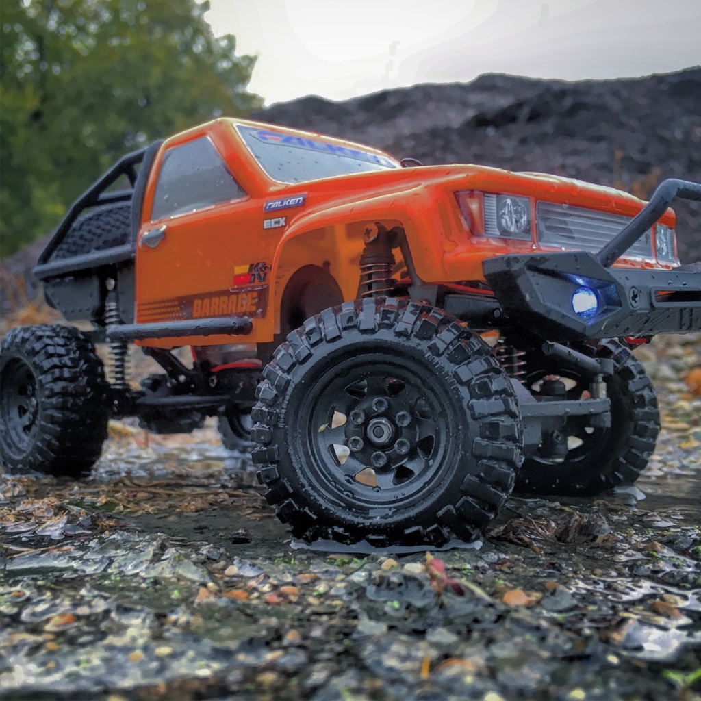

I finally got my 1.0 Super Swamper tires dirty. They wake up the Barrage tremendously. Plus the wider offset Mickey Thompson Classic IIs from Shapeways. The first time a wheel bound up it popped a U joint though.
It made it all the way and could do more if I’d add some more weight to the tires or front of the chassis.

The plastic one. The aluminum driveshafts need to be cut down a little to fit and I just haven’t made the time for that yet.

Not the RGT tires but the RC4WD ones. They finally had a batch come out and I ordered a set.

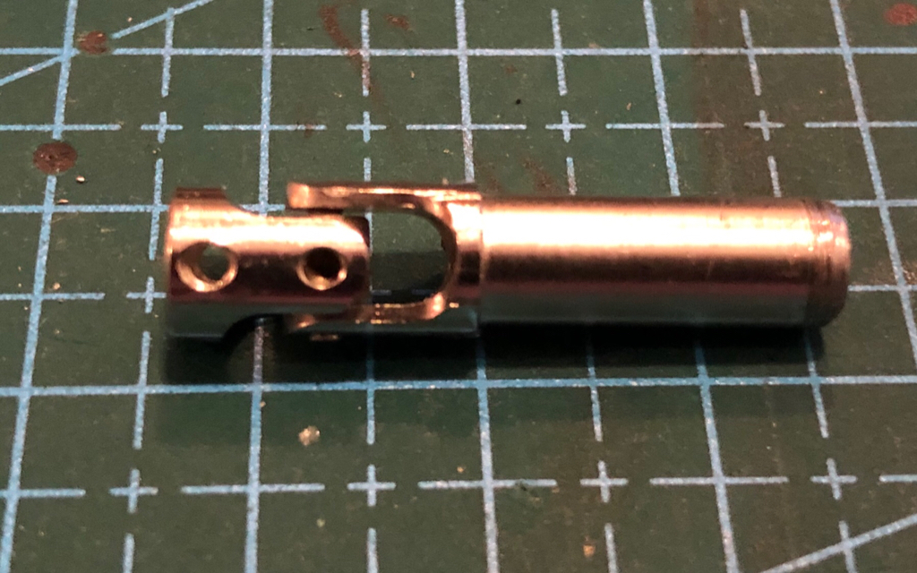

I went and ordered the RGT truck body along with some spare hexes. I don’t know why, but I like the look better than the flatbed for some reason. Can’t wait for it to get here but I also need some new driveshafts. Does anyone have a lead for a solid replacement?
I tried to shorten a set of the WPL aluminum shafts but ended up tearing up a U joint. I chucked the driveshaft and somehow lost one of the pins.
