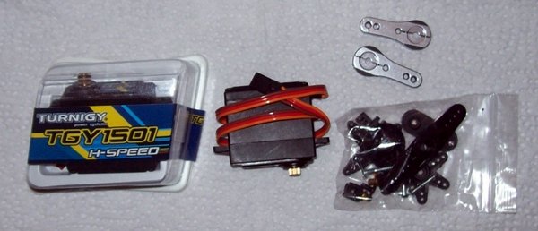

T's servos and arms are in. The fit at the shaft is very nice, takes very little torque to solidly attach.

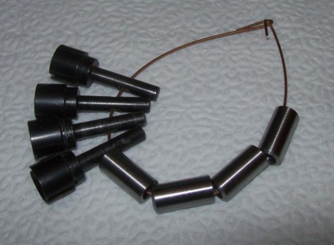

These are the sleeves Don commissioned from me. They are a great idea.
To convert the most possible of the normal bending loads (which snap the stock axle stubs) to tensile (stretching) loads, the fit has to be very precise.
You can see that the brand new stubs had to have the peaks in the stock finish removed (3 were fitted by me) with a fine grit 3M abrasive pad, before they would fit. Also, Don specified 8mm OD, and I supplied an average of 8.02mm. At that dimension, he had to heat the hubs to get a drop in fit. A press fit, or a slight polish first are options, too. I like the thermal fit best, as it keeps the parts tightly together during use and maintenance, but won't require a lot of force to separate them if needed... and cannot alter any dimensions during assembly.
As always, if anyone is interested in these, PM me. I have a growing list of trades I would find interesting.

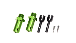

Just a quick comment E, I had disassemble the front hubs for a bearing replacement and they slid of easily. I used a small amount of red and sticky to keep them from sticking. I recommend these to anyone thats change hub length. I don,t know if anyone has looked into this but Ofna racing web site has several different offset for their Hyper 7. A little pricy but if yuo need a special offset they make it. Good luck in Spain with MT.
I checked the stock hubs, and they would be easy to bore, sleeve, and cut to any offset needed. $5.50 for all shown... $11 plus trade will get it done.
Do you have the Ofna part # handy... or can you tell me the different offsets they offer?

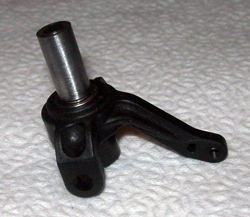

Been prepping for my M/M, and I'm thinking zero scrub on 30 over axles.

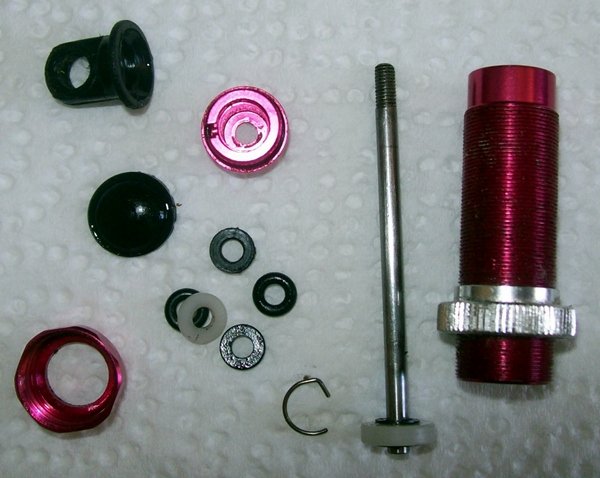

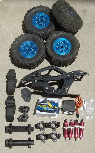

Decided to use the red shocks (10mm bore, 32mm stroke), as they will be easiest to mod for longer top mounts. They show no use internally, I have no idea who made them. Does anyone?
