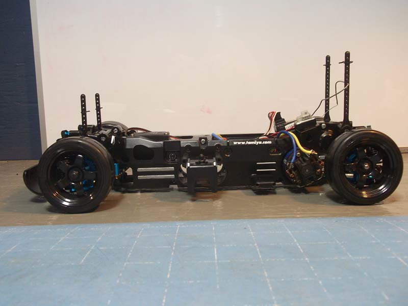

Bolted on some temporary wheels and tires and noted right away that the chassis was sitting way too high. If I were doing a rally setup, this would be perfect. But my other TL is already set up for rally so this will be on-road only. Defintely need to lower the ride height.
Found a pair of Super Mini CVA's in my stash that just needed a few bits to be complete. Thankfully, had plenty of red o-rings laying around and got them built up. 40wt up front and 30wt out back. Forgive my camera - picked up a new one and still sorting things out.
I put 5mm internal limiters in and now it's sitting pretty! Maybe even a little low now for parking lot duty - we'll see. Had to swap out the springs as well - Yeah Racing hard up front and medium in back to start.
Think that's a more proper stance for some on road fun!

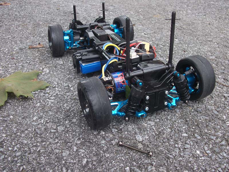

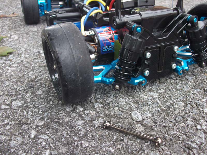

Went out in the driveway to set the trims and what not...fail. Slid sideways into the grass and it popped the rear camber link. I found that the rod end was defective - not sure how it missed that on assembly. Replaced with another and right back in action.

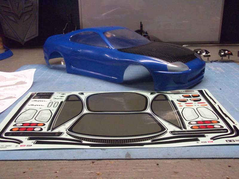

Alright, let's get this one finished..
Precut decals? C'mon Tamiya, what's this oddity?

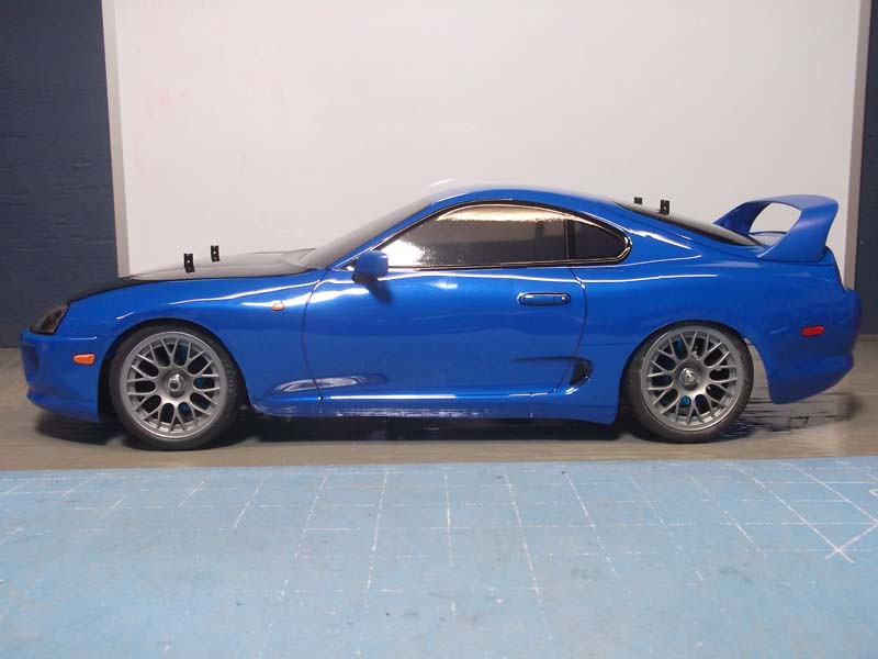

And done! I took a few liberties with the body. I didn't like the black stripe along the bottom, so I went with body color instead. Visually raises the car in my eyes.
Kept it simple paint-wise - too many with flashy graphics and what not. I love the lines of the body and they can get lost with all kinds of graphics splashed all over.
Swapped over some 24mm Tamiya mesh wheels - they tuck into the wheel wells perfectly.

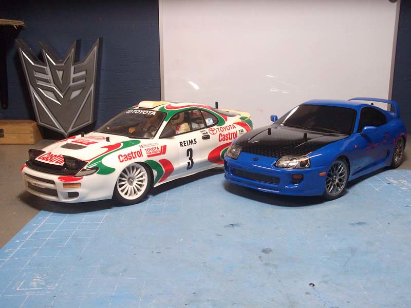

And with my Rally TL01LA. Ready to go!
