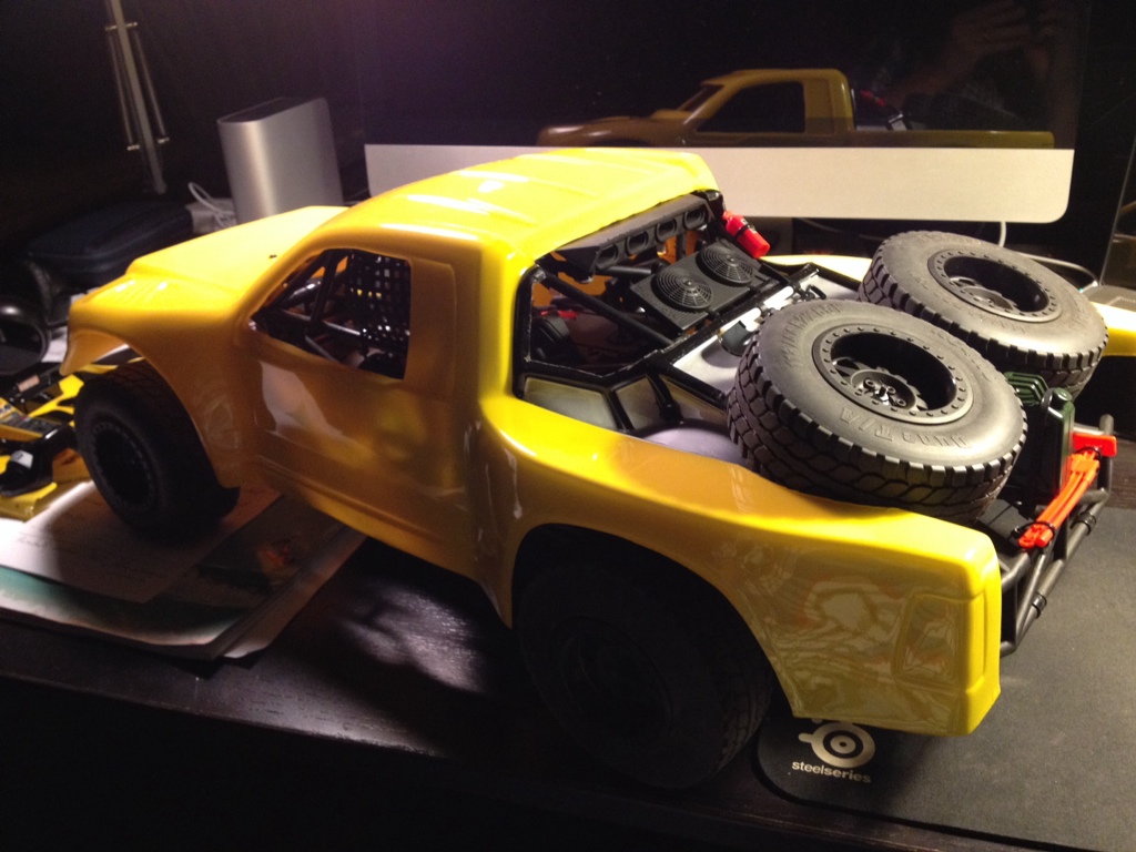

Made a little progress ;-)
More progress:

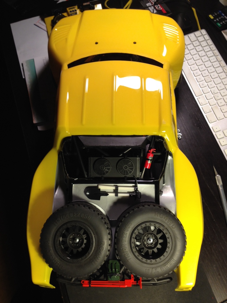

Body painted - checked.
Cockpit with drivers - checked.
Panels to keep dirt out - checked.
Roof light bar - checked.
Aluminum spare tire carrier - checked.
Scale details - checked.
Now the hard part:

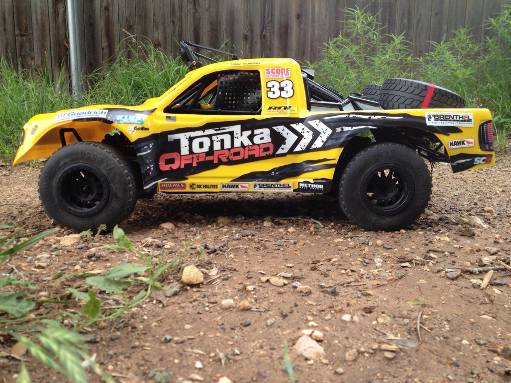

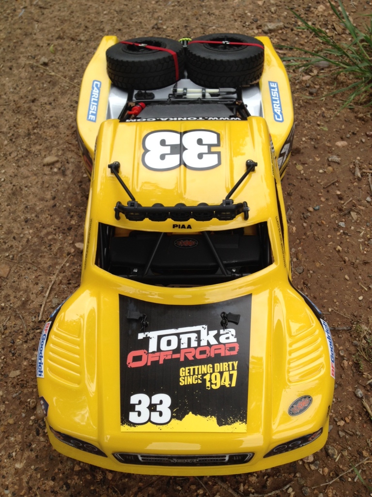

Driving and taking pictures at the same time is kind of difficult by yourself I learned... I did video some of it too, but have to edit it first. I had a blast and crashed it only twice - without even breaking anything! All the stuff in the back is still there. I need to work on my driving skills ;-) 3
Only downside: it is pretty heavy. Would take a serious ramp to get it airborne.
In the last pic you can see the characteristics of the handling best - full throttle it lifts the front just like the real thing and the rear is planted to the ground, which gives you gooood traction. Video will follow.
