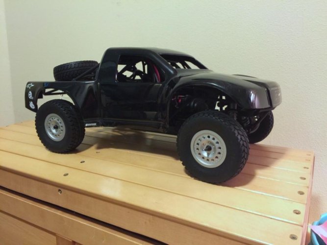

Maybe you start this thread from the beginning - has pretty much all the infos in here. SC8e 1/8 body with mathcing roll cage, stock Yeti. Only the front (tall) body post is taken from a scx10 and the rear bumper is some random one from a short course truck. I used some aluminum for the spare tire mount and a small plate to mount the SC8e cage higher than the stock one. I pretty much used zip ties and cable clamps only to attach everything. Later I added SSD rear axle, different springs and a few other details - just browse through the pics "thumbsup"

Heres mine. Still a work in progress.. back cage needs finishing and body needs mounting. Motor is a ofna 550 3300kv (made by Tekin). running a 56t spur and 23t pinion. Pretty good speed on 3s.

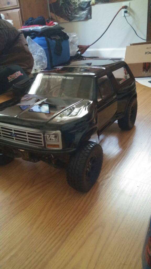

You don't stick out nearly as far as I do bud and mine is fine
That 80's Bronco body looks really good on the Yeti. How well does it fit on the truck and how did you mount it?
Fits pretty good and I mounted it with the proline body mounts
