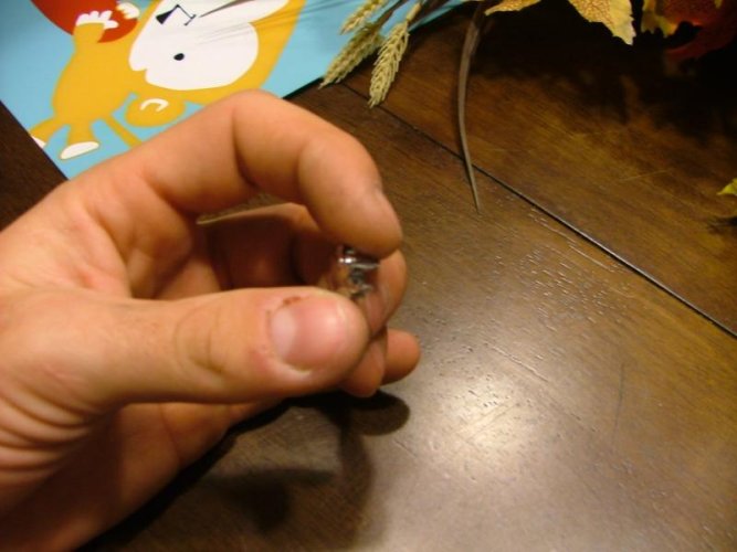

The actual chrome rocker that pushes the microswitches broke. There are two tabs one for each micro and the one for the front trim cracked. A little CA and it's as good as new. I did switch it to the D/R rev for good measure. I guess I need to stop digging so hard:mrgreen:
Kind of hard to get a good shot of it.
