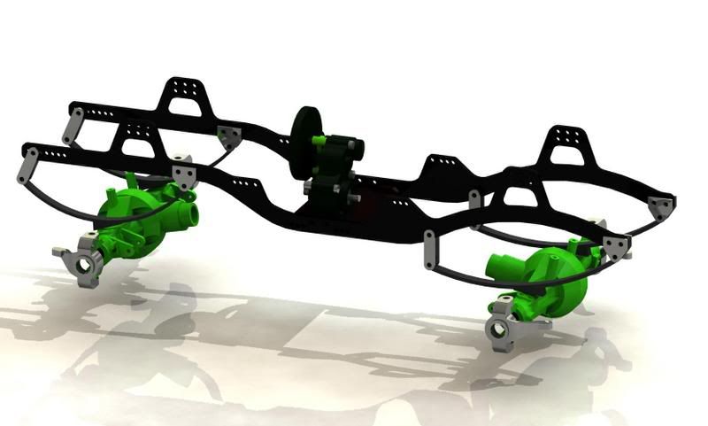

Bruiser leafs in the front, juggy leafs in the rear.
I am trying to figure out mounting blocks for the axles now.
Yeah, I explored the leaf option but the rails don't line up with the stock holes in the axles. It shouldn't be that big of a deal with an offset bracket.
IF you put the springs on the outside of the rails then they line up pretty well. I want to have offset block made up though so that you get more articulation and no interference with larger 2.2 tires at full turn.
I am building a 2.2 and wanted to run leafs in the front but that was the concern with steering clearance. I am definitely interested in an offset block so I can run dampers on the outside of the rail with the leafs under the frame.
