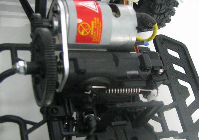

Just saw that Banggood have added kit for gear change, first I wondered where I should put the shift servo but then I found a picture on internet from some other seller that sells it with the kit installed. The gearbox does have servo mount at the back, so there is no additional parts needed and the installation looks like to be very easy.

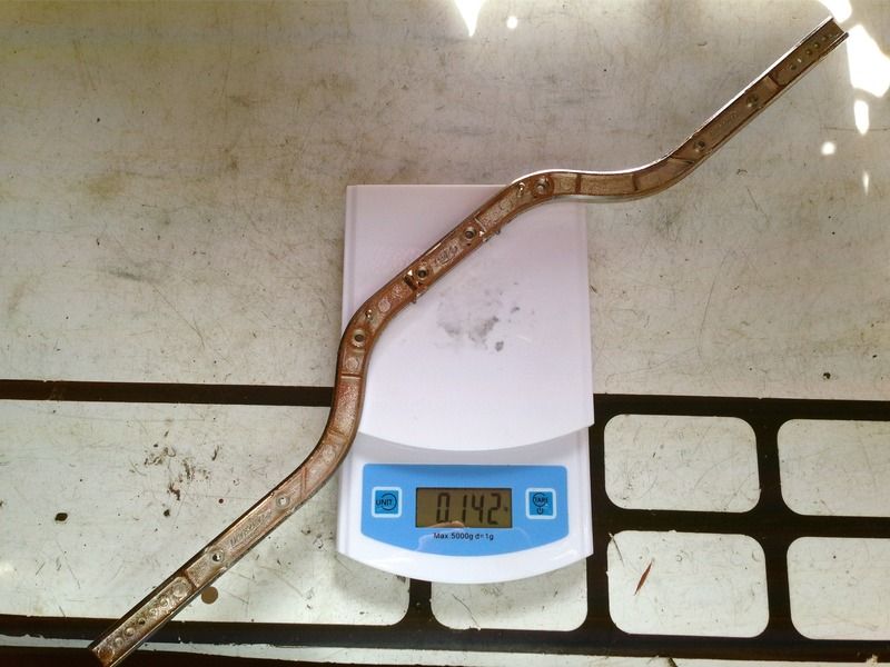

I got my metal chassis yesterday, they are quite heavy and feels to be very strong.
I'm not quite sure what they are made off, it is not steel since they are not magnetic.
