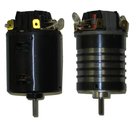

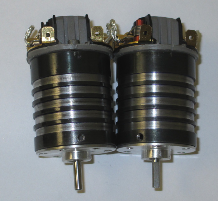

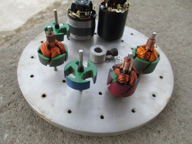

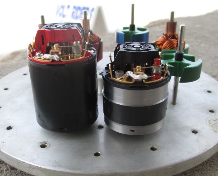

Magnets finally arrived (via boat even though I specified air) and we can begin building 500s again. I also had a spare minute and built up a proto 510 Puller. Large pankake style rotor. Equal speed and terminal resistance to a 540 motor, only 3.75 ounces :shock: Next week I will go through all the motor builds on my new drag dyno so performance changes will be empirically comparable.
To get the basic Puller 510 rotor design I worked backwards from known variables to arrive at a motor with the same speed and terminal resistance as a regular 540 motor. Whenever a motor is shortened, the resistance for specific speed goes up. So if we want 35t speed from a shorter armature, we have to give up drag brake and stall torque because of the higher resistance. Knowing this, I designed the Puller 510 to have equal terminal resistance even though the final motor is shorter and lighter. It is possible because of the larger rotor diameter and stronger magnets.
First pic shows the 510 stumpy armatures in various stages of completion, and 520 stubby armatures too.
510 Puller
28mm diameter rotor
EH33 neo magnets
Integrated flux ring
36mm major diameter
42mm long
3.75 ounce final weight, 106 grams

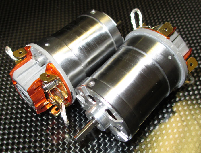

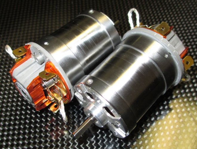

This motor set was built for Jim Hand, owner of Hand Bros off road. Puller 500 Torque edition. Armatures were matched on inductance, resistance, and weight. Motors were matched on speed with precise commutator sizing and timing adjustment. No load of each motor was 1.1a, very respectable for the tight airgap and lower than regular KV as compared with a normal 540 build.
Puller 500 Torque
262.3g, 10oz for the pair
Ribbed can
35t Fat wire Torque armature, large comm
Holmes Soft Copper brush
Holmes XX Spring
EH33 Neo Magnet
This set of motors also included flux rings for torque and speed adjustment. With heavy flux rings the KV reduced to 18% lower than a regular 540, while still being a full ounce lighter and starting up smoothly. THAT is how motors should be made "thumbsup" But all you weight weenies can still have a choice when each gram matters.
