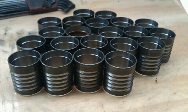

New batch of cans are done and faceplates should be done today. I forgot about thanksgiving and didn't calculate that into the machinists time. They look really nice, they are v4.5 ish or so. v5 will look mostly the same externally but be lighter.

The ribbing is for heat sink and to reduce the weight. But really I just like the way it looks. They run cold and we could have just turned the entire can down.

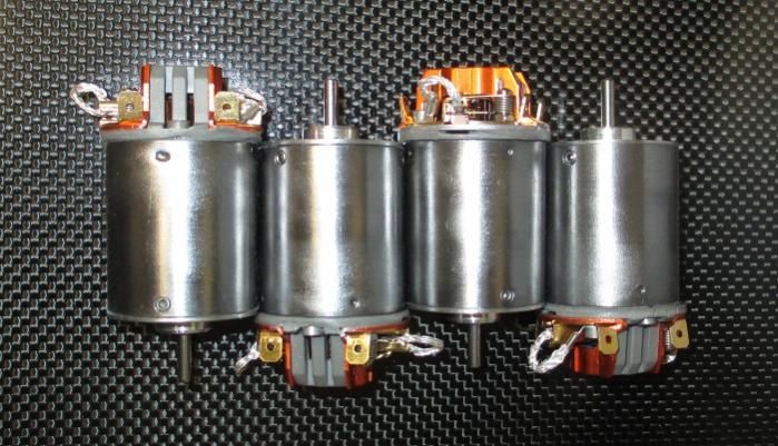

Finished up a few sets for Japan today. One set for Yoshi and another set for a giveaway winner at Nationals! I did additional work on the Flow motors to refine the magnet layout. As you can see, the weight increased. Additional magnets were installed to increase the stall torque while startup characteristics were unchanged. KV was reduced 10% and magnets were increased 20%. It will make a really hoss set of motors :twisted:.
Puller 500 Flow 3 slot 35t pair 282g 1533kv
Puller 500 Crawl 5 slot 20t pair 229g 1633kv

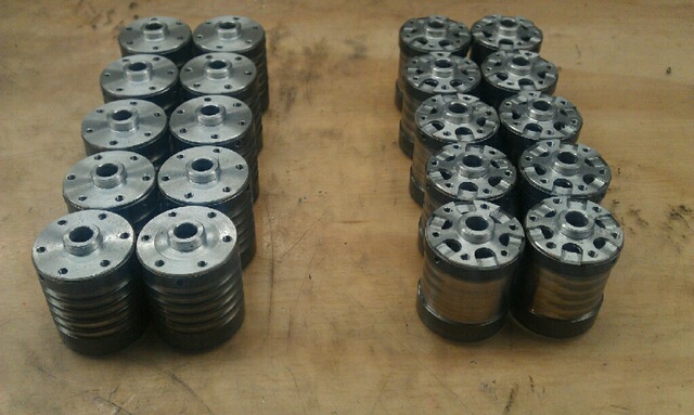

Puller 500 v4.6 (on the right) drops an additional 7 grams from the 2.xx designs shown in the thread. v4.5 (on the left) drops 3 grams. Both v4 designs reduce airgap by 50% to increase torque and brake, only allowable because startup has been refined since v2 designs were first made.
