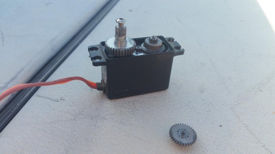

Finally blew the center pin tonight.
Had to really beat on the bomber to do it.
Glad I have a spare.
Are spare gear sets with the pin still available John?
Found a broken pin on Wednesday.... got a package on Saturday..... Holmes Hobbies has some of the best customer service. Thanks JRH and the HH team.

I have a couple of dead HV400 servos laying around with broken pins...I also had a retired Hitec 7955TG servo so I took it apart to see if the center gear pin would work in the HV400 and to my surprise, it fit. I reassembled the HH servo and gave it some power and it functions perfectly. It will now go into my part spares bag for the trails.

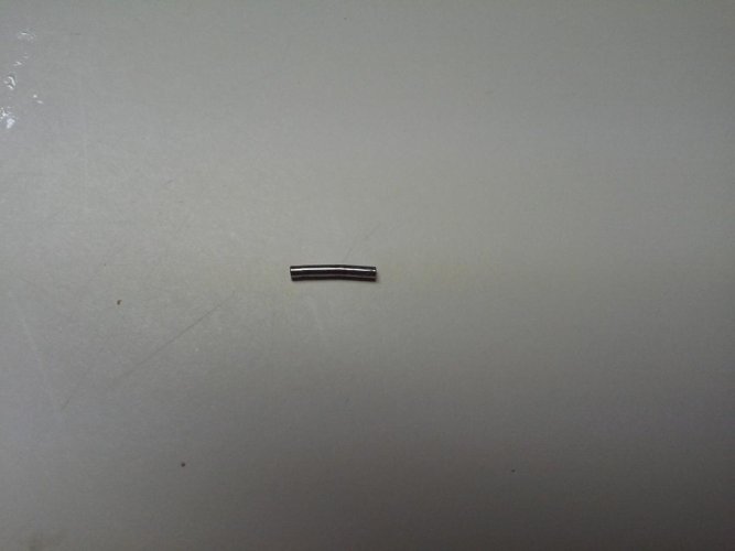

ETA: Another bent center pin... The top cover's hole where the pin rests is now out of round. Once I get another servo, I think I'll warranty this and either sell or use as a backup. :|
I feel you. The larger 2.2 rigs are the ones that show the servos weak spots. The next batch will have bushing inserts to prevent case deformation, and also give a repairable spot if damage occurs. Pin issues are solved. Now the pins are damaging the case, so we are addressing that. I'm sure something will be next in line as the weakness. :ror:
Current servos with oval pin holes will be remachined for inserts. Just set up my CNC mill in preparation.
Thats good to hear. I opened mine up after a fourth failure and now to top case has a HUGE gouge in the slot. I thought to myself "this case needs a brass or steel bushing". Its like telepathy! But yeah, between the bent and broken pins, the center shaft is without a doubt the weak point.
