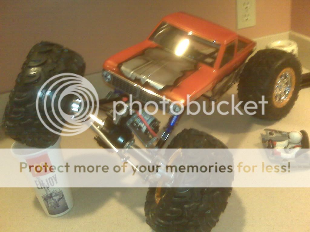

How big of servos is big enough
I'M BUILDING MY FIRST CRAWLER IT IS A SUPER I WOULD LIKE TO KNOW WHAT SERVOS WOULD BE BEST FOR MY RIG...HERE IS A PIX OF IT PLEASE LET ME KNOW... YOU CAN EMAIL ME THE ANSWER OR I WILL LOOK AGAIN AFTER WORK... THANKS JEFF..

Hitec 5995s are what I always ran, but Futaba and JR both have very high power servos available. Anything above 300 ounce/inches will be great.
