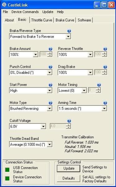

I figured you'd be the man to answer my question. On my Losi Mini, I'm running a mini Torquemaster on the stock esc. I switched out the esc to a micro sidewinder. Removed the leads from the mini TM, soldered on new leads that had bullet connectors. Programmed the esc with the castle link, hooked everything up, calibrated the esc. Everything went fine as planned, no problems. Went to run the truck, no movement out of the motor. The ESC lights up green for throttle, red when in reverse and yellow in neutral, just as it should. But I get nothing out of the motor.
Here's my programming:
Thoughts?
Thoughts?
Thoughts?
Try the black and white leads for power, there is an error in the firmware.
