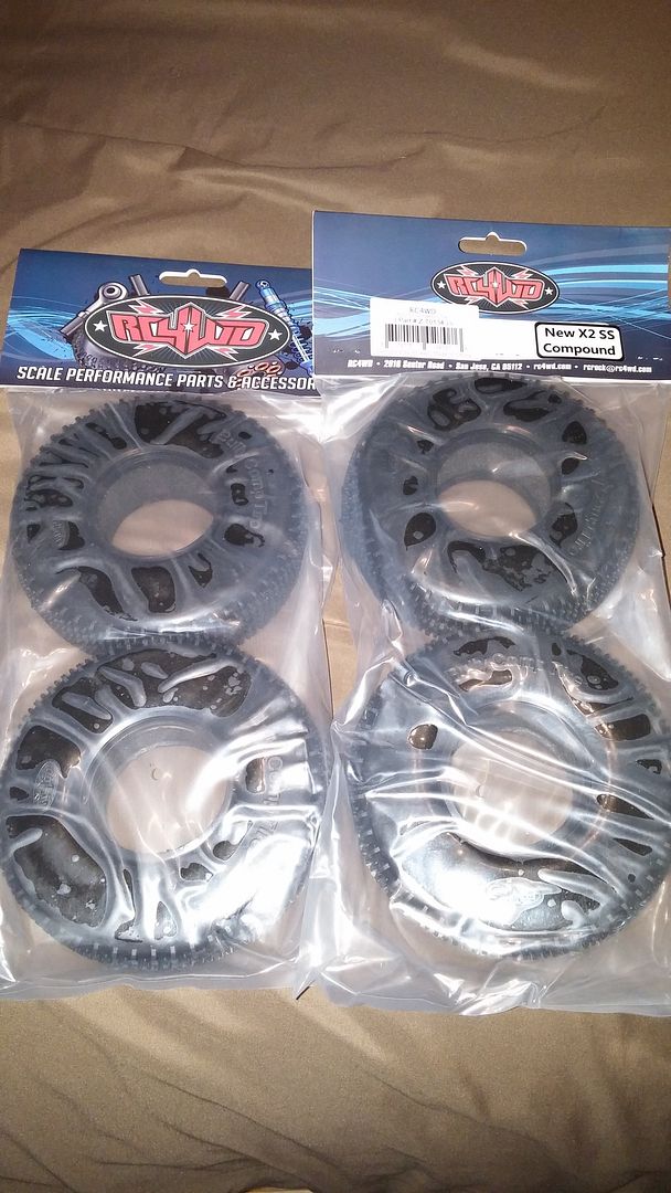

RC4WD Bully tires on the way"thumbsup"

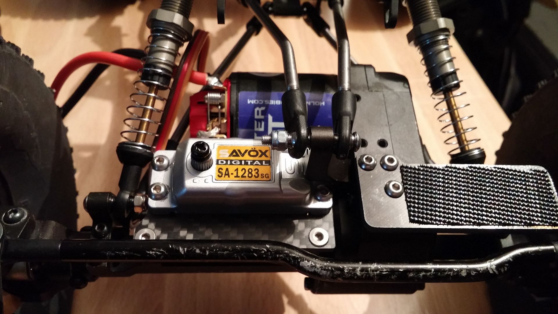

Dravtech cf servo mount and Savox servo installed... front HH crawlmaster expert too...

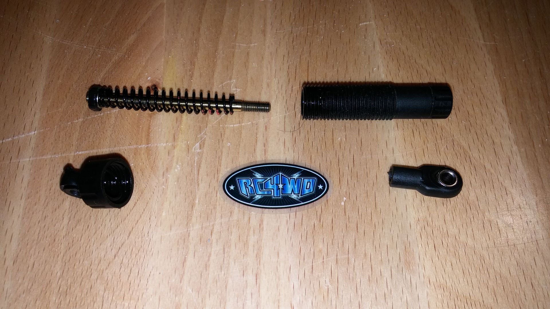

RC4WD internal spring kit for 1 of the ''in board'' shocks... I used the stiffer one...

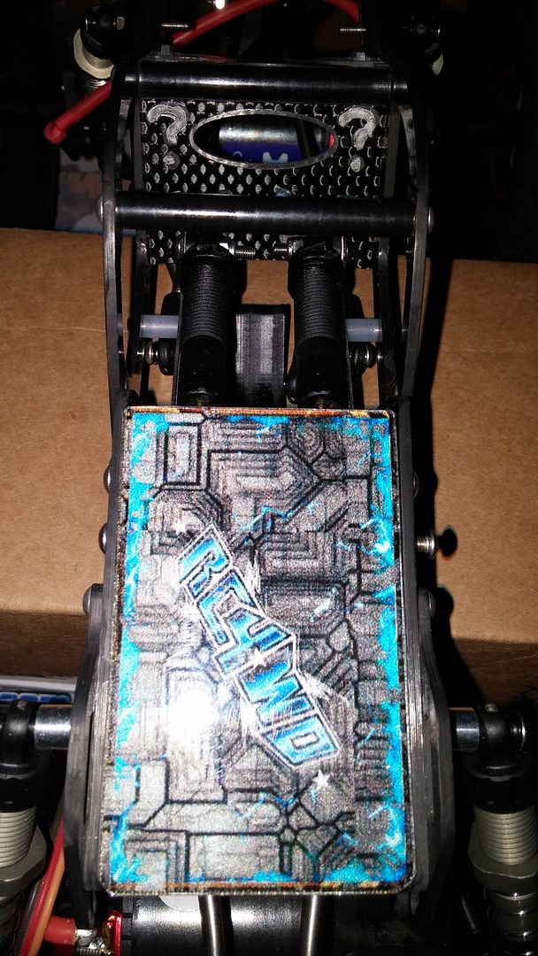

As for the shock i just picture, Is it the right way to mount it? I used the stiffier spring in the kit...

That's what I did, although I did not use any oil in those shocks...just the internal spring. I haven't had the luxury of a shake down run yet to see how this works....this may all change. Hopefully you don't need a stiffer spring than what's in that kit....don't know where you'd find one.

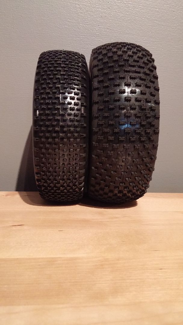

RC4WD Bully tires
