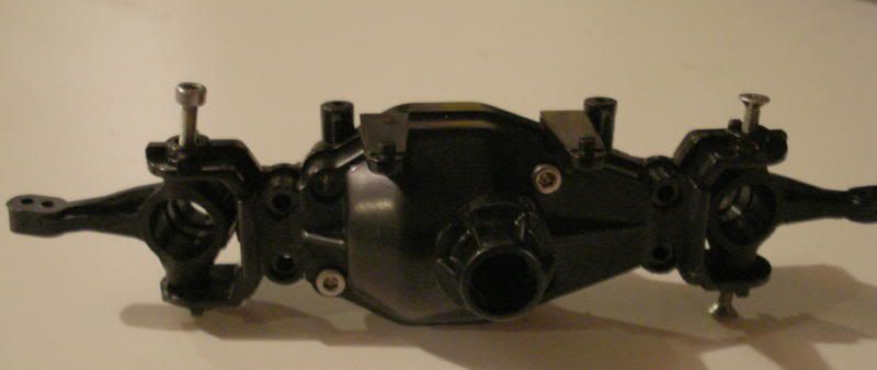

I've got it all figured out, I'm just saving up for a tlt kit. After looking at a tlt axles case I found out that I could cut one side down. Remember how a tlt has one short axle shaft and one long axle shaft? Well the plan is to use two of the shorter shafts in one axle. I've already made a prototype axle I just chopped both sides and made it to narrow.:roll:

Prototype axle

I really like that front axle. I was looking for one about that width. Do you have any brighter pics of a what you did?
