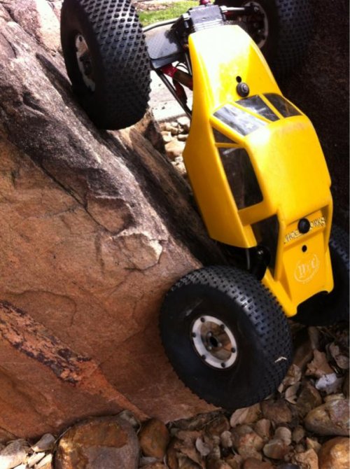

A few pics I snapped yesterday. This is a pretty nasty wedge that can easily swallow a tire when crossing it...and it comes in at a downslope. I drove straight into it. Then I backed into it. Then I drove through it. This tire and foam setup had no problems!!

I finally have a number of battery packs on these new VooDoo tires from Ottsix and I must say......I LOVE them! I was shocked at how big they seemed when compared to the Sedonas I have been running on this truck since I built it, but I think most of that is just appearance. These tires have a taller sidewall and shorter lug than the Sedona.
Either way, I was not sure what foams to run. I had seen guys try single stage, two stage CC with rings and such. None of those setups felt right to me. I was looking at my wraith and noticed that the PB Rock Beasts II's were only a hair taller than these tires, so I robbed the foams out of the Rock Beasts and simply removed the outer ring....which means that I am running a 6.0" CC Inner and a 5.5 open outer (medium rear, soft front) on my VooDoo Gold Dots. I have several battery packs on this setup and I am really liking it so far. Excellent sidewall support and the tread compresses about 1/2" before hitting the inner, which is perfect.
Here's a pic of this setup next to my PBRBII:
And a pic of the truck as it sits (currently at 4lb 2oz):
These tires have MASSIVE forward bite. They hook the rock around here very well.
