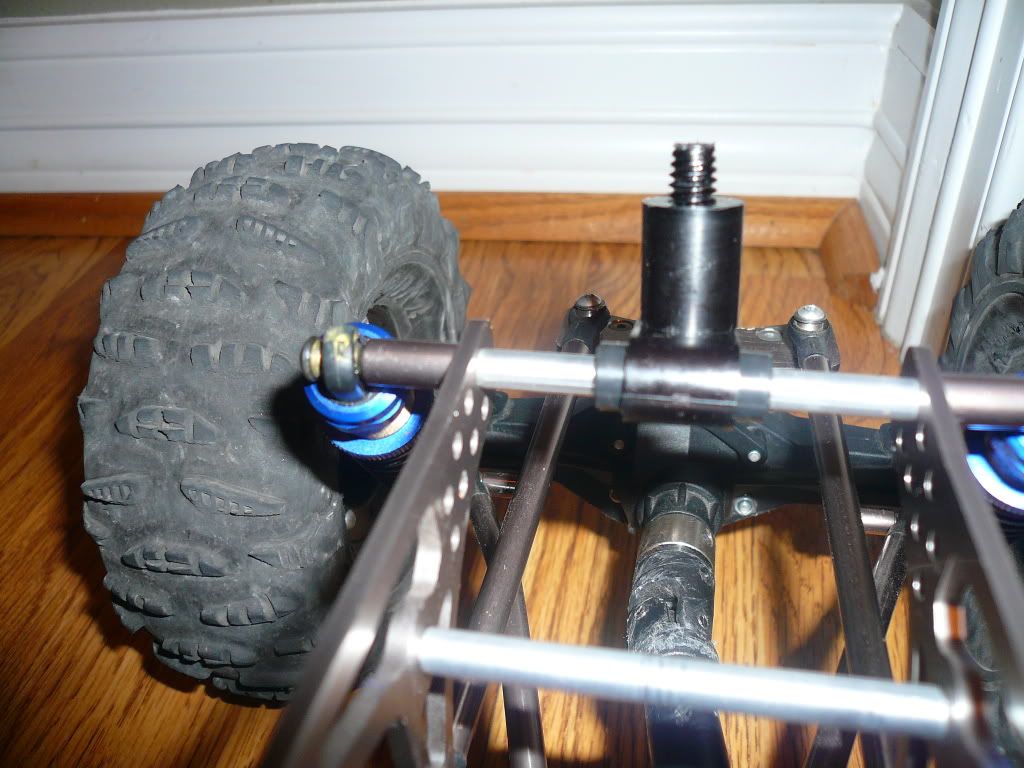

A few small updates on this truck. Made some replacement chassis braces ala Turbofest. They are smaller OD and half the weight of the stock braces:
(stock on top, new on the bottom)

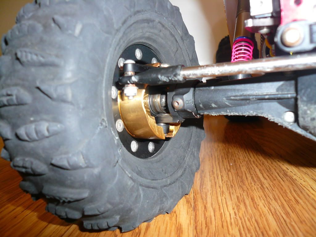

I noticed that the odd shaped inner lip of the VP knuckle weights had quite a bit of rock rash on it, so I shaved down that lip and added a ring to the outside:
Should have less hangups now:
Here is the only before picture I have of them:
