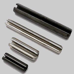

Hey has anyone had a punisher driveshaft pin come out? I lost one...I didn't realize that was possible.
Should I try to find a pin that fits??? I think it would just fall out again.
I used a spring pin. I forget what size it was. Its been in there for over a year. I have them at work but i'm sure you can get them at any auto parts store. I keep a bunch with me out on the trail just in case. Here's a photo of what they look like. Hope this helps.
Those spring pins have been working great. They have backed out a little but luckily I notice soon enough. Everyone says get MIP's but these are so much more scale.
