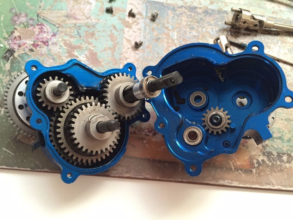

Hey bhb- how about the dhawk trans.
Mine sqeals more than a stuck pig!!
Any possibility?
Any possibility?
I'm working on it BUT if I can't get the guys behind it NO GO...
I'm also working on a tranny mod... I'll keep updates on my XLX build "thumbsup"
I'll go over the HC setup with ya if you want
