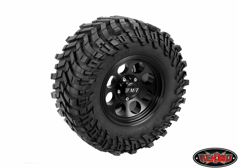

instead, ill go back to the 40series rims. and throw some big tires on there. for now ill stick with the stockers, but would like to upgrade to something scale and cant decide which ones i like more.
X-locks: least scale, but still better than stock, and the cheapest out of the lot.
rock crushers: are probably too narrow to fit my wide rims but are my favourite looking ones.
slingers: are the most likely to fit, but my least favourite design
Baja Claws: most expensive, but probably the most awesome of the bunch.
and, i dont really want to spend $90 plus post on tires... :/

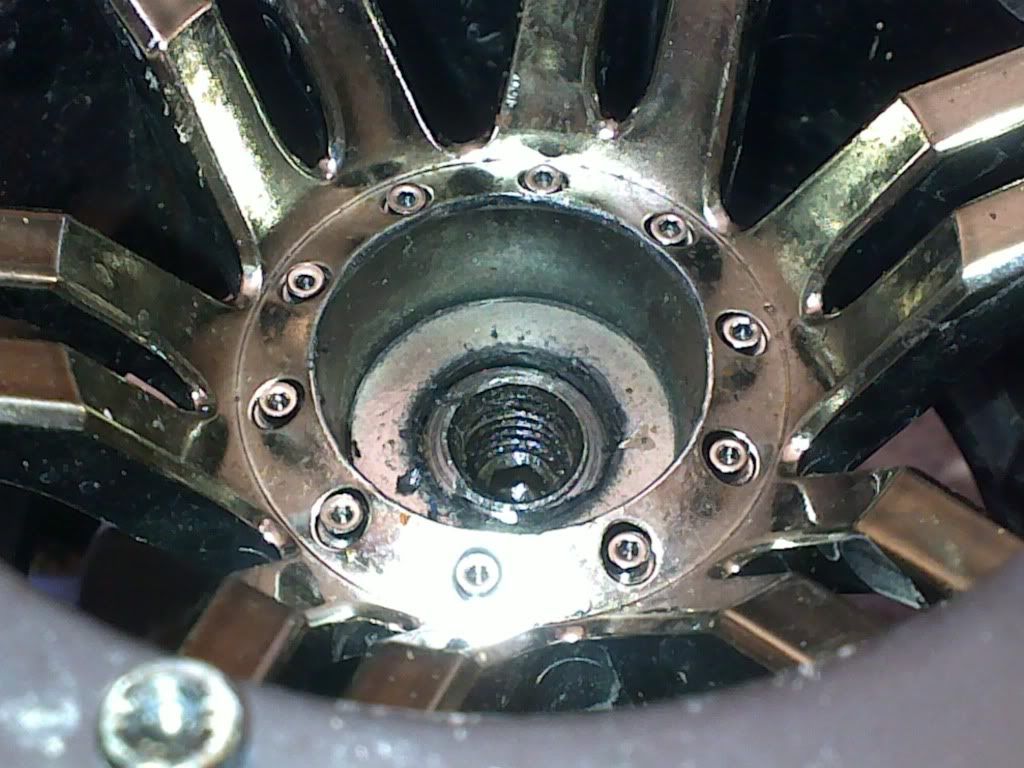

heres the 2.2s fitted to the stubs.
and this is the 40series wheels on. i think theyre too big and look cartoonish..
lifted
i think i want to stick to the 2.2s, i kinda like this look>
but also like this look>
