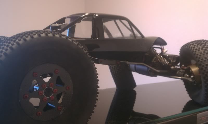

Front axle top hole with spacers.
Front chassis one hole up from the bottom
Rear axle middle hole with spacers(top hole with no spacers)
Rear chassis one hole up from bottom.
Extreme verticle climbing is a little slower, but the descents are way more controlled, and the chassis will suck down well.
Climbs that are out of the reach of the wheelbase are easily jumpable though.

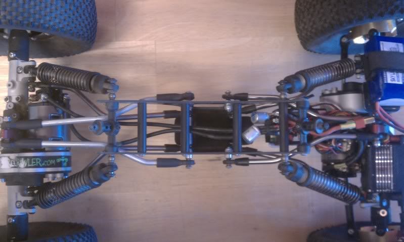

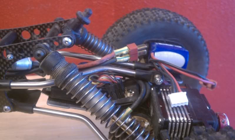

finally got around to getting all the electronics on the front axle.
Re: Krawl's "SECRET AGENT"
Wiring looks almost as good as Shelbys. :mrgreen:
Knuckle weights. :roll::lmao:
I need to find one of these for my XR build coming up.
Jeremy, you really keep coming up with goods to keep the juices flowing!
Looks good Jeremy"thumbsup"
Looks like your BEC is direct to the receiver @ 7.4V ??
And on the FXr the red wire is disconnected??

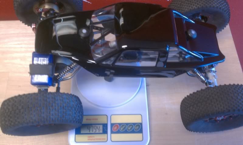

so i got back from copperstate and i am very pleased with the rigs performance.
2 sub 5 lb secret agents in the top 10 aint to bad considering the amount i had on my plate and the new light weight setup.
i am really liking the way it drives and feels.
i had a few requests from some drivers ...(nabil will know what i am talkin about)
so here is the rig with something new:twisted:
sitiing at 4lbs 12 oz with 5 oz of knuckle weight per front corner.
