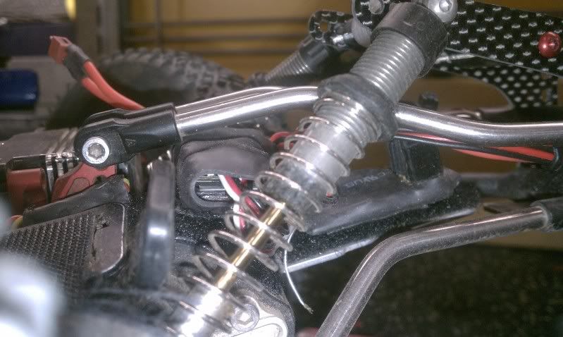

whats your oil setup with these shocks? Gona tell us what the springs are?
He's still playing with oils but is at MRC silver rear, mini t silver front. Same setup as myself and others. "thumbsup"
Re: Krawl's "SECRET AGENT"
have you driven the new truck yet. how are the spring. are they soft enough for you.
i have 55 f 65 r
that was initial and may need to go up.
springs are mint silvers and some other silvers that are slightly longer. i think mrc...

i have 55 f 65 r

if you find a way to keep these shocks from wetting them selves every time theyre on the rocks please share :)"thumbsup" truck looks fantastic man
Coat the O-rings with gear science and bleed them properly?

so i got back from copperstate and i am very pleased with the rigs performance.
2 sub 5 lb secret agents in the top 10 aint to bad considering the amount i had on my plate and the new light weight setup.
i am really liking the way it drives and feels.
i had a few requests from some drivers ...(nabil will know what i am talkin about)
so here is the rig with something new:twisted:
sitiing at 4lbs 12 oz with 5 oz of knuckle weight per front corner.

Now THAT is what i'm talking about! I was thinking about the same thing, just with the castle micros. I thought one and the RX up front and one out back.
Man that's clean wiring, taking the lightweight $hit to the limit, you will have her under 4.5lbs before you know it.
