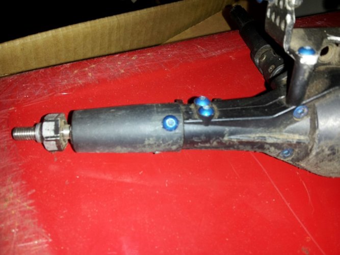

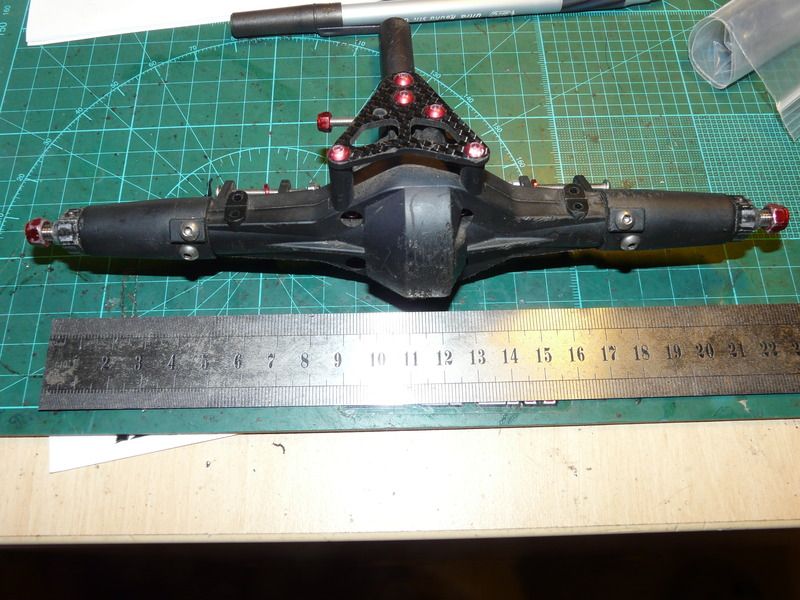

Here is how the rear looks with the Wraith lock outs and special axles. I know Creeperbob makes some but I am also sure you could make your own.

I use one piece Ti 5mm rear axle made by egressor with wraith lockout the diamension is shown in the pic. By the using larger hub and/or bigger offset wheel is easy to match front and back track width without the unnecessary rear tube.

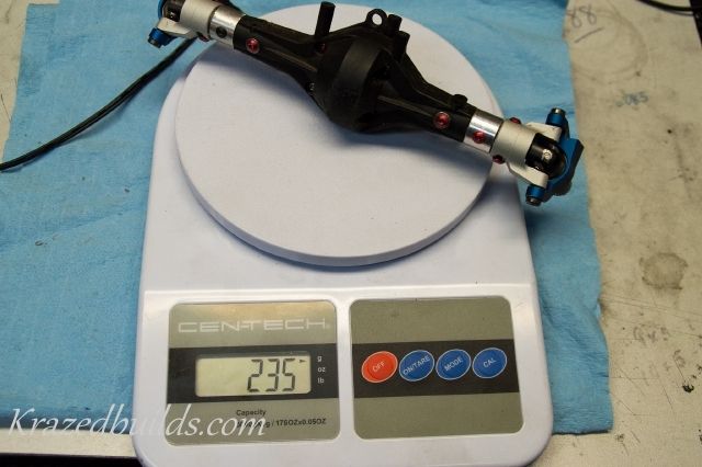

but on the quest to lose some weight I started with the front. Easiest was to take wheel weight out, No I dont want to do that. Instead I got some aluminum tubes from RCBros and changed my locker out from the Vp one to the GripFab.
Heres my starting axle
And GripFab locker
To the new axle
A cool 30grams gone there and I left my 64grams out at each wheel.

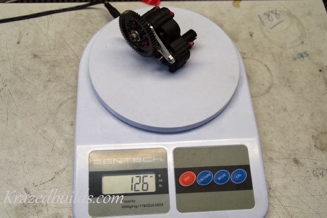

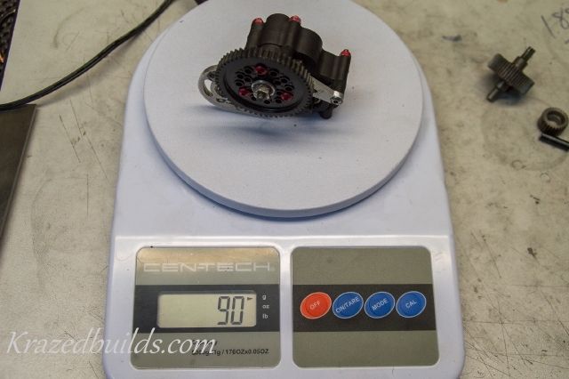

Next was that high boat anchor trans I have for now.
Good Lord!

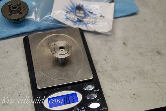

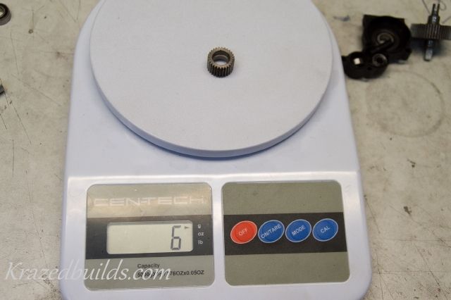

Lets look inside ..... First to go was the solid Robinson
For the Aluminum Robinson

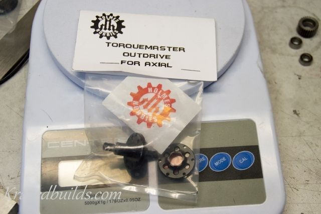

And HH outdrives
And after a little drilling the holes out
For a total of? "thumbsup"

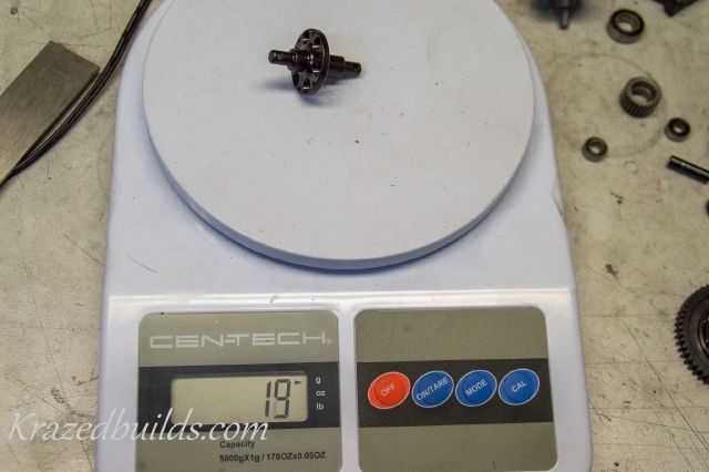

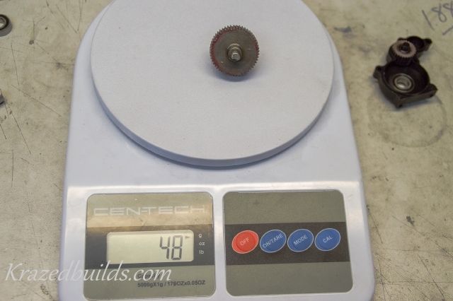

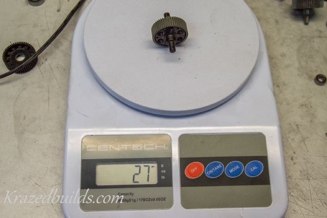

Next was the idler shaft
For a 7075 aluminun gun drilled one
Wait! Is this thing working? Lets check .........
Phew scales not broke yet ...... but I moved on to the steel idler gear.
Yup Im the crazy guy willing to run plastic
Didnt do much to the top shaft though for now. Gave it a drill down the center but only saved about 2 grams there. Future plan is Aluminum like Krawlfreak did couple years ago.
Back together I saved some good weight with just a few changes.
A cool 35grams down ..... with future plans of a Carbon Fiber plate from BWD (he makes them and its about supporting other vendors), a lighter motor (got my eye candy looking at some), front drive shaft and eventually a new transmission.

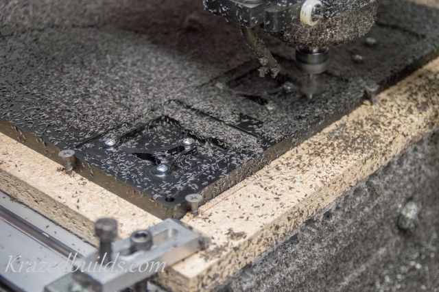

Oh and worked some tooling tonight for our Losi skid ....... got some cosmetic changes to make and tools to order but its getting there. "thumbsup"

Your skids look absolutely amazing. That was the biggest and nastiest cost factor to our chassis. Wish I could do them in house. Nicely done!

I hear ya, my table is such a mess doing them but the rewards worth it. They def take the longest to complete and luckily I work cheap lol.

89% happy with tooling, back to the CAD for the other 11% fine tuning.
