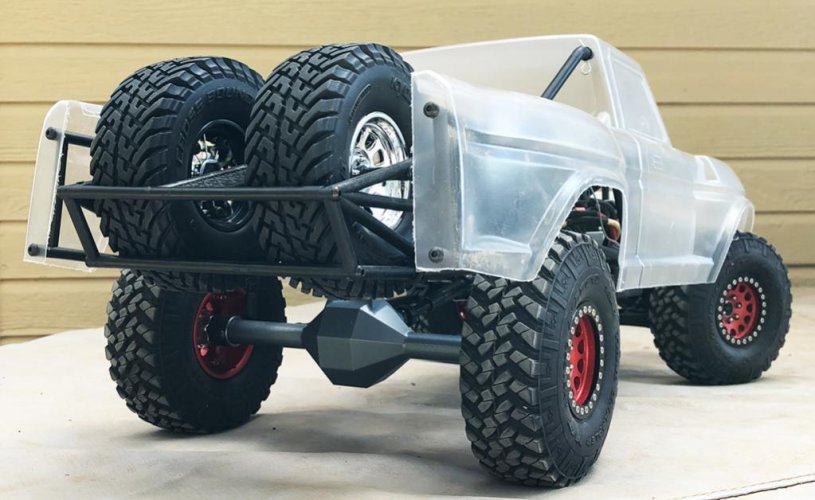

as for adding weight over the back, im sure those spare tires would be key. brass beadlock rings, beef patties, etc would all help!
Finally got mine after being on back order for weeks at Tower. I gotta say for a $200 kit the quality is much better than I expected. The plastics are nice and strong and the shocks are incredible for the money. I've never been a huge Kyosho fan but I'm impressed.
Kyosho are you watching ? Do a rerelease and make the truck like this , since it’s how you SHOULD have done it in the beginning
What wheels and tires on this rig? The ones pictured on the first page. Thank you
Wheels look to be LockedUpRC Recluse 1.9" and tires I believe are the Falken AT3W All Terrains that come with the ECX Barrage.

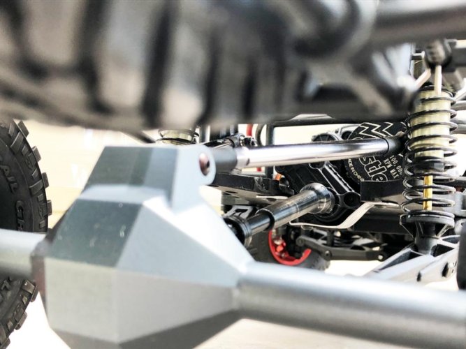

The pinion angle is the most difficult issue to overcome. The truck has a lot of rear suspension travel. The easiest thing is too mount the trans at an angle to ease the pinion angle at the axle
This looks sick. The top plate would be very easy to design and print in 3D once I get my model in I could easily start modeling some working prototype.
What parts do i need to buy exactly, I'm seeing a lot of axles and gearboxes but theres not much information on ebay and im guessing its all just housings and no internal components.
Not seeing any angle issue at the moment, but I think that's also coz the sway bars were acting as limiting straps. Top link length will help with angle as well (i'm just using the RGT ones I pilfered along with the axle).

The pinion angle issue will show up at full suspension droop. With access to a 3d printer a 30-45 deg trans wedge wouldn't be too hard to make.
True. Like I said i'm not seeing any real angle issue at the moment as my droop isn't quite as much as yours with how the sway bars are currently working. I'm planning to run limiting straps anyways, they made a world of difference to my Baja Rey with high speed cornering.

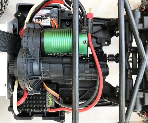

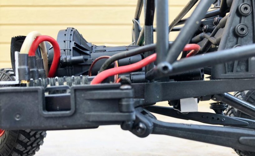

GUYS! I did not forget about this project. Life work and other things (1:1 projects) came up - but as there were visitors on this thread, I finally had to get back to it.
I tried the OG SCX trans over and over but as Killa-Cotton pointed out, the angle is too steep. The output is just sitting too high. So, then I thought, i put it all the way in the front and ended up with a ridiculous long drive shaft.
Also, The motor was too high up. Bad COG. So - drumroll - here it is. My solution that works best so far:
A SCX10 II kit transmission!
I finally cut a chunk out of the chassis and managed to get the transfer case way down. I used some sheet metal and made a temporary bracket to hold the
transfer case in place. It turned out to be pretty strong actually.
Now, it still looks like too much angle on the drive shaft, but this is already a gain of about an inch!
I made a simple battery mount and drove it around the driveway (video to follow, after I painted it*). Only when completely in the air, the axle collapses this much. And the drive shaft still turns fine. So, during regular driving, the angle is at a decent angle and compressed, it is straight (dang, I forgot that pic).
The only downside with the kit trans is, that it uses pretty much all of the chassis. I put a 3S 2200mAh right in between the steering servo and the transmission, and it barely fits. But I wanted to keep stuff as low as possible.
