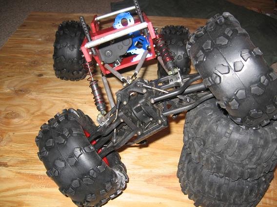

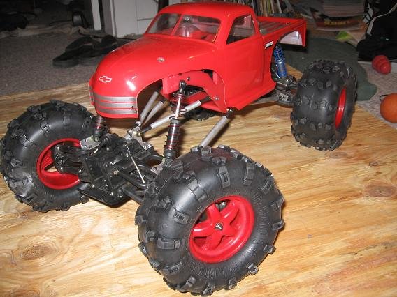

more pics body on this time. :mrgreen:

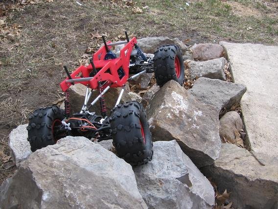

Here are some poser shots on the rocks.

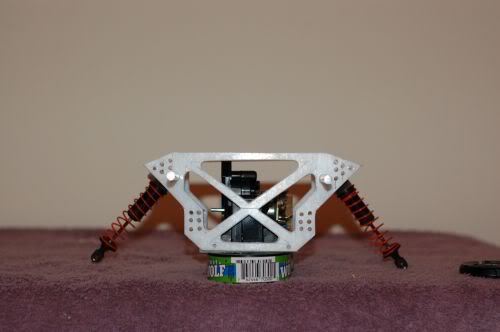

Cole82, forgot to tell you that stuff is a b*tch to dye!! I made a chassis for a guy here in town, 2 packs of black dye, 4 cups of water, and 1/2 cup of salt. Had to boil it for 7 hours (adding water when it boiled off) then let it sit in the pan for a day in the garage. That stuff is light but stupid strong, the guy you made it for will love it.
Here are a couple chassis I made out of that stuff:

My TLT. TLT chassis I built for me weights .72 pounds with the links, body mounts and servo/top link mounts. Been running it for 6 months, no breaks.

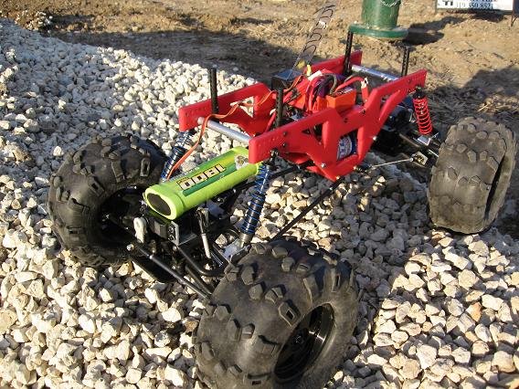

Just finished up Carbon Fiber links, steering links, and solid axle lock links. Now its time to mount the electronics!;-) :mrgreen: :roll:
it looks kool i'll give ya that but its gotta perform too. are you gonna post pics with electronics or make us wait? im curios about your batt mounting.
HEh HEh, maybe tomorrow.... maybe not. Yes it must perform, but yours must perform as well!! We shall see! :-P

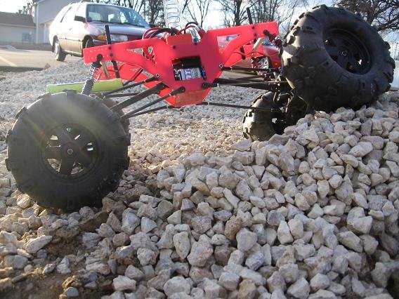

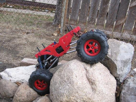

Testing went really well. Zero torque twist. Crawled really well. He tried carbon fiber links. It didn't work out the best. Going back to the solid aluminum ones. Need to change the red springs out to the blue springs for even out the flex. Wow do the tires work goodd. They really grab the sharp rocks.
I'm happy with it.:)

Pics! for the people

Looks good guys, if you had told me you were going to test it I would have haulled my a$$ off the couch to come see it. Guess i'll have to wait until tomorrow. Did the links fail completely, or do you just think they are not going to hold up over time? Can't wait till tomorrow.
Ya they broke on the first rock that hit the link. Split right in half. Do you have a RX pack that he could run?
