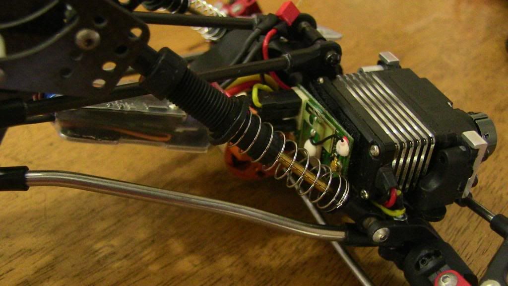

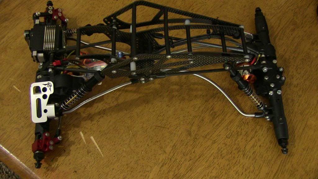

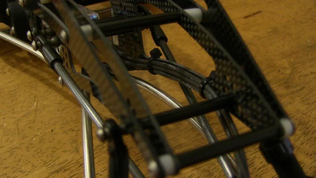

Spent a little time with the magic heat wand AKA soldering iron, and this is what I've come up with :) I'm trying a little different mounting idea for the RX, and it makes it a whole lot easier to access the leads vs if I had smashed it in with the ESCs. Thanks to Everett the SCX10 shocks now have Axial bent ends and Jeepndoug spring cups with Mini T springs. I'm trying out 30wt oil just as a baseline to start with. Ok, enough with the blabbing, here's some pics!
1lb 15oz Completely RTR except for wheels/tires. I have a feeling I got most of ya beat for light weight. Can you say sub 3lb rig?

From testing the electronics out today the motors are smooth as butter, but I'm saving my final verdict until I can get this out on the rocks and see how it is in the real world.

That's crazy light! Hell at that weight, no foam tunning needed.. cause the side walls will be enough to hold that rig weight up!
me, I'm goin back to 4lbs 1oz or so.. liked but didn't like sub 4lb so much..

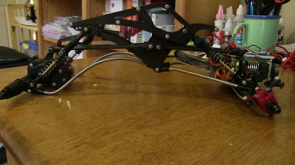

But yeah, looking good! It isn't quite sitting right though... Set the rear shocks to the upper set of holes, and maybe shorten the rod end on the rear shocks a hair if needed.
The upper link mount holes should be on a vertical plane, not angled forward or backwards while at rest.
Done "thumbsup" Thanks for the setup help! Any more info will be gladly accepted... only problem is your a berg guy :flipoff:
