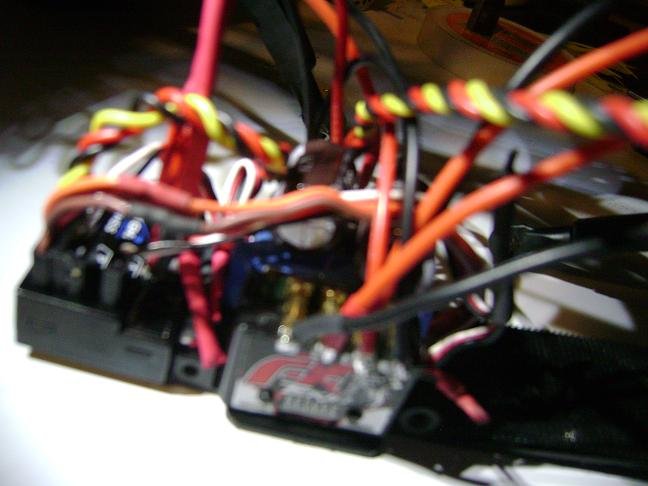

Which caps are you gonna throw on them?
Id have to go back and read it, but there were some good posts recently about which capacitors work correctly and which ones don't. It seemed like they were telling us to stay away from the RS ones.

Most of the either say stay away or just as an emergency backup.

Mini...the deal with the rat shack stuff is most of it is higher resistance than you'd want on the FXR. The problem there is that it will cause more heat buildup in the system. The stock cap is a 14 ohm ESR so you don't want much above that. The caps that digikey sells are either the same as stock, or for the 25v caps they are 18 ohm.
