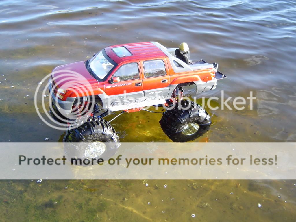

F350 bod with mods
stock 350 set up
350 trans
350 axles
imex clod buster tires
txt1 rims cut down
35t motor
cc sidewinder esc with bec
3s 1350 lipo
ped half shafts
custom chass

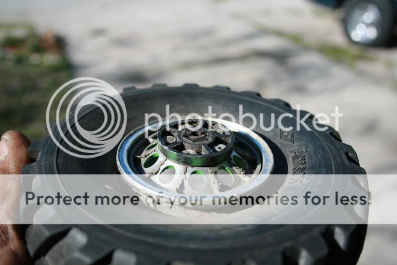

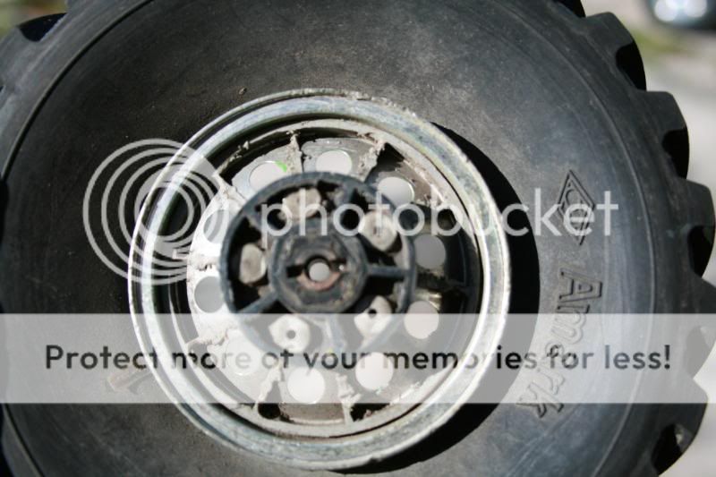

What adapter did you use to mount the TXT wheel to the highlift axles?
Thanks!
PS - Killer rig "thumbsup"
Thanks!
he glued his 12mm hex into the hex fitting of the txt wheel,im using clod wheels so i just glued it to the wheel by drilling out the hole so the lip of the axil hex would fix in there.
Thanks!
well this is what i done it the adapter for the clod i drilled the center out smaller then a 12 mm hex and pressed it in and put some ca on it "thumbsup" also cut the rims down and the adapters some
