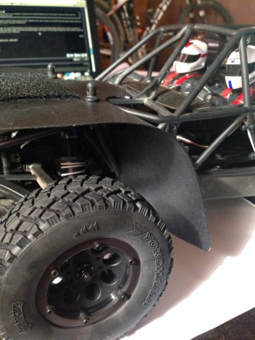

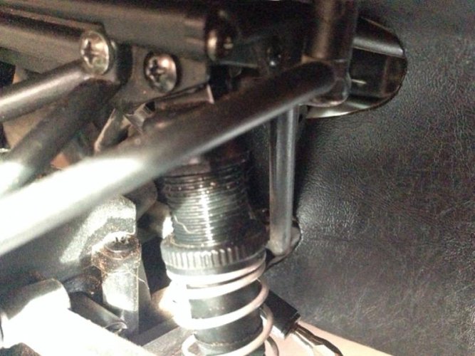

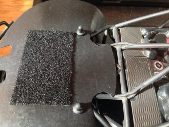

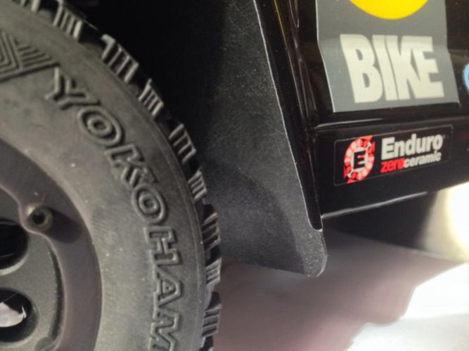

I went the screened in route, but used a sheet of motorcycle air filter material cut to size. It was ok, but didn't help with larger debris kicked up by the front wheels. I found that this fender template worked best.
Remington's MTDT - HPI Mini Trophy Forum
You may need to do some trimming, etc, but it's the best set up I've found so far. I used the flexible plastic cover from an old 3 ring binder to make the fender (and Wraith panels, and other stuff). I left the downward edges a tad longer, so they help to keep more stuff out from under the sides. I'll take some pics and post them up for reference.
I mounted the front body posts through the fender, which gives it a much more stable set up. The fuzzy Velcro patch is just a soft buffer between body & fender.
