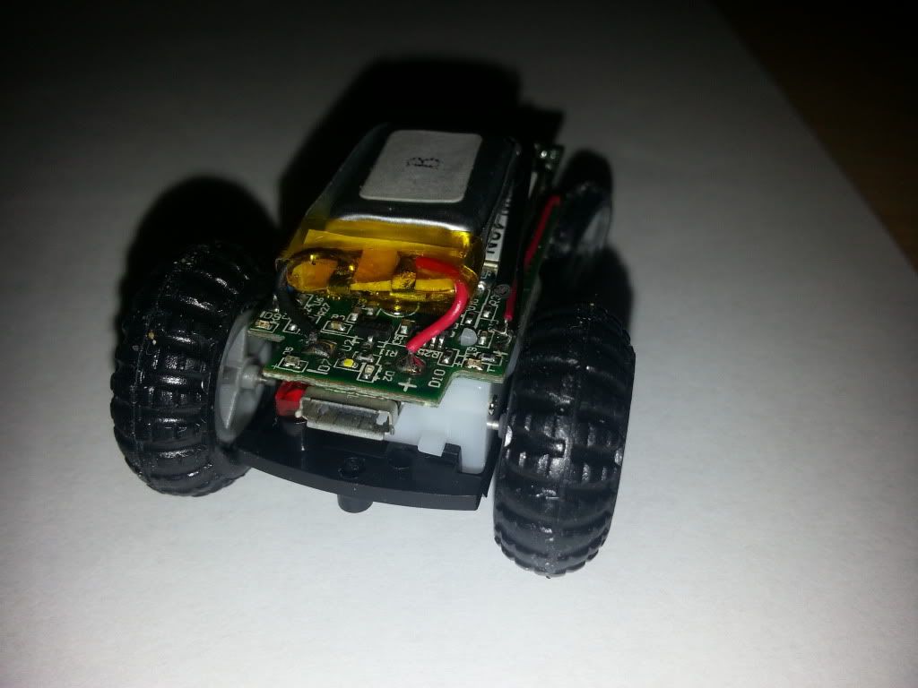

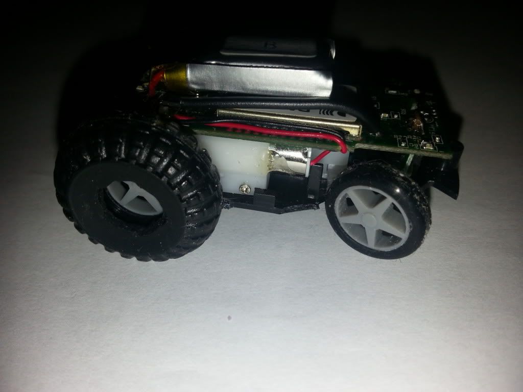

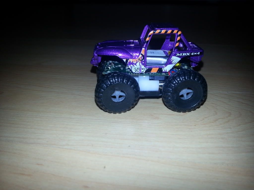

Here's some pics of a ultra nano crawler I am working on. Should go well with trailer
