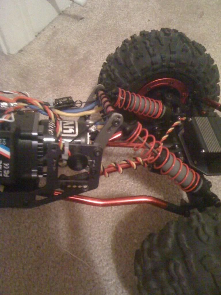

My Venom Creeper with various mods
I am also using the losi arms and had my setup the same as yours. I found that by mounting the losi arms vertical with them curving towards the front in the front and the rear in the rear it is a better setup. I was able to use the shocks in stock form (without limiting the travel) and keeping the internal springs. It would be an easy change, and I think you'll like the results.
what kind of losi arms arms are you using as yhe shock mounts ??? I would greatly appreciate your feedback I can't seem to recognize the part !!
what kind if losi arms are you using as shock mounts I can't seem too locate or recognize the part !! i would greatly appreciate your feedback !!
I have tried both setups (horisontal and vertical losi arms) and I have to give this one a try before I alter more things.
I like the way I can mount the body now - sitting really low

I done this awhile ago as well...I'm runin 2"3/4 to the bottom of chassis....the next thing you need to buy is some new shocks..... I'm also running my 70mm uper links in the whole I drilled like the ckrc stage 2 kit.....I still have alot of articulation with very few torque twist since I did so "thumbsup"
Yes colbygosdin - that looks close to my setup.
I tried with LOSI arms both ways and I think it is related to the shocks you are running (length/stiffnes)
