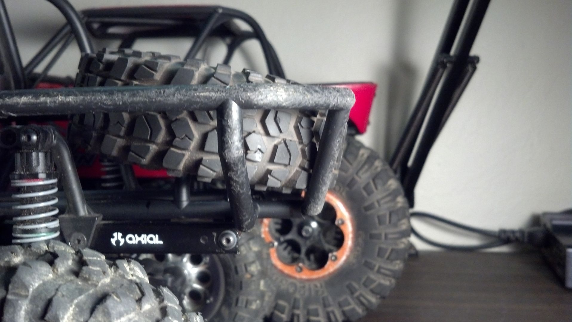

Great looking bumper, though it sits way too low on the body
Thanks, yeah that's what I was thinking...need to raise it to match the body and get a little better approach angle. Guess I'll stack the two bumper mounts and brace from the side like Nissan_driver24 did with his Dingo bumpers.
Thanks for the nice side brace idea, looking through my parts box now. "thumbsup"

Got some new tires today! What do you think of my new front bumper height? I'ts just held in there with tape for fitting at the moment.
