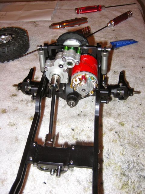

Chris.. I'm going through the same super short driveshaft issue right now. I was goong to cut & weld an MIP. We could go halves on a set if you like.
It does look like your motor could go forward more. Lets see a better picture from the top. My motor sits right next to the servo and I planned on fabbing a little heat shield.

From the other side...
Can't really get it much further forward, maybe 3 or 4mm, at most. Bit worried with it being close to the servo as is.
Also have hood clearance issues. If I go forward more and tilt it up enough to get to clear the corner of the servo, then I would need to cut out the hood and put scoop in; which isn't necessarily a bad thing.
Yeah, we could do that; that would be cool. I was scrounging around and thought I had another set, but I guess I don't. I'm going to work on it a bit more today, and I'll bring it tomorrow and we can look at it and all.
Oh yea.. I see now. I have mine mounted sideways like, bolted to the frame rail so it fits better in my application. My driveshaft has to be really short too but, it doesnt have to extend so, thats good. It can be welded solid.
I'll order the MIP's.
Yeah but, I'm running TSS frame rails and I made a special bracket to mount it sideways. It would be a little more involved to mount it sideways on SCX rails. You can see what I'm talking about in my build thread. I wouldn't worry about the short driveshaft though.
