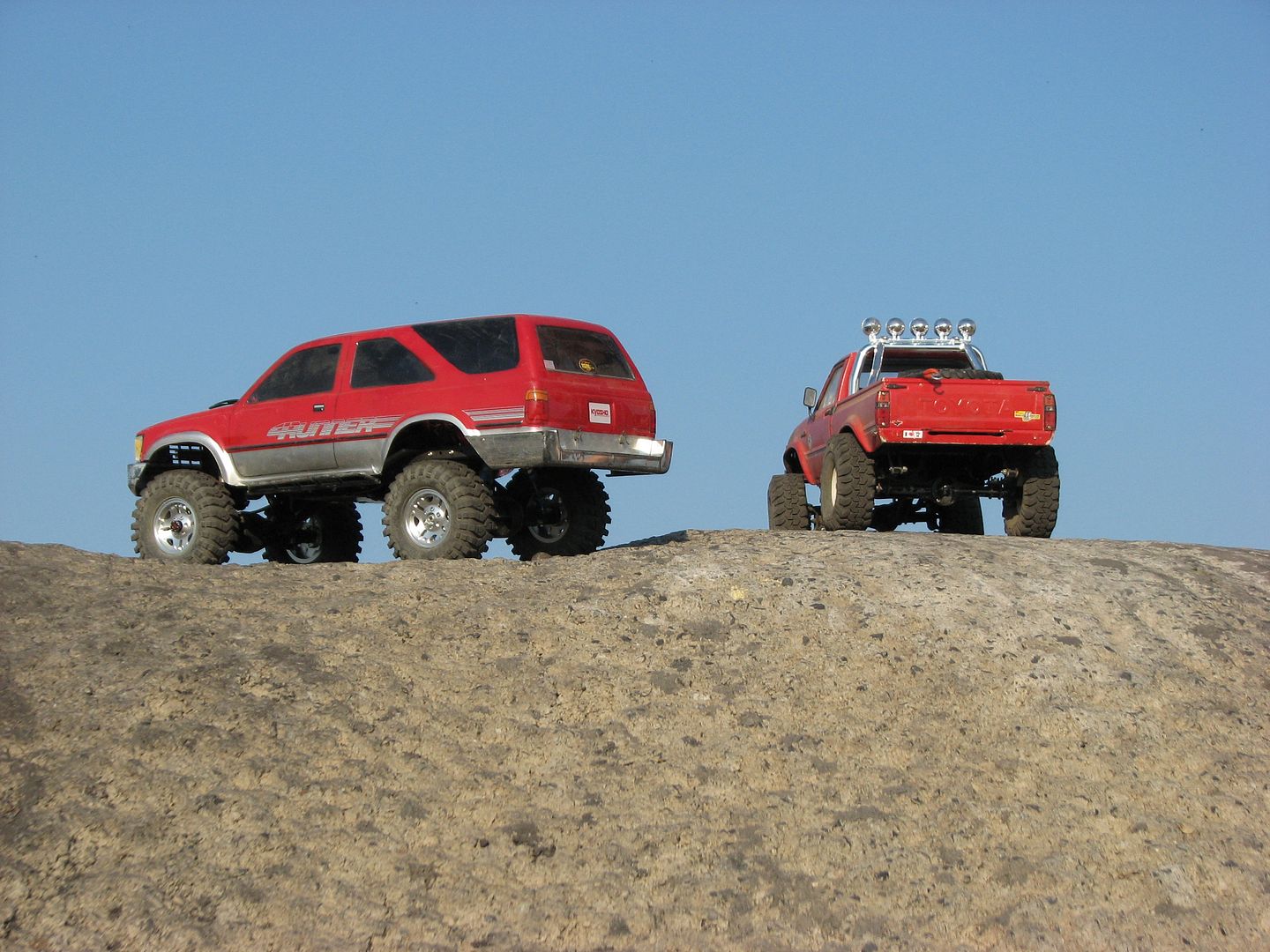

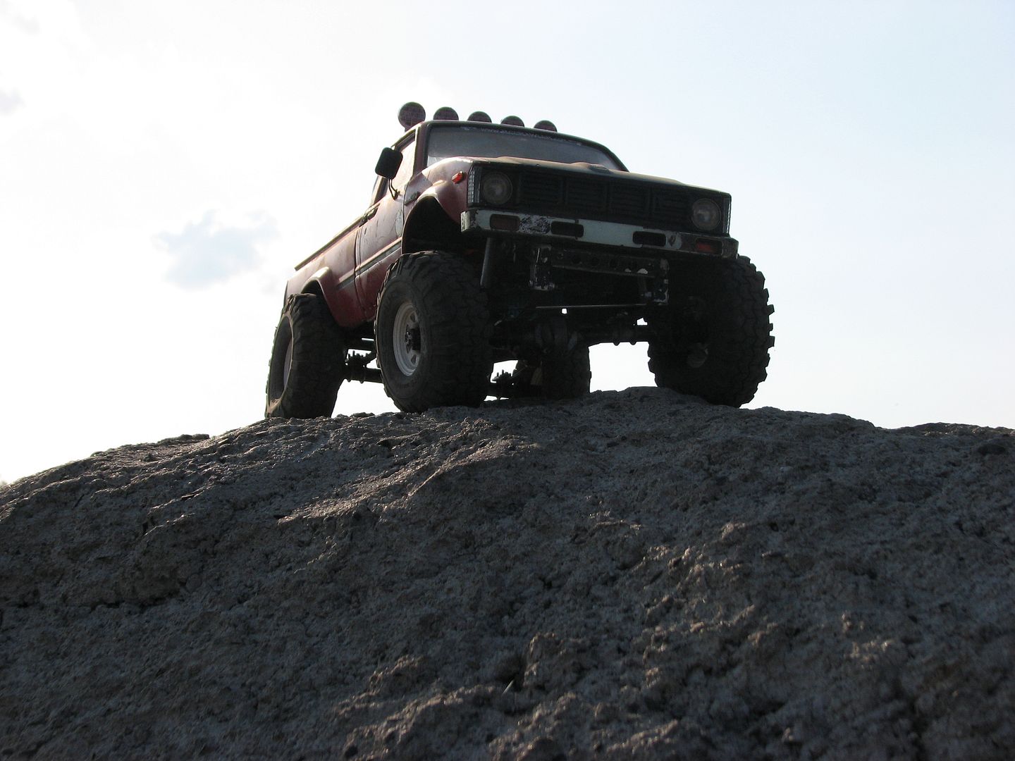

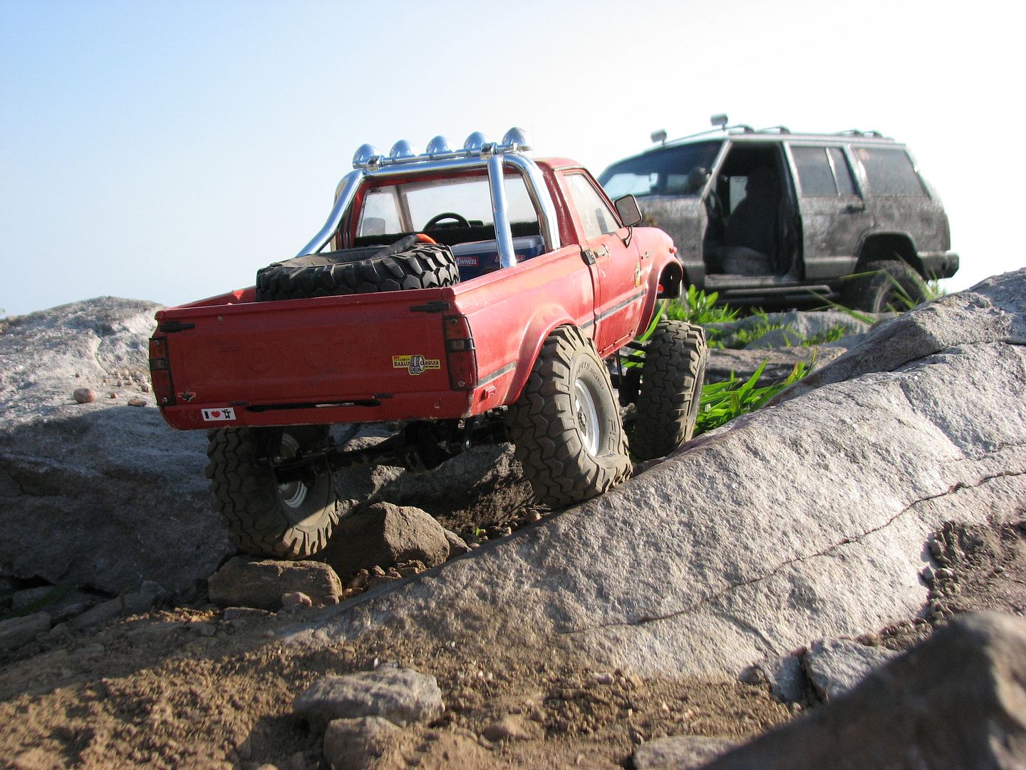

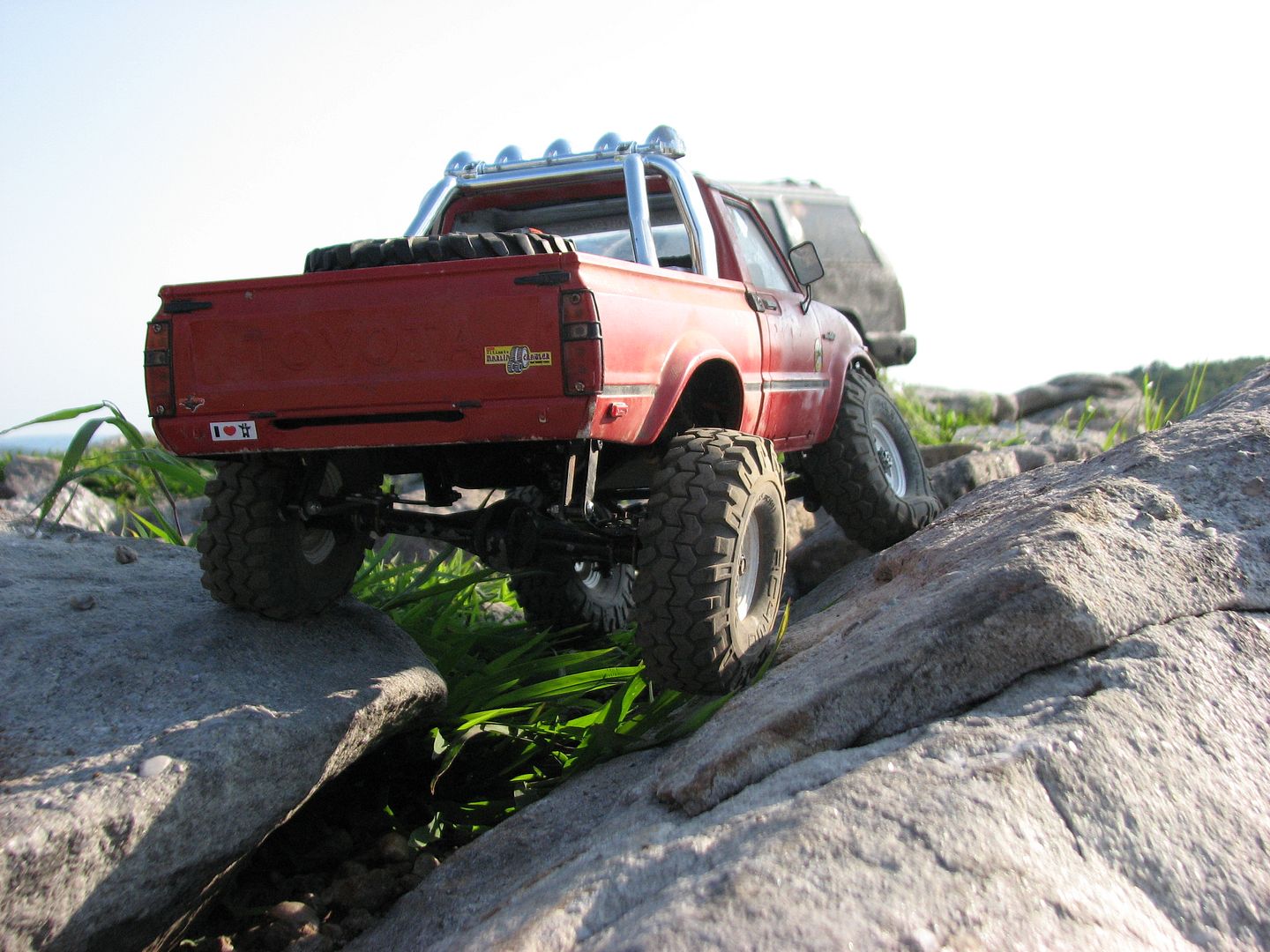

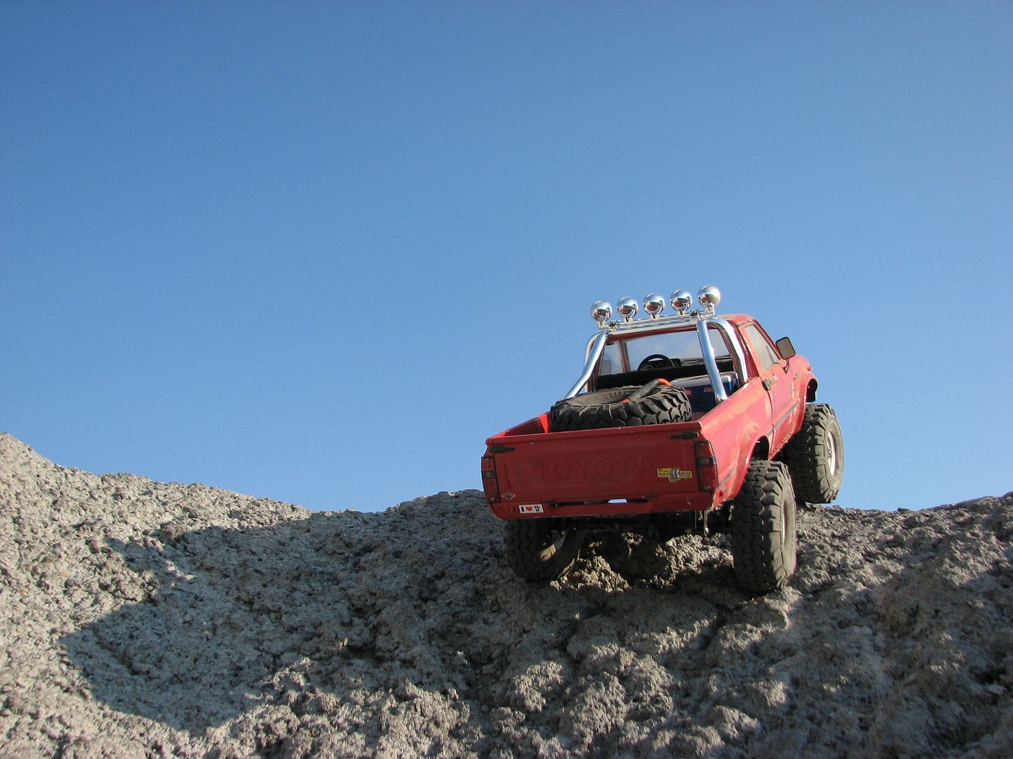

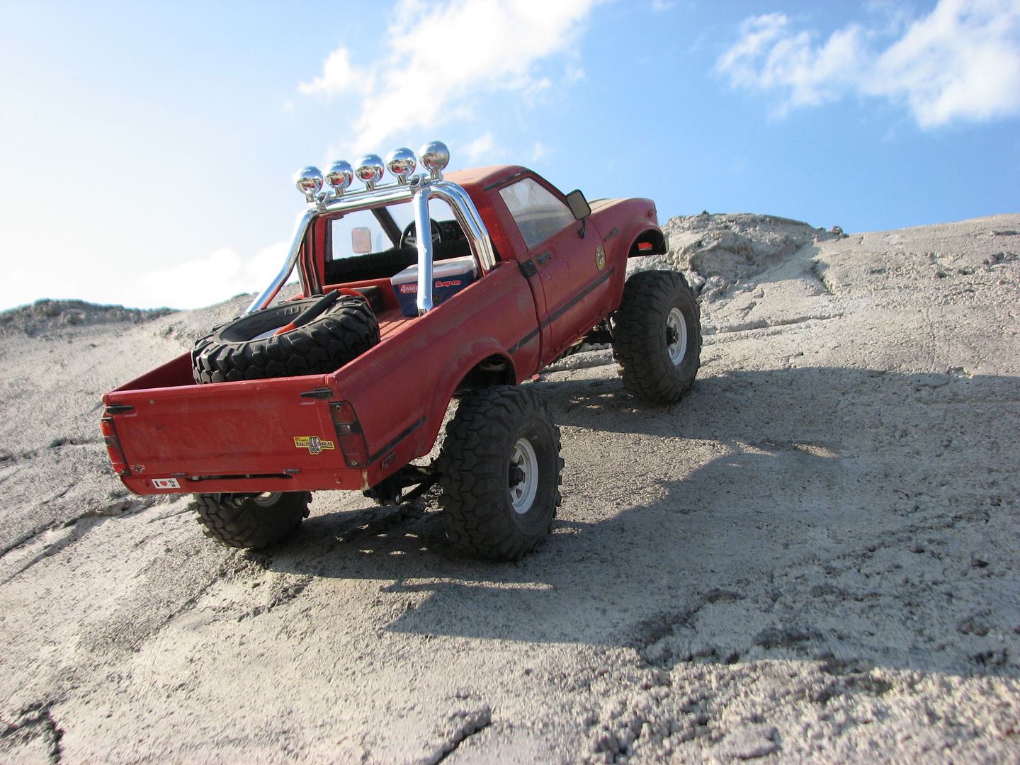

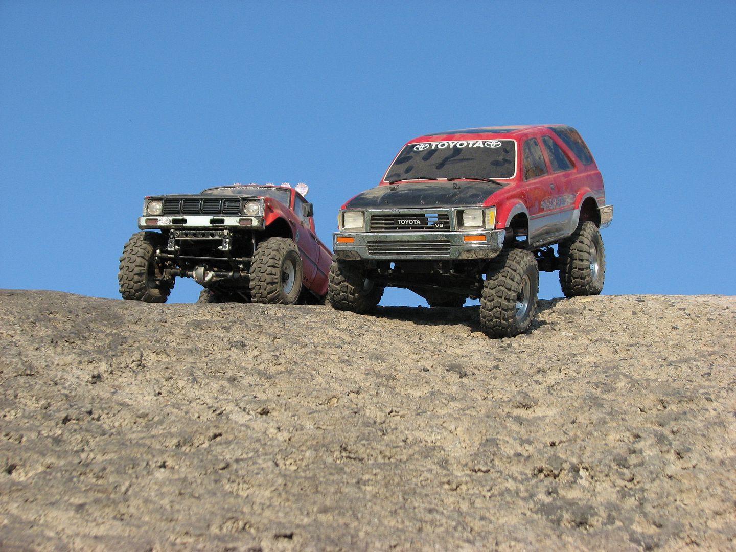

I will post updated shots tonight of this rig"thumbsup" I took it with me to Raush Creak this weekend and was doing working on the comp course with it :twisted:
It doesnt have rear shocks simply because I havent had time to make or fit any to it :ror:
and the knuckles are supposedly GPM ones off of ebay
Great pics, gotta love the flex! Do you run any weight in the wheels to help keep them planted?
Matt had the wheel weighted when I got it and they also have relief cut in the center to allow them to breathe. The truck climbs some knarly lines and the 3300 nimh battery pack is behind the trans :shock:

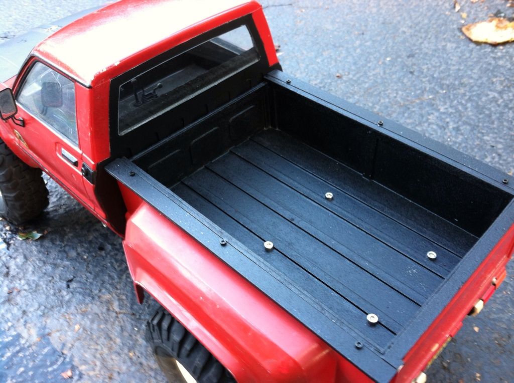

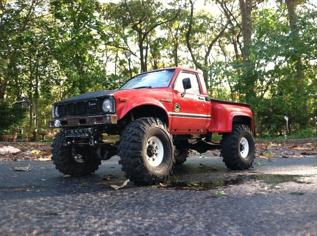

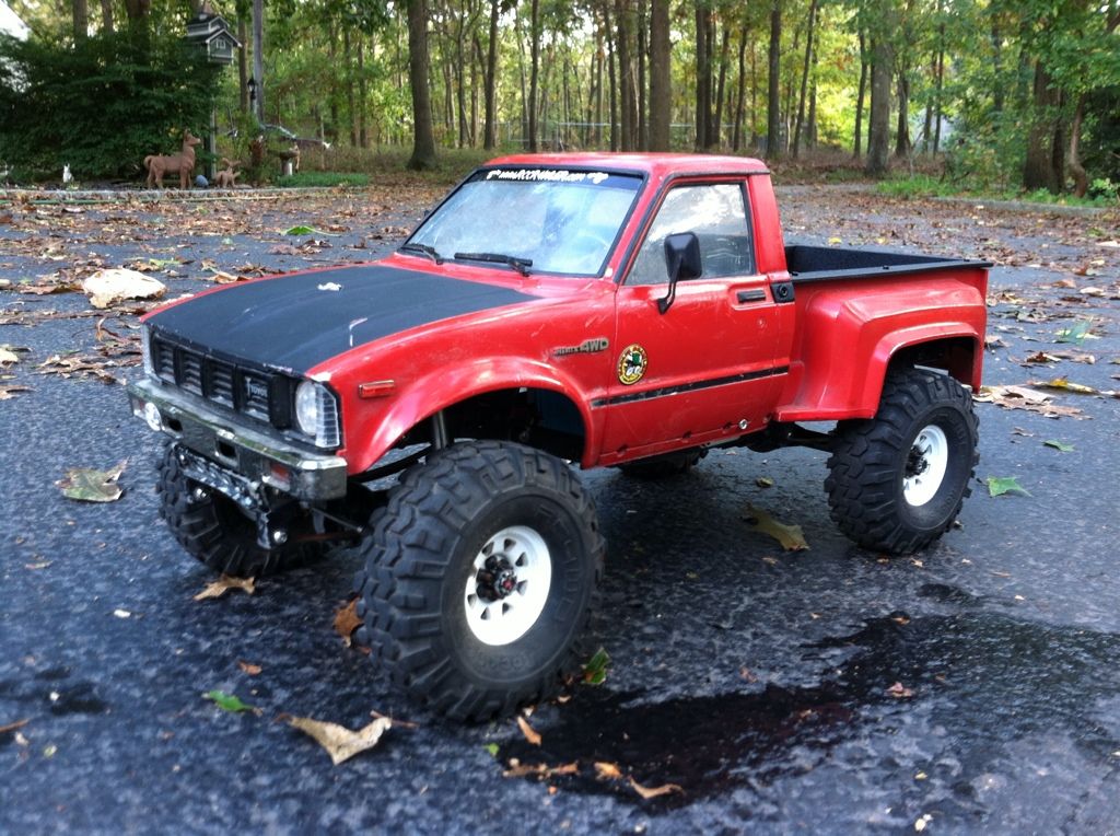

a week or so ago I put this rig up for sale...I spent a lot of money on my Subie this month and wanted to pad the bank account but there were no bites on it at all. I really love this truck, it works awesome, springs are settled in and it tire trucks like a champ :mrgreen: So since it didnt sell I decided I am going to part with my OG Hilux and keep this instead. I really didnt want to sell my OG lux because I had long sort after one to have the step side bed. I dont think is necessarily a fan favorite but I always thought it was cool. I then remembered I had picked up a bare bed from a member here some time ago that I was going to do a drop bed with it for my OG. Well, this bed was red, this truck is red so I decided to turn this thing into a step side. spent the last day or so working on it and I am pretty stoked with the results.
This drop bed is probably the easiest one to do...all you have to make is a box and you are more or less done. Out came the dremel, styrene, paper cutter, plastruct, a ruler, a pencil and Reign products cab back. Within a short period of time I ended up with this
while letting it cure I recently received some goodies from my buddy MThead...This is often missing from by builds because I cant justify buying an entire decal sheet from Tamiya just to get the grill emblem. These are nothing short of pure awesomeness
The bed, like most OG Hiluxs I have come across, was missing the bed rails so I picked up some half moon styrene and cut 2 strips. I then coated it with some bed liner, and sprayed the cab back black which I think looks cool.
End result
I tossed a new servo in it as the other one was hurting so this rig is ready for the trails again :mrgreen:
