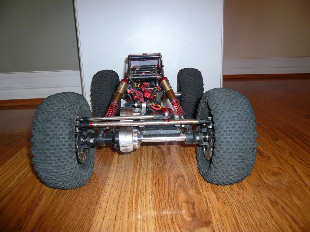

Well, I took my new foams out for a spin today.
My setup.....very well worn boss claws (only modifications are every third lugs have been cut) filled with CI 5.5" foams (Front: soft outer, narrow closed cell inner; Rear: soft outer, wide closed cell inner):
I am liking this setup! "thumbsup"
These foams were pulling lines that my old (softer) setup struggled with. I noticed a LOT less bounce when I was having to use momentum to get up climbs with undercuts as well as on vertical climbs.
I did find it more difficult to mount the tires than before, but I found that the easiest way is the put the outer inside the tire first, then mount the inner to the wheel (line up the breather holes) then stuff the whole inner/wheel combo into the tire and bolt up the rings.

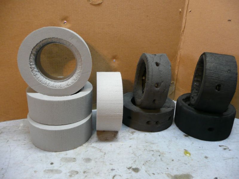

My question is what are you guys doing about venting? My rims have a drilled vent hole but the closed foam inners don't allow it breath,,,,I'm not a big fan of punching a hole in my tire.
Just wondering what everyone is doing?
Thanks

Vent the wheel and vent the foam.
pictures here of some original prototypes on the right, vented with 1/4" drill bit.
Production inners on left were not vented but are now, like the ones one the right.
My wheels are vented too and just like Shane, I marked the location of my vent hole on the foam and drilled a 1/4" hole in the inner foam. You need to be careful when drilling the foam as the bit tends to wander. Make sure to line up the holes in the foam with the holes in the rim.

Ive got some of the new inners in my deep freeze right now, will try drilling them with a good sharp bit tonight and let you guys know whether freezing helped. Trying to keep the foams from being so grabby when we vent them.
Re: New... 2.2 and 1.9 dual stage foams
Just use a sharp bit with high speed (you said that). I had no issues on any of the prototypes or production inners.
It can grab a little if you use slow drill speed or get the bit at an angle.

You holes look pretty wallowed. :mrgreen:
Just like TC's when he did them over here.
