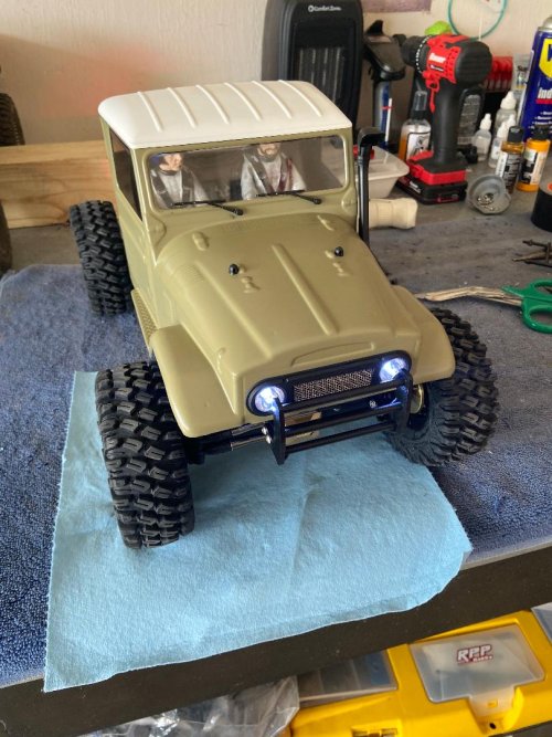

Ok, any expert painters have recommendations on how to best paint the "rubber seals" around windows on a body? I've got a new J45 body I've been working on and they're rather pronounced. Doesn't seem right to leave them body color, but I don't wanna screw them up either. I thought about a paint marker, but in my experience, they tend to load up, then bleed like crazy out of nowhere.
If I had a steadier hand, I'd consider detail brushing by hand, but I don't so I won't!:lmao:
The body kit came with decals for the trim, but decals always look hokey as heck to me.
My last option would be to mask then spray, but that's gonna be beyond tedious.
Anyway, just wondering if someone has a "tried and true" go-to move for doing these. Thanks!

Usually, I would've cut the protective film in a way to leave the trim exposed for paint if I painted the body from the inside.
Since I think you painted from the outside...
I just use masking tape over the windows and the rest of the body (If you don't want to use up so much masking tape, just get a plastic bag and tape it off in a way to protect most of the body from getting overspray.
Use an exacto knife to cut out the trim from the masking tape.
Paint with black and then flat clear.
EDIT: Highlighted the part that will save you some trouble since you were saying it would be tedious to mask the body.
Paint pen. I haven't used one, but I saw them at the craft store and thought it would work well for window trim.
Bleeding sucks.
I usually do them on the outside by cutting film as mentioned. Tape is time consuming, so I use liquid mask. Bob Dively was my go to but he’s gone so Bitty Design has some.
Use a wide cheap brush for 3 coats let dry overnight. When dry and clear cut out what you want, remove and then brush paint. I use Proline WB lexan paint then seal with PS55.

Awesome guys - appreciate the feedback. Considering the options, I think liquid mask per Mike's suggestion is what I'm gonna try.
Mike - I'm wondering how the liquid mask might interact with the exterior paint since it's not PC/lexan specific? Any thoughts or prior experience? Worst case, I'll shoot some on scrap lexan and do a test I guess.

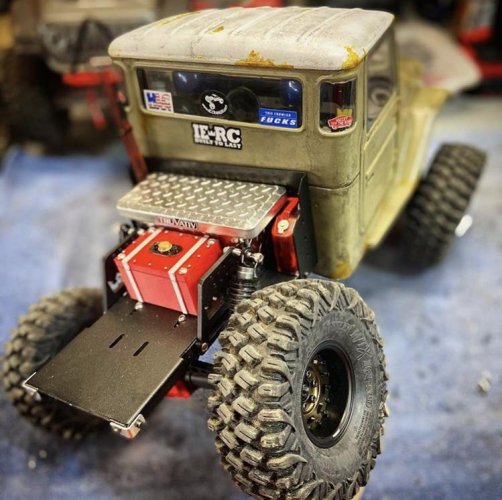

Awesome info guys. Thanks! Here's a few more pics of the weathering / patina so far. Still need to do some of the details like the hood latches, and window trim, but really liking the look so far.

Coming along great Walsh! Nice work on the weathering.
Thanks Bro! Got an initial shake down in and I think she gonna be a runner. "thumbsup"
I went ahead and ordered a PL P-Wagon molded black body for it as well. Wanted a body I could thrash and trash in the rocks without cringing.:lmao:
