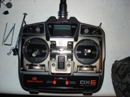

DX6 Radio

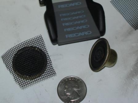

Found my 3/4" Speakers so I can have TOONS when Crawling 8)
I'll plug these into my IPOD shuffle under the hood .

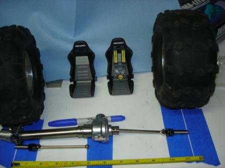

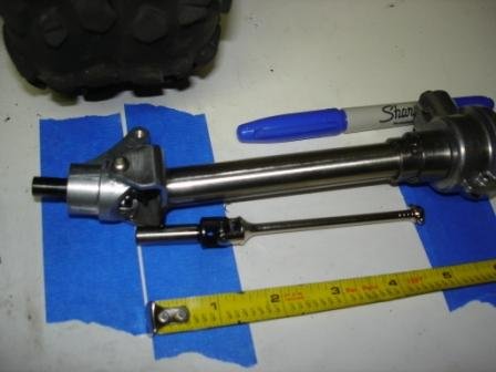

So here's the 5" hyper 8 Shafts
This puts the Outside wheel stance at 14.5"
Center of wheels at 12.5
Is this to narrow, What do you think ?:?:

Can you give us some info on the speakers? How are you going to wire them into a headphone jack? And where did you get them?

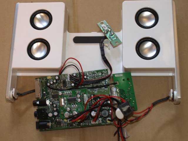

EDIT JUNE 2009, I used Altec Lansing Apple IPOD speaker system
Speakers from an old friend, no idea where they came from. But they have those Rc rappin trucks at Toy r us with the big wheels and radio, so you could part it out. If they Do not sound good then I'll buy Ipod portable speakers :)

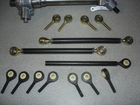

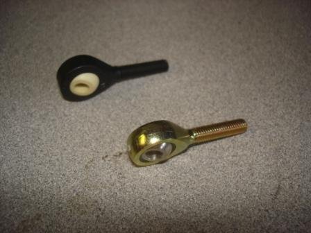

Just bought These Bad boy Rod Ends "thumbsup"
Steel for the lowers and the light thermoplastic for the uppers
MSC http://www1.mscdirect.com/CGI/NNSRIT?PMPXNO=4549458&PMT4NO=0 and will have some by tomarrow others by monday
I'll post my feedback when I get them
3/16
10/32 thread is 3/4 long
outside diameter 5/8
1" 9/16 total long
steel Rod End zink plated $4.36 static load 1200
the black one is thermoplastic self aligning $2.86 static load capacity 225
These will most likely not break if it takes a tumble 8)
Now I just need to finalize on some strong links, any suggestions??
maybe 3/8 delrin for the uppers

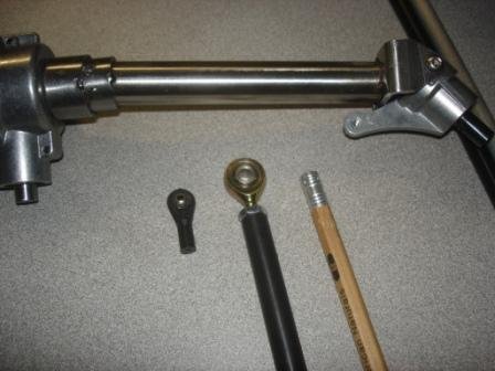

Sneak picture :lol:
I happend to have a 3/8 Delrin link handy, size is good, but this Delrin seems to flex, so I have some testing to do
2nd Pic is comparison to my current max 1/4 links and stock rod ends
