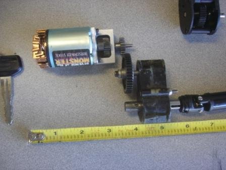

Using a MIP tranns with 44 Spur to a ****er box in a GD600 to a drive shaft to a reduction unit to the Motor

emaxx tranny..
Quote" emaxx tranyy"
Yea but it's so freakin Big !
Got a Great Idea :idea::-P
I may do this setup and build a shifting case to use a Servo to engage the GD600 , basically engage a 2nd Reduction Unit :idea:

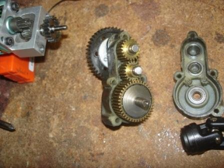

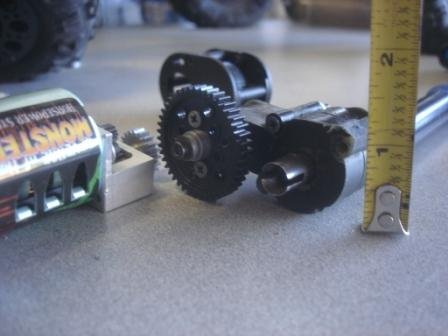

This tranny size is very small and the shape is very simaliar to the Real Thing :)
It also has BRASS Gears ! Don't see them breakin :) LOL:lol:
the belly of the tranns (out put shafts) will sit on pan along with all the motor etc.
ALSO this tranny allows the front wheels to turn even if the Rear wheels get stuck and stop, and Visa Versa. Unlike most trannys the slipper Slips and NO power goes to any Wheels :!:

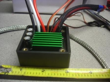

Mamba max from Crawler Store, wow this ESC is Sweet !

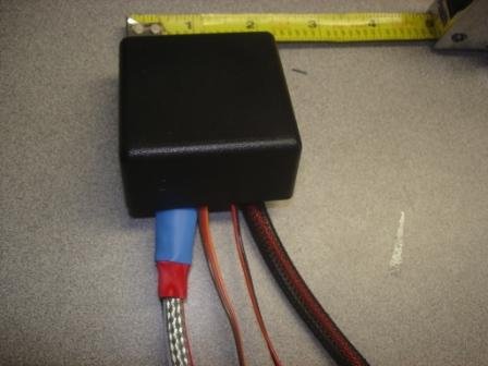

Found this Awesome little box that looks just like a fuel cell (texture) and still fit a Fan inside
gonna dress it up, make the wires look like High pressure lines "thumbsup"
attachment.php
Box is 2 1/4 square by about 1" tall
Where can I get a Fuel cell inlet Sticker :?: anybody?

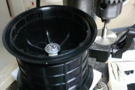

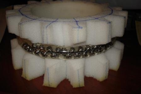

Narrowing wheels and adding hex bolt beadlocks
ball bearings inside for weight
attachment.php

Look into the T/E Maxx Jaws sticker sheet. It's fuel door sticker looks kind of like a fuel cell filler and it gives you a couple choices too.:?: It's worth a look I think.
thanks Trikster

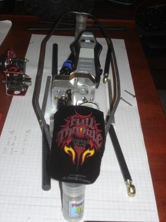

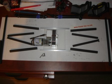

little progress here,
have all my 4-40, 6-32, 8-32, 10-32 and so on HEX Head screws to keep the bolts Scale looking
Still Undecided on Tranny, the RC4wd tranny in the way of the seat and Not feeling good on strength
quicky mock up

I don't know if you ever came up with a way of attaching the axle tube to the diff but I wash thinking of doing the same thing but never got around to building it. This was my idea, use 2 large washers and weld the axle tubes to them. Then sandwich the diff between the washers with bolts or large machine screws. this would allow you to get the diffs apart if needed and you could rotate the diff to get that perfect pinion angle"thumbsup"
Yea that's the common way, I'm actually doing that to my maxx Right now LOL:lol: , I don't care much about it, it's just something to play with while I'm building my Real crawler :)
For my New Super I like different/ innovative and (Clean)
so I have not finalized on it yet. still using my custom maxx as a practice template as I continue to research, find parts and work on the Design.
