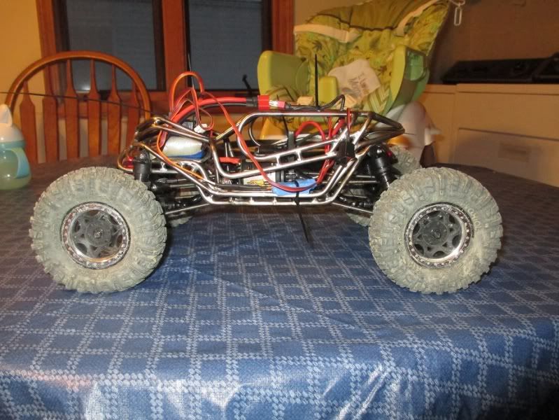

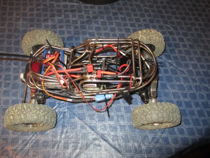

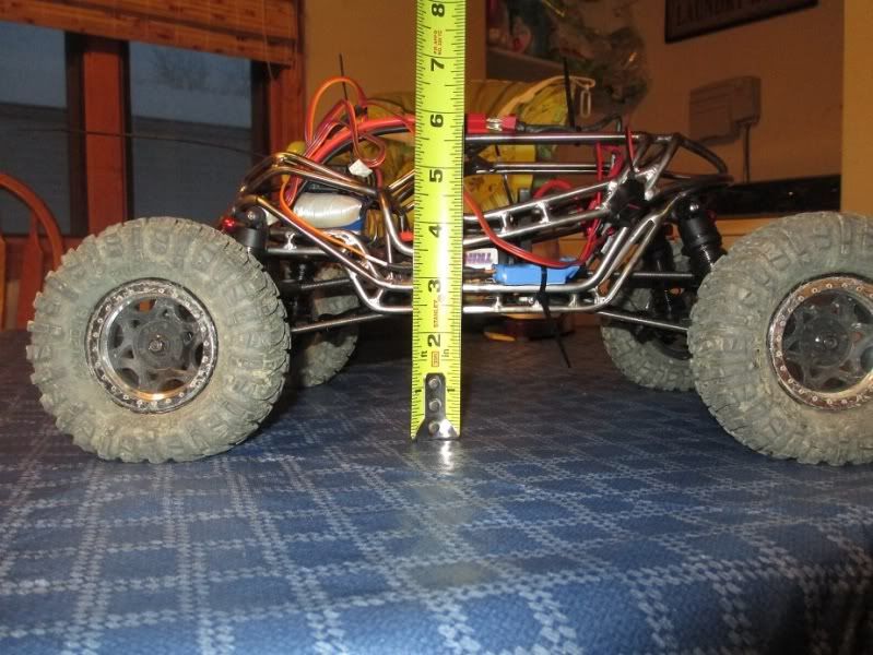

i put my honcho tires and wheels on it and got some pics, don't mind the wires obviously they will get tied back better at final assembly. :lmao:
not much flex, who needs flex when you got bounce. right?

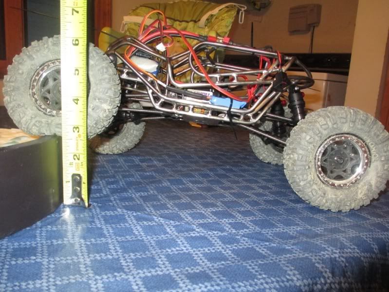

ground clearance

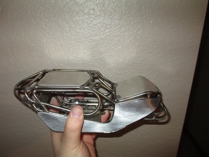

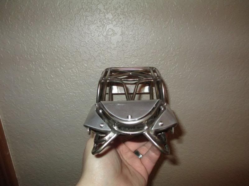

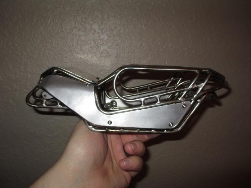

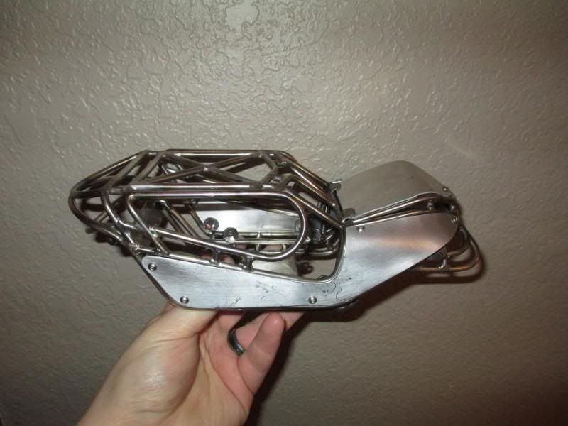

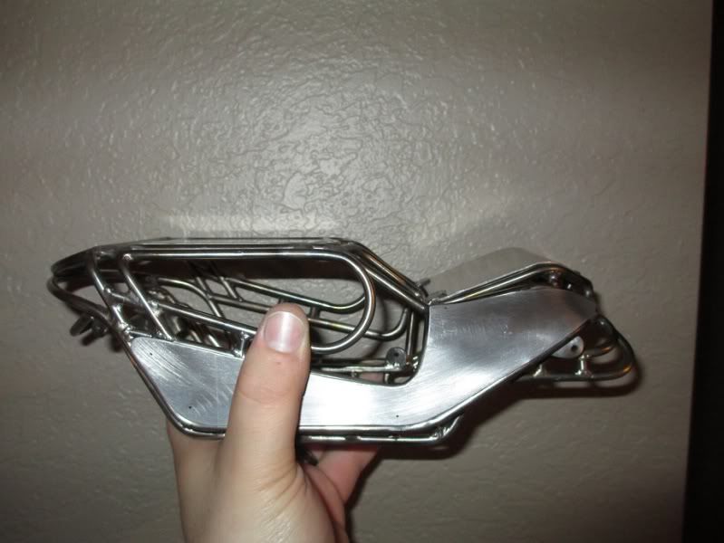

i have started on the body panels. have to admit probably the hardest part of the build so far. the side panels are a huge PITA trying to get them in one piece, but i have one side done already. once i get the other side done i will get mounting tabs welded on then it's time for powder coat and final assembly.
i have my body panels all finished up. they're not all mounted yet but here's what they look like.
