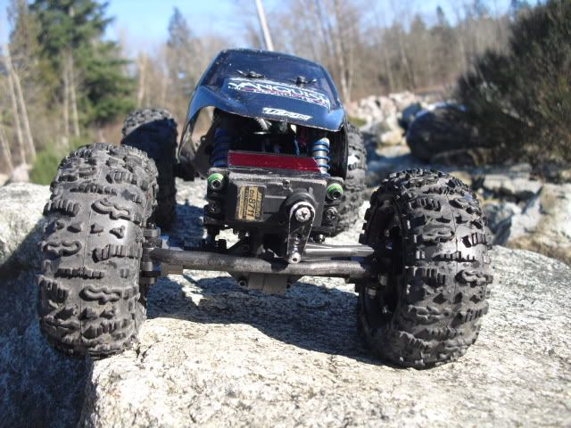

Well, it's been a while now...
I got the crawler together a while back, sent the 5245 and 13.5T back and received a 645mg and 18.5T Novak System. I've got 3.4 OZ added to the front wheels (lead fishing weight wrapped around the rim twice is 2 OZ, one wrap around the inner beadlock ring is 1.4 OZ), 1.4 OZ to the rears.
I'm running my shocks inverted with the outboard spacer kit, a single hole piston in the left rear shock with 40w, 2-hole right rear with 35w, and 3 holes in the fronts with 35w, pen springs below the pistons, and stock MRC chrome springs all around on the outside of the shocks, and no droop limiters other than the springs. With the shock mount arms in the lowest position it limits compression travel while the pen springs control and stop droop.
Seems to work well. Stock articulation was almost 90 degrees, now it's at around 50-55.
Works well thus far, but I already want more.
Servo could use more power (bigger servo and BEC planned), motor has awesome torque, drag break is sufficient one setting below max, and no cogging that I've noticed. But...
It lacks anything resembling wheel speed for those climbs where you just gotta goose er! I think I'm gonna step up to 3s soon anyway beings my tire got ahold of the edge of my Losi Lipos and chewed them to shit.
Maybe a motor upgrade is coming in the future?
Maybe I should've stuck with the 13.5T?
