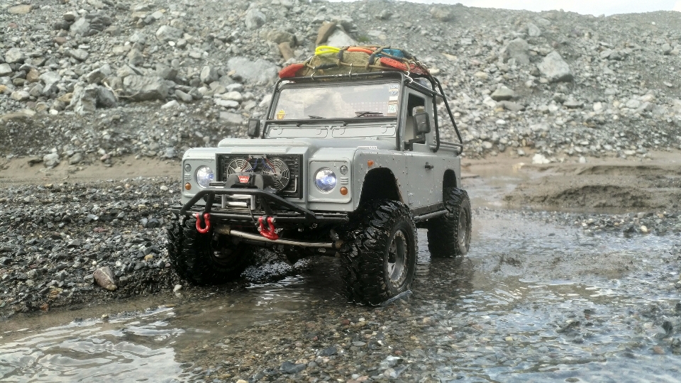

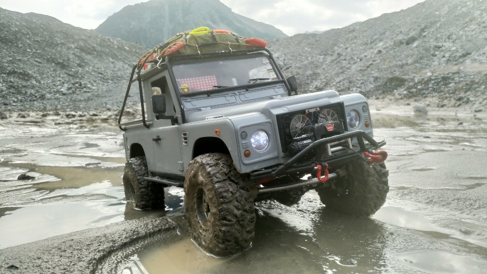

Received my Milestar Patagonia tires in size 4.7". Tested in granitic soil/Pine needle organics, and polished granitic river rocks and boulders. In these conditions stock compound tires struggle a bit getting traction. These rocks are the slipperiest I've encountered in UT.
Foams: Ottsix Halo Foams
Test vehicle is a SCX10.1 with a Hobbywing Fusion AXE system.
Prior tire experience includes Ottsix KLR Blue compound, Proline Flatirons and BFG KX in G8 compound, and Axial R35 compound.
TEST
Roots and tree bark: Climbed large roots with ease at least as good as the Prolines.
Rounded River rock and boulders: Drove up dry areas of creek bed over varied sized rocks. Traction was not an issue. Wet tires did not significantly affect performance.

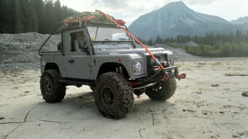

Sandy soils: Tires climbed out of the riverbed up steep embankments tires clawed through steep climbs and was only stopped when roots or significant vertical steps encountered.

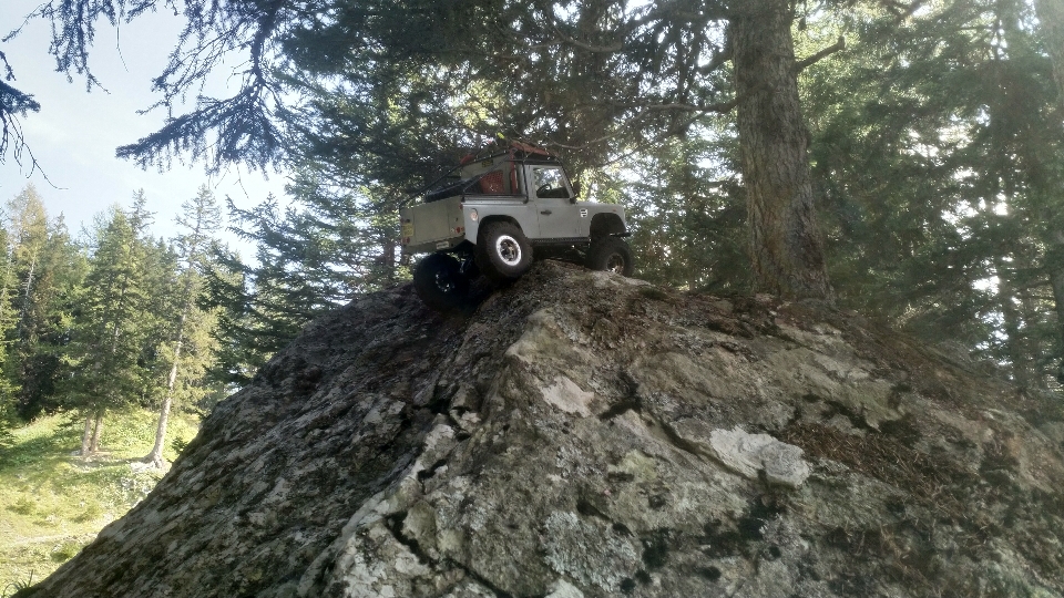

Rocky climb with step: We have a tough obstacle climbing a series of uneven rocks to a boulder step. Most rigs are stopped at the step unless set up well. My 10.2 has more success than my 10.1 due to F/R weight distribution from brass knuckles. The 10.1 has made it with the FlatIrons but it can take many tries. The Patagonias Made it on the third try. Once the line was right the tires gripped and the step was climbed without a slip.
Flat polished rock: Many tires just spin on this. The FlatIrons need a bump to climb but do it well. The KXs are similar (G8). The RC4WD S3 compound stuck to the rock. Still needed a bump up top to avoid a high center but not the tires fault.
Tree climb: Run up an angled tree. Here I struggled a bit more than the Prolines only because the Patagonias are a tiny bit shorter and my 10.1 has bigger diffs in the way. Nothing against the tire but needed mentioning. All log runs needed more finesse because of the lower clearance.
Overall: I still like both the KX and Flatiron Prolines but the Patagonias are so scale and performed as well or better in most tests. Overall the RC4WD S3 compound seems like a winner and on par with the best out there. Likely better than Proline G8 in all but the hottest of weather. The Patagonias never clogged with wet soil but haven't tried anything thick and goopy. Tires didn't seem to show any wear. I say buy them, they are keepers. Will update when other conditions arise. Winter testing will be fun.
