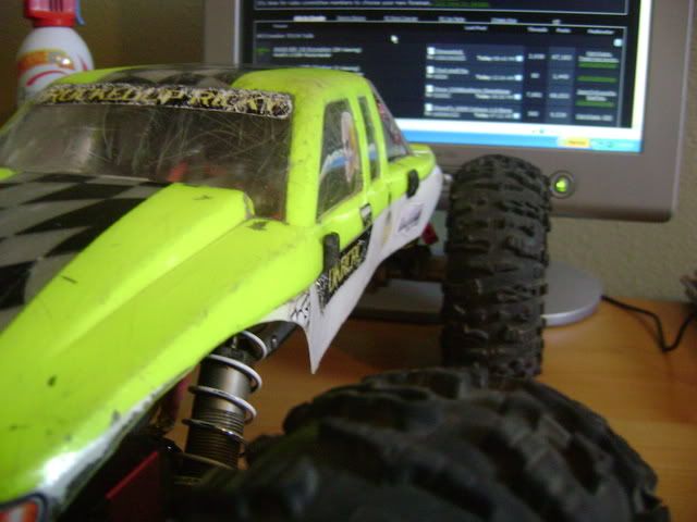

I like them. They work great on this high grip rock. I'll have to go to my slick rock spot soon. With the stock foams they impressed me, and the size is nice for the gaps and holes. They'll still wrinkle up like the Panthers, but the stock foam pops it right back. They side hill pretty good and if they do fold, they seem to fold out instead of under the wheel. The little ribs inside the tire push it out I guess. "thumbsup" these tires really add to my AKRCC DEIMOS CHASSIS. My rig has never been as good as it is right now. I am a happy camper.

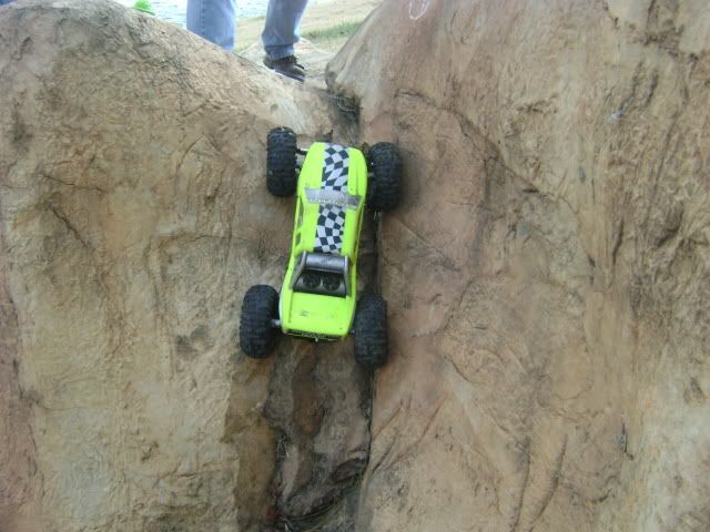

I'm loven this rig, at the comp this weekend there was 3 courses and 27 gates. I pulled off a -27 for the day.

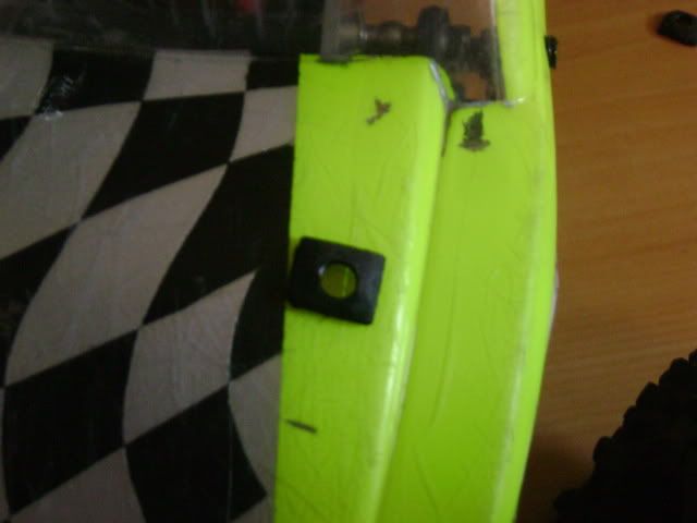

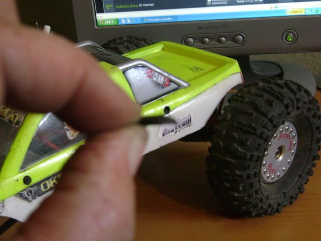

Check out my body nuts. I guess thats what you'd call them. See those little black squares, thats where my body pins use to be. I got tired of them popping off and hanging up on the rocks. So I threaded the bodypost and made these thin rounded off body nuts out of derlin . They haven't fell off yet and they don't get hung up on the rocks.

they're just plain old body post that I threaded.
