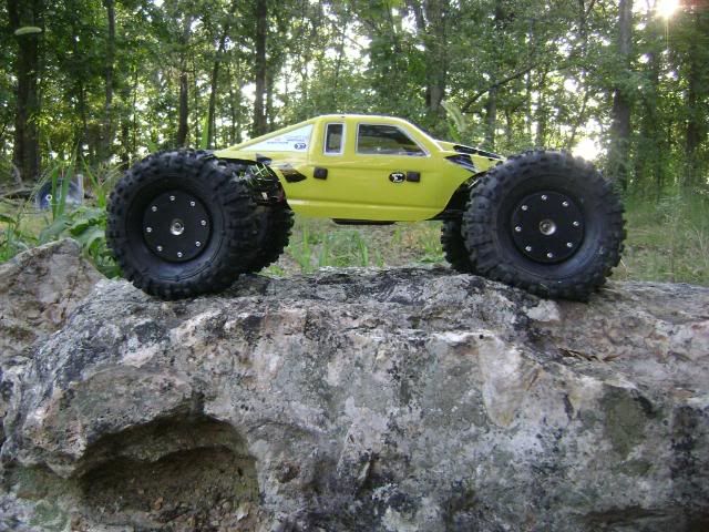

Been do a little to the rig. I picked up a set of Mayhem ultimate wheels.
I ran mine at a comp this last weekend and I love them. I ran a soft memory foam in the front and a stock rover in the back. Cut a notch in both, that was easy with a worn down wheel that had about a 1/2 of cut left.

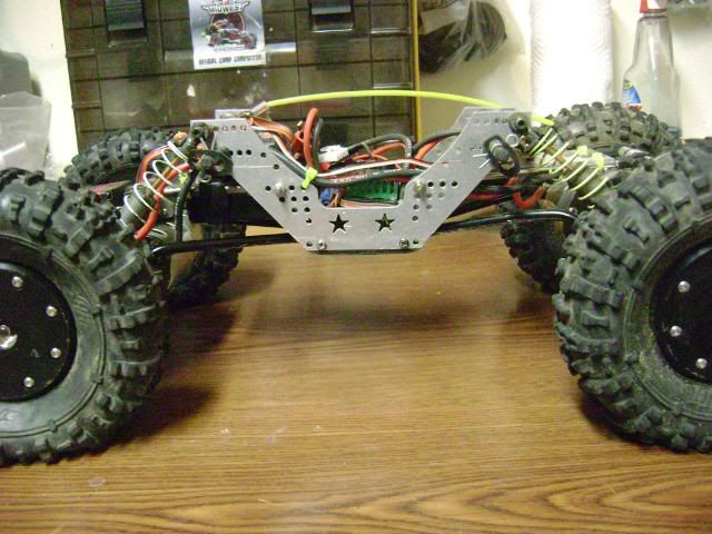

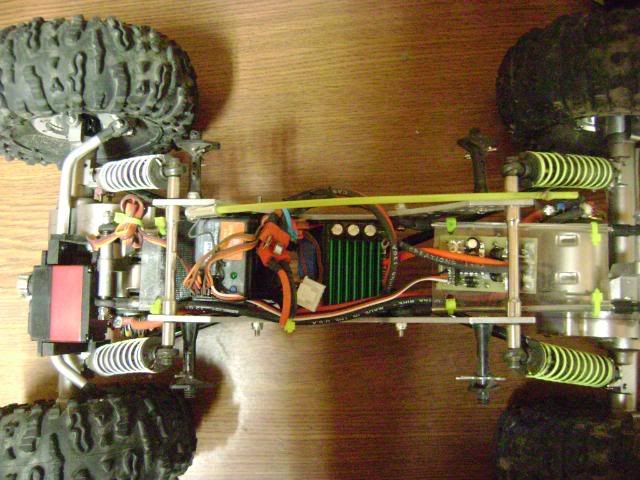

In talking with Just Zack, I ran the 1/2 ring in the front with weight on it to get the weight I like, I'm actually running a little more weight than I usally do in the front, I'm running just the ring in the back, Moved my battery off the back axle to my upper links. These thing rock, I got in and out of holes that I shouldn't of any other time. I had a larger foot print on the rocks. They would wade a little just like I like but not to much.
When I tried them on my rock pile at the house ,I did stuff on my practis course that I never could do before and I try some of those lines all the time.
I can't say enough about these wheels, I'm glad I got a set. Best thing to happen to the wheel sence the wheel.

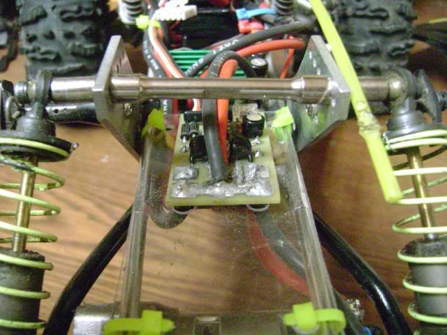

I won a punk dig switch and installed it, redid all my electronics. With the weight from the new wheels in the rear, I moved my battery under my front links.
With the punk dig switch it cleaned up my wiring a lot and I think a little berg stall is gone from the shorter wires from the dig switch to the rear motor.
All in all everything is a little lower now. With the new CG and the killer wheels my rig is feeling really good right now.

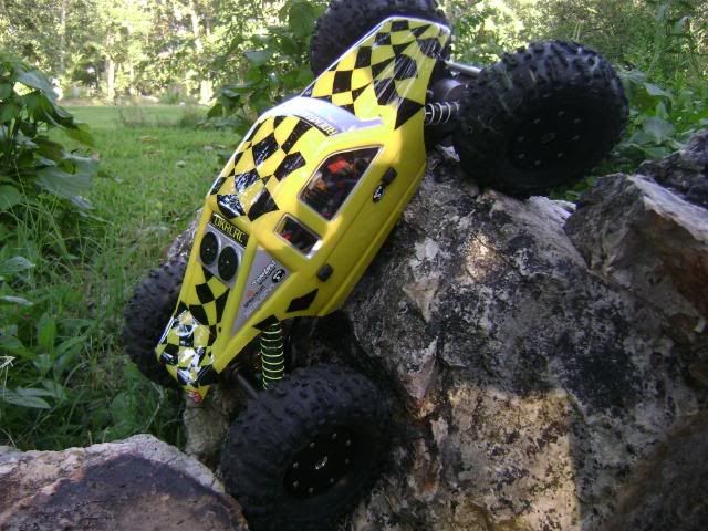

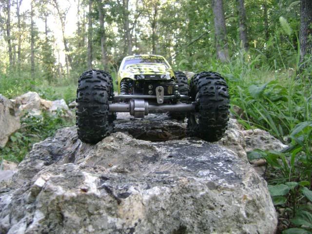

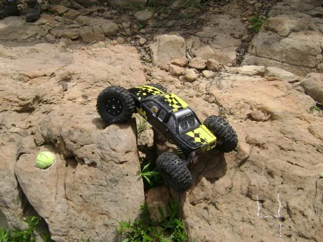

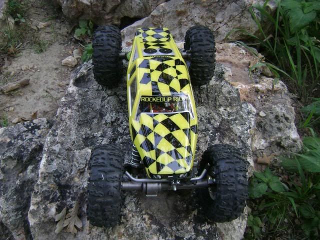

Here's some pic from my last comp.
Got another win at the NWARC comp. bbyrd gave me a good run, we tied on the total and I got him with the tie breaker.
I really liking these mayhem wheels. I got just the 5/8 ring on front,no weight and it at about 15oz a wheel,tire and foam. I put the 5/8 ring in the back ,but didn't like that much weight, but liked the 5/8 ring better than the 1/2 ring. So I drilled out the 5/8 ring and it's the same weight as the 1/2 now. It seems to be working for me. I'm running a soft memory in the front and a fairly soft non memory in the rear. This is feeling really good to me right now.
I got me a Losi comp body and mounted it up. It weights .75oz less than my old body after I painted it. That should help my CG a little too.
