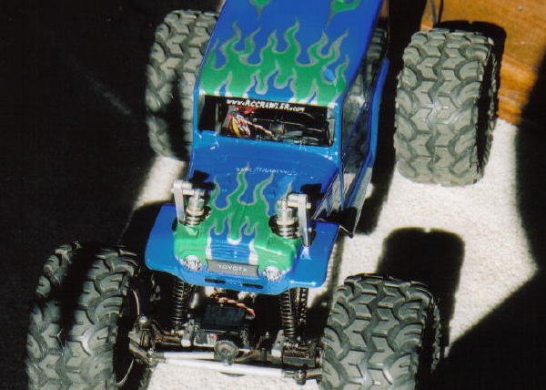

hey, saw the savage shocks and they look pretty nice on there. ive heard some people say they didnt like the savage shocks for a few different reasons, one being that they leak, do you know why this is? and would you recomend savage shocks on other crawlers?
Stock Savage shocks leak a lot from what I've read, mine are made by Hot Bodies for the Savage. I use teflon tape on the caps, they leak a little but it's not bad.
I'd recommend them if you like to play around with suspension set-ups. It took me a little while to dial this chassis in. The key to running looooong shocks is mount the upper mounts as high as you can on the chassis. IMO.

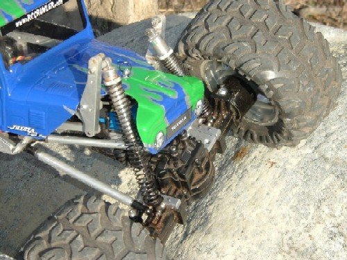

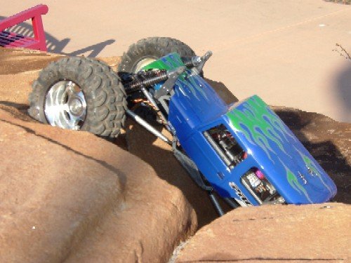

I couldn't help myself, the hacking has begun!!! I threw in a couple pics of me climbing my "stairs", just to give Super Digler a little preview. ;-)

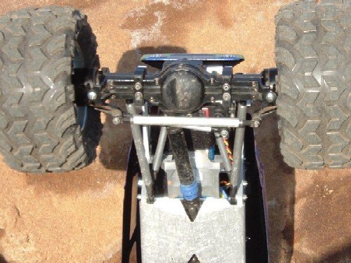

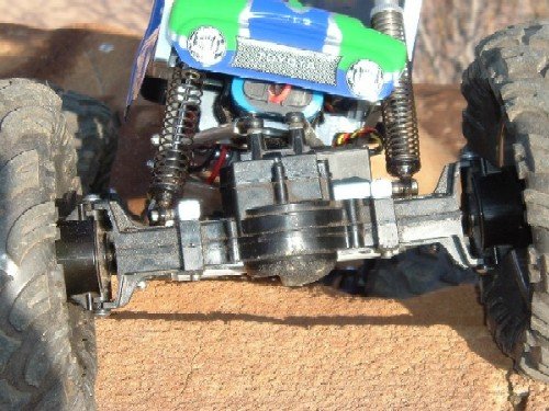

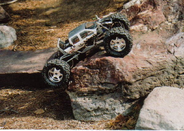

I decided to try setting up my front steer behind the axle. I gave it a test run today, definitely alot better approach angle. I need to tweak the tie rods a little, but all in all I'm happy so far.
Some pics....

hey bender!!!
i was just looking in your roctapus thread. i like the way you setup your behind the axle steering on it. is there anyway you can post some more pictures of it. i am trying to set mine up and i am having a really hard time. this would help me out alot, get the ideas flowing. thanks man and awsome rig!!! :)

If I had a digital camera I would, and pretty much all the pics I have are posted in that thread. I'll borrow my buddies camera and try to post some up shortly.

i also forgot. how is that working out for you. the behind the axle steering. any complaints???
No complaints at all, my approach angle it so much better now. Once in a while it hangs up while I'm in reverse, but it's not to bad.

The tires in the begining are GT's on StableMaxx rims, I machined custom adapters to bolt them up. They work great on these rims and there is no need to narrow the rims.
Behind the axle steering is about 1/2 way down this page. I'm working on better pics.
http://www.rccrawler.com/forum/showthread.php?t=8701&page=13&pp=10
