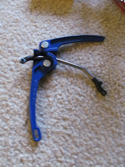

Bumped in to tie rod problem. Will have to bend it and extend it. Any suggestions for low cost/no cost fix?

I had Wraith steering rod ends and 106 mm SCX10 steering link. To bend it I picked Pittsburgh tubing bender (94571). Very nice tool for 10$. Unlike other benders I saw in stores this one allows you to bend short tubes.
Extended drag link with spacers and put it together.
Not the best bending job, but it works)
